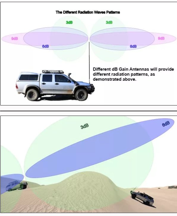

    That's not how gain works.

    @jlemmond from Ronny Dahls website, "3dB works better in hill terrain and sand dunes, 6dB and higher gain works better on the flat landscape. The idea is when 4 wheeling in hilly country or sand dunes switch to the 3dB antenna and when on the highway use the 6dB for better coverage."
    Thats why I have a 3 and a 2.5

    Just figured a 6db gain antenna would be better than an antenna without any gain. Thats about as far as my thought process went if you want me to be honest.

    Gotcha, yeah its kind of confusing but that graphic should explain it well. Basically a high gain is flatter and has longer range, but only when theres line of sight, lower is better offroad(which is really the only time I use mine). Prob makes sense to have a higher gain and a lower one though :thumbsup:
