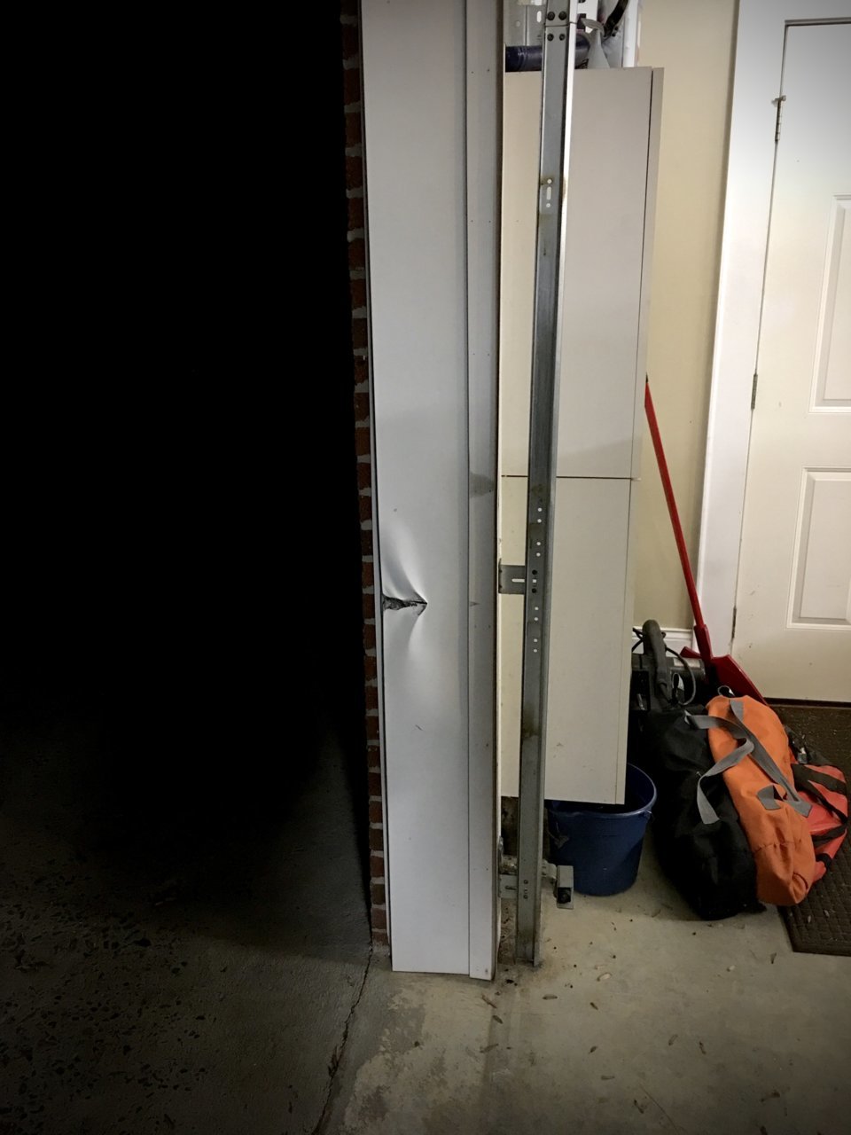

    flashing you say? Can you make me a new one of these?
    I may or may not have came in too hot one day.

    Easy peasy
