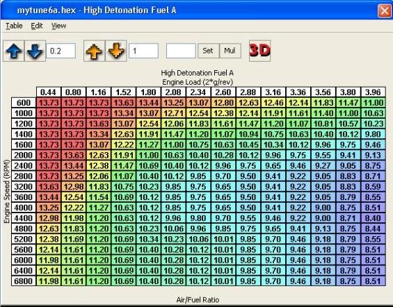

    I don't know if that is correct about throttle position on a drive by wire system but I dont know enough about it to dispute you. :rofl:Seems like RPM would be really the only factor determining gas consumption unless somehow the fuel-air ratio changes significantly changes when throttle is open but RPM is still low? And for me (manual) that would just be chugging the engine? Can you explain this better?

    low rpm with lots of throttle = dumping fuel
    I don’t have my laptop open to screenshot a stock Tacoma afr table but here is a quick example I can find

    Interesting. So that does change the Air to Fuel ratio? Now that I think about it, I guess it makes sense. the computer will constantly vary and optimize the air to fuel ratio depending on RPM and load.

    Yes it will change the afr depending on load and rpm.
