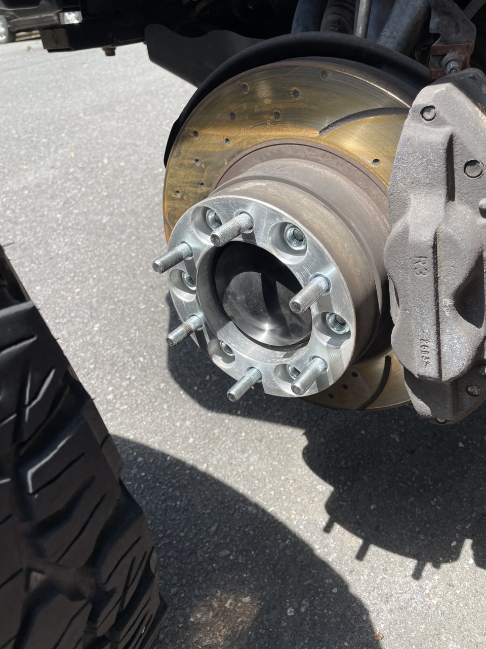

    Been a while. Hope everyone is going well!! Sweating my ass off right now trying to get these wheel spacers off from the previous owner. Anybody have experience with this or can recommend a shop that can help me out? I’m not sure how to get those bolt off inside the spacer / not sure if they even need to come off.

    6pt 19mm (or 21mm, can’t remember) deep socket should do the trick. Depending how much torque and loctite was applied when they were put on could mean they are gonna be a PITA to get loose.

    Not sure im understanding the question. Remove the nuts on the studs coming off of the hub and spacer comes off. It doesnt come off its likely seized to the hub(if hub centric). If its seized to the hub persuasion will be necessary

    Yeah those aren’t hub centric. I’d be quite worried about the lack of thread engagement on those nuts. :eek:
    Need to get those spacers off asap

    Yea thats what was throwing me. Looked like the nuts had already been backed off partially. I agree with @SearArtist .. need to get those death rings off ASAP

    that’s what I was think and I agree, need to come off.. So next question how the f do I take those nuts off without the wheel spinning? Impact driver??

    Impact is the easiest if you have something with the balls to spin them off or take a pry bar and place it between the studs and braced against the ground to keep the hub from rotating while you work at them with a breaker bar.

    Unless those are some special deep nuts there’s hardly any thread engagement, looks sketchy to me, wise to take those spacers off.

    You can also have somebody step on the brakes.

    Rear is easy just pull the ebrake.
    For the fronts I’d recommend an impact or a long breaker bar to wedge between the studs and the ground.
