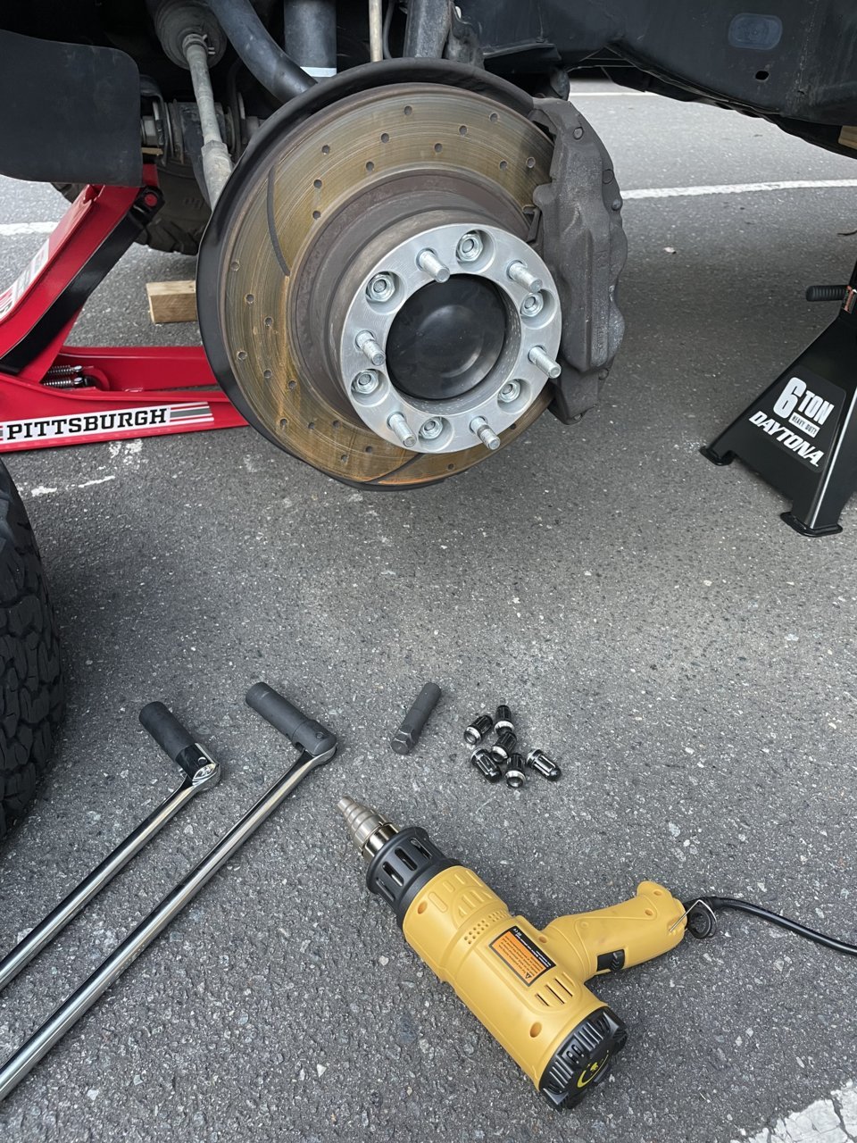

    For those helping me out with getting these spacers off. I ordered an impact gun, breaker bar, pry bar, and heat gun.. If the spacer is seized would y’all put a pry bar between it and the wheel hub?

    Dead blow hammer will pop out

    I’ve got a 1/2” impact gun and a dead blow. Could happily lend a hand if your not to far. What part of clt?

    No luck. Damn. Going to get some chlorinated break cleaner now. One YouTube video after another lol

    Put the breaker bar on them. Take your jack handle and put over the breaker bar for further leverage. It’s gonna snap something but hopefully it’s the nut breaking free.

    Blow torch. Can't be tight when it's liquid.

    Off! Extra level arm helped out. Appreciate the support boys. 1 down 3 to go

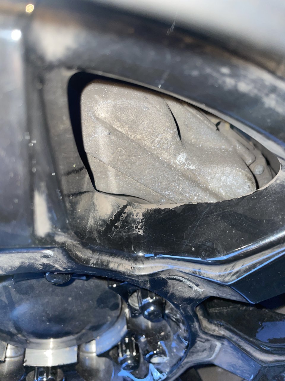

    Ok stupid question but I gotta ask. Tire gets really close to the break caliper. Is this ok?

    Ugh, that explains the spacer. Talk about a poor solution. Should be ok, but hard to tell by sight and no measurement. You will know for sure if you hear grinding

    Ideally you want at least 3-5mm space between the wheel and any of the brake components.

    265/75/r16. I think it alright
