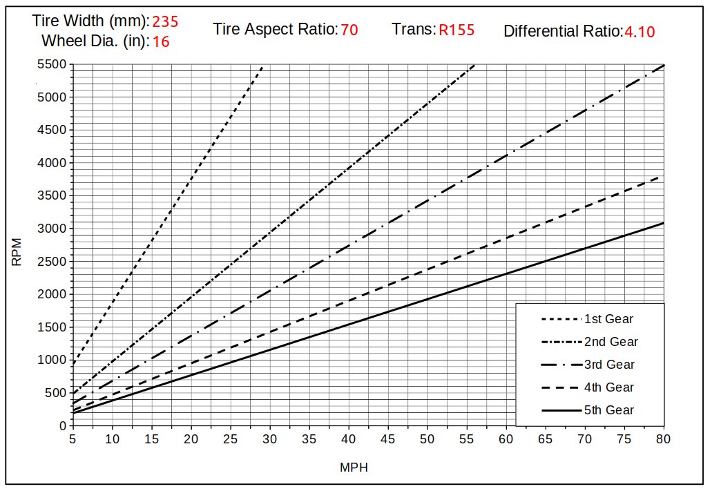

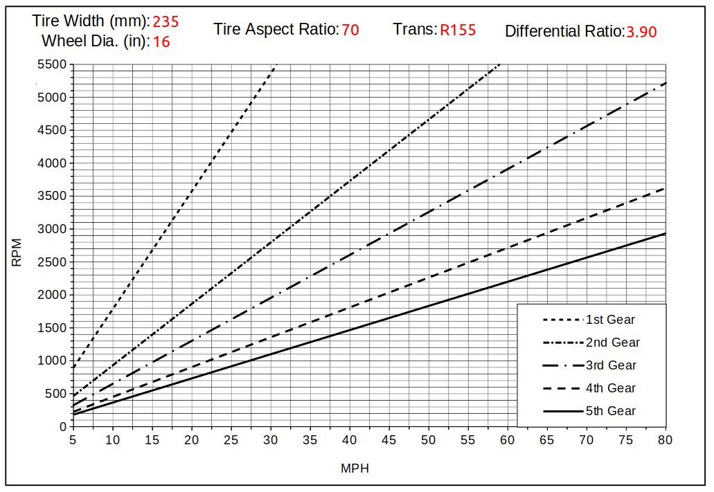

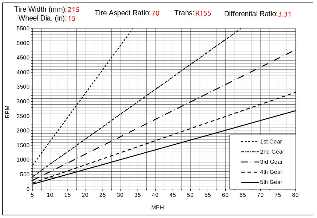

    I made the attached to help me on my nerdy quest to regear my lack luster 5-lug. Thought I would share as they may help somebody just starting their regear journey. I realize there are online calculators, but I like these because they helped me verify what I started with (driving around/easy to look at) and what I needed. For example, I know that on the highway, I don't mind <3000 RPM at cruising speed based on experimentation, and these print outs helped me compare and think about things. This helped me choose 4:10 instead of 3:90, at the same time I was verifying I started with 3:31.
    If anybody wants one for a different tire or differential ratio, I'll make it for them.
    Note that these are for the R155 transmission as noted in the titles.
