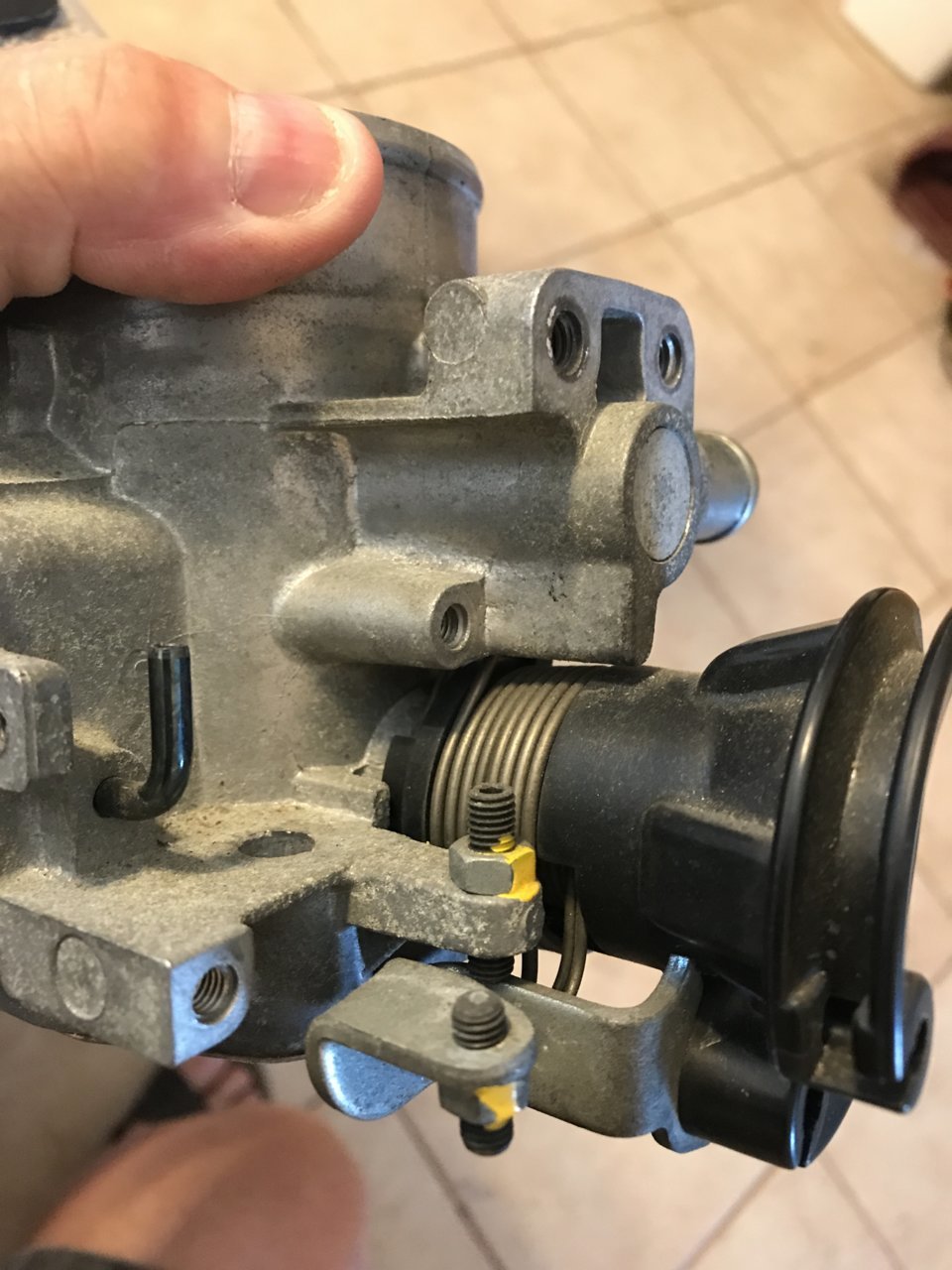

    the 4 cylinders are notorious for a rough idle especially when there is a load on them. I solved my issue by replace the throttle body on my 03 - 2.4 MT so I didn't get a chance to play with "things"... what I was going to do if replacing the TB didn't solve my problem was I was going to measure the TPS readings and loosen the base idle adjustment screw and see if I could get 75 rpms more w/o a change in the TPS reading... there is a little slop. While the TPS is not "adjustable" I see where I could elongate the screw hole slots for some additional tweaking. Should you have to do all of this, hell no, but Toyota wasn't expecting these trucks to be on the road for decades so tweaks have to be introduced... not everyone wants to put a $300 + TB on a 20 year old truck. Will this work... I dont know why not, they only caveat I can think of is if the base idle is too high the PCM will try to adjust the idle by altering the IAC dwell and if the PCM isnt getting the feedback that it is expecting, that just might trip a code.
