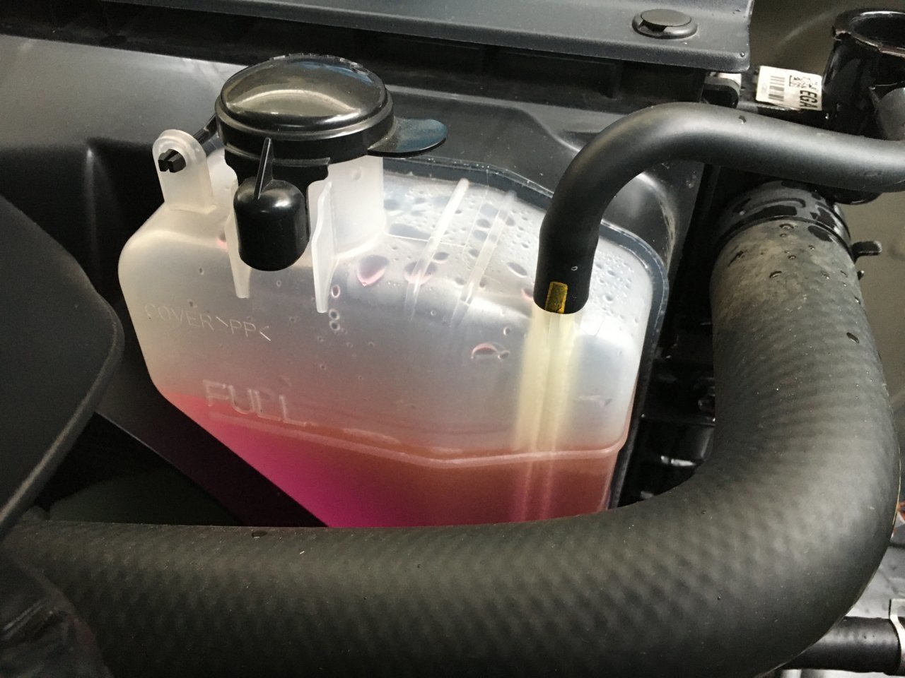

    I am chasing a seasonal overheating issue for two years now and could really use some help before I loose what hair I have left. I have a 2015 Tacoma 4.0 and live in AZ. Here is the story...
    Mid July two years ago I was sitting in the kids schools parking lot waiting to pick them up when I noticed the A/C getting warm. Looked at my Ultragauge and notice the temperature was upwards of 215* - 220*. Immediately turned the heat on and revved it up to lower temperature. After doing some testing I found that the truck will overheat only when in drive and the A/C on.
    I performed a cooling system pressure test and after 30 minutes and lost 2 PSI (engine cold). After consulting with a Toyota tech friend he said it might be a head gasket but start with the cheaper fixes first. I replaced the thermostat with no change then proceeded to replace the fan clutch, radiator, radiator hoses, radiator cap (tried stock and TRD) and water pump. At this point still no change. Finally, I accepted my fate and decided to do a head gasket. I discovered that #6 cylinder had a minor leak and replaced both head gaskets. Since this task I have a new set of symptoms..
    When in drive and A/C on the temp will take a long time to go up but will accelerate if I drive on the freeway and then go to surface streets and stop. In town my truck will run at 199* - 203* while on the freeway it will be between 204* - 208*. Also the ambient temperature does play a role in this as well. It seems that if the temperature is 95*ish or higher than the truck has cooling system issues. I did just replace the engine temperature sensor, tensioner pulley and belt 2 weeks ago. All parts that have been replaced are Toyota parts. After the recent replacement of parts I redid the cooling system pressure test for 2 hours and did not drop 1 PSI.
    This truck has stumped everyone that has looked at it. It has a BRAND NEW cooling system, could it be something outside the cooling system causing trouble? I basically at the point where I am throwing parts at it hoping something fixes it lol.
    **On an interesting note, when draining the coolant into a pan I have noticed a ring of sand in the liquid that formed at the bottom of the pan (pan was thoroughly scrubbed before use).

    I feel that it is purged of air, heater is blistering hot. I used a funnel just like the one you mentioned. Jacked the front end of the truck up so the radiator fill was the highest point then got to operating temp. Revved up to 3k rpms until bubble stopped coming out into the funnel and heater was super hot. Let the truck cool down with funnel on.

    I didn't do a leak down test, was debating on it as the cooling system held 18 PSI for 2 hours when I did a cooling system pressure test. Coolant levels are staying consist, I have my reservoir marked for hot and cold coolant levels. I cant guarantee that there was no air in the heater core lines but both hoses were super hot and heater was pumping out some blistering heat. I can try to crack open the heater core line splice ever so slightly and see if I get any air out.
