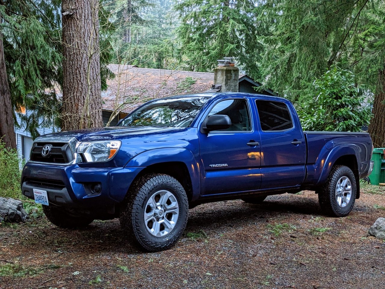

    The tires look nice and the lugs don't look aggressive enough to create a loud hum. Uneven wear pattern can be noisy. Do a tire rotation to see if the humming pitch changes.

    Hey y'all, it was the tires.
    Cupped, probably for lack of rotation by previous owner. And whatever quality Motomaster are...
    Anyways, Falkens on 17s now! No drone. Perfect.PXL_20230218_013342068.NIGHT.jpg
