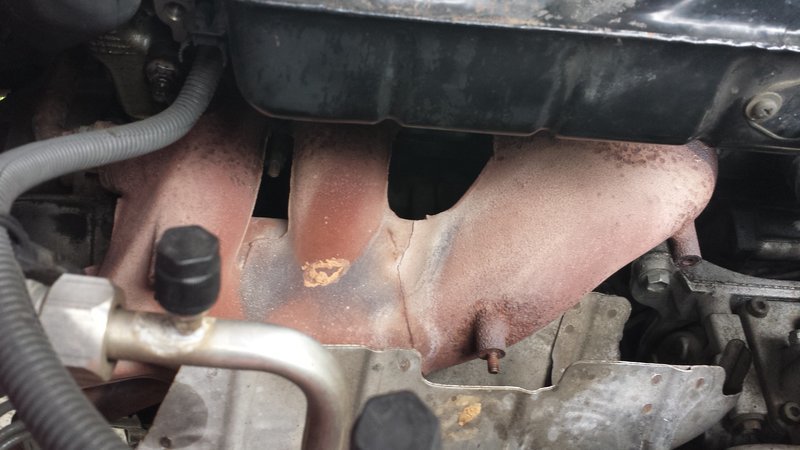

    Like I've seen in so many other photos, here's what i founder under the shield. I plan to order the 17141-75080 mini header, oem gasket, oem dual gland and oem EGR gasket. I can't seem fine find the oem EGR gasket number. Help appreciated.

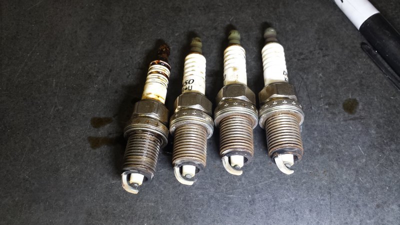

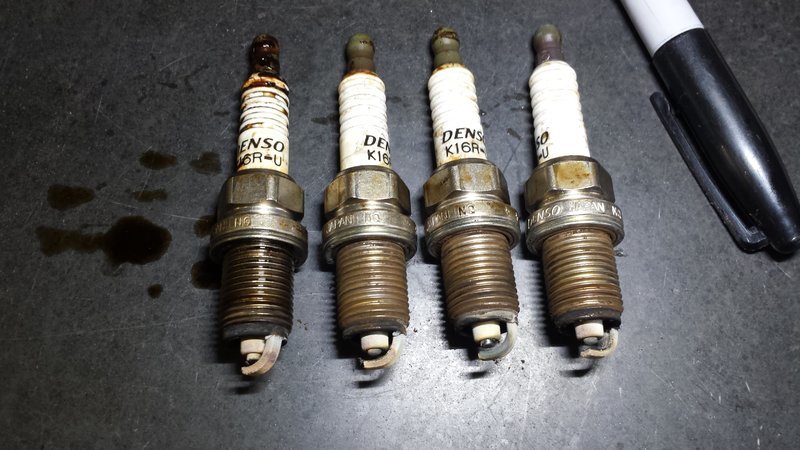

    Ok, here's the K16R-U plugs with 43k miles on them. Gaps are .038-.040". They look normal to me but I've never been a plug expert. What do you guys think..... maybe the mini header will fix the pinging? If not then try cooler plugs or something EGR related?
    Something else I noticed when removing the plugs is that none of them were tight, light they were inserted hand tight and never torqued. I know it was done at the dealer(I have dealer records).

    plugs look good. the top left one, is that oil?

    Yep, #4 grommet must be leaking.
