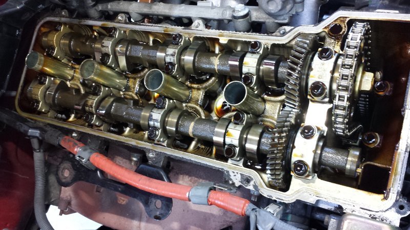

    Valve clearance is only slightly under spec on a few valves (worst ones are exhaust at .002" under). I'm very pleased with under the cover for a 290k motor. Chain guides look good too. I plan to surface grind the shims that are under spec or at the bottom end, looks like all of the exhaust and 1 intake shim.
