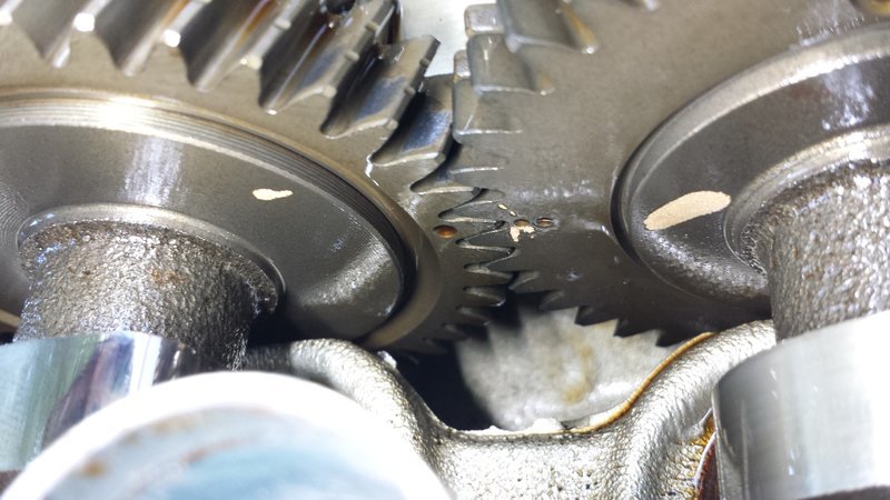

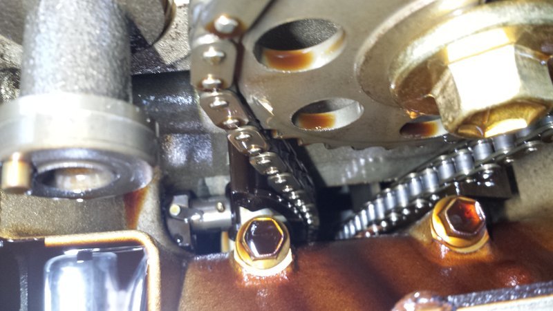

    Ok, OEM mini header installed and the exhaust leak is fixed. Unfortunately, I still get the same pinging between 2000 and 2540 rpm under load. Truck sure runs super smooth and quiet otherwise.
    I also noticed that I have a rattle/tapping noise from under the valve cover at idle. It only seems to do once it's warmed up. I suspect that I never heard it before due to the cracked exhaust manifold.
    I had the valves cover off to check valve lash and the tensioner seemed tight with little to no noticeable wear. I did two bad things: I rotated the motor using the cam bolt. I also rotated the motor backwards a little bit a time or two to get the lobes set right to check clearance. I know that these are both "no no's" after research. I plan to recheck torque(loosen and re torque) on the cam sprocket when I set valve lash.
    Could it be that the exhaust valves are slightly under spec and causing the pinging under load and rattle/tapping at hot idle? Setting valve lash is my next step.

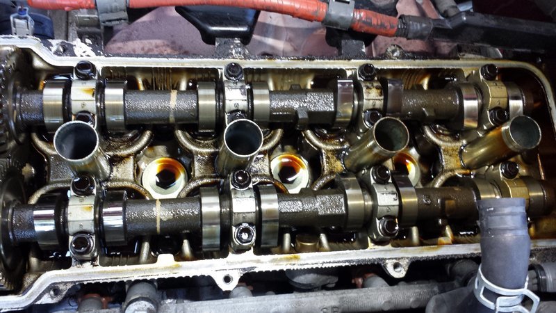

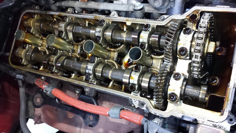

    i checked valve lash last week. Here are some pics from under the cover.

    Engine is super quite until it warms up. Once it warms up, the rattle/tapping noise can usually be heard at idle and the pinging is usually heard under load(or while accelerating) at 2000-2400 rpm.
    Someone suggesting a spark ignition issue may be the pinging issue. But maybe I need to take a closer look at the timing chain tensioner. Is there a good way to test the chain tensioner on the vehicle?

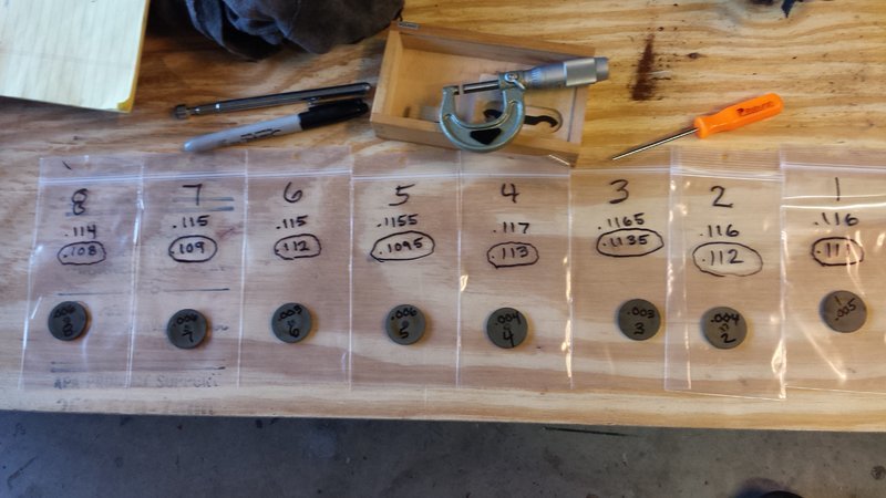

    Change of plans. I pulled the vc and removed the exhaust cam this evening. I thought it was best to correct what I know is out of spec first. I'll be surprised if taking the valve lash to the top of the tolerance will correct the pinging or idle clatter, but it needs to be done anyway.
    First step is TDC, set timing marks and install bolt(from valve cover) in cam gear.
    Then loosen cam bearing bolts. Remove bolts and caps and roll cam right put of there. Easy access to all 8 exhaust shims. No regrets about going this direction. If I only had to make adjustments to 2 or 3 shims, it would be different.
    Here's a few pics and a revised chart that shows how I'm keeping the shims straight. I'm plan to surface grind them at work tomorrow. I plan to get .013-.014" valve lash on all exhaust valves. The number that's circled on bag is what I plan to grind the shim to. The number on written on each shim is how much I will remove in order to get .014" clearance. I'll write the valve number on each shim after I grind it and it will go back in the bag with the valve number on it.
