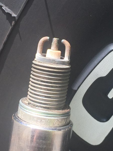

    That plug looks good to me. But have you tried running OEM plugs?

    They are OEM.

    Ok, mine are single. I didn't realize oem was dual or single ground.

    FWIW those plugs look pretty worn. The gap on the dual electrode plugs is supposed to be pretty close. The electrode tip is supposed to be circular. When it gets that oval shape that's a good sign they're worn. Not really convinced you have a spark issue if it runs /accelerates good though..

    Those plugs are gapped to .040 on each electrode. What do you mean "oval shape"? Tip looks good to me. Maybe the brown dust area is creating an illusion?
