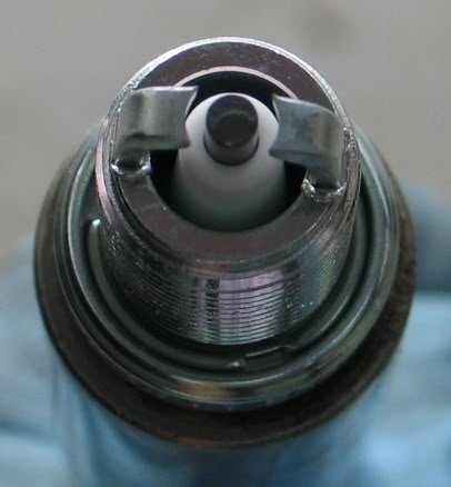

    IMG_0789.jpg I've read about guys on here "gapping" dual ground plugs.. IMO that is unnecessary. The only ones that need to be gapped are the single electrode plugs (And frankly if they're good quality plugs they should be ready to go right out of the box). If you buy good quality dual ground plugs they gap will be much closer than what is shown in the pic, they gap should not be adjusted, and the center electrode should be a perfect circle. The center getting the oval shape is what they look like when they are worn/been in service a long time.. IMO..
    Edit.. this is an example of a new dual plug

    Not going to get into a gapping debate the FSM says .043, but my plugs are Denso from the dealer and electrode tip looks just fine. Not sure why you think it looks eroded, I think the red dust on it is playing tricks on your eyes.
