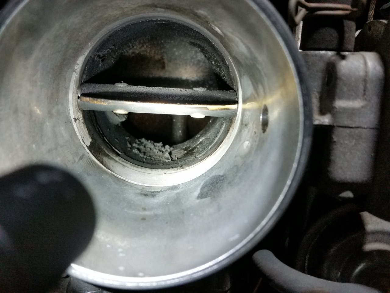

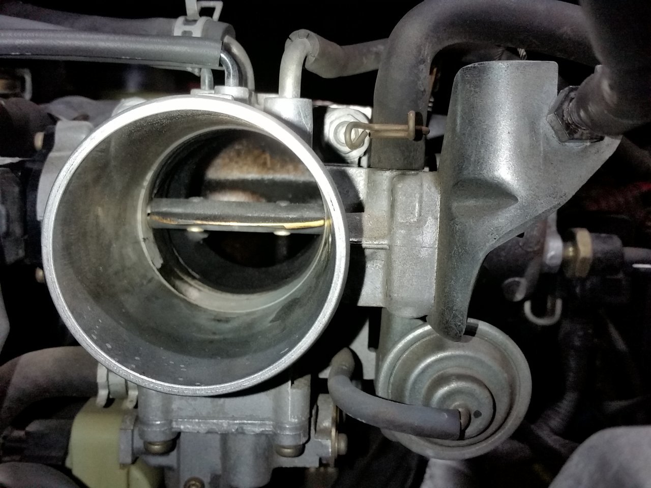

  18. Nov 17, 2017 at 4:56 PM
    #118
    rybern
    rybern [OP] Well-Known Member
    Apr 3, 2017
    #215281
    2,686
    N Alabama
    2025 TRD OR & 2000 SR5
    EGR modulator isn't the problem.
    I'm now diving into pulling the intake to clean in out. It does have a good bit of build up. Funny that it didn't look too bad until I scrapped on it a little. TB looks pretty good because I've cleaned it best I can without removing it.

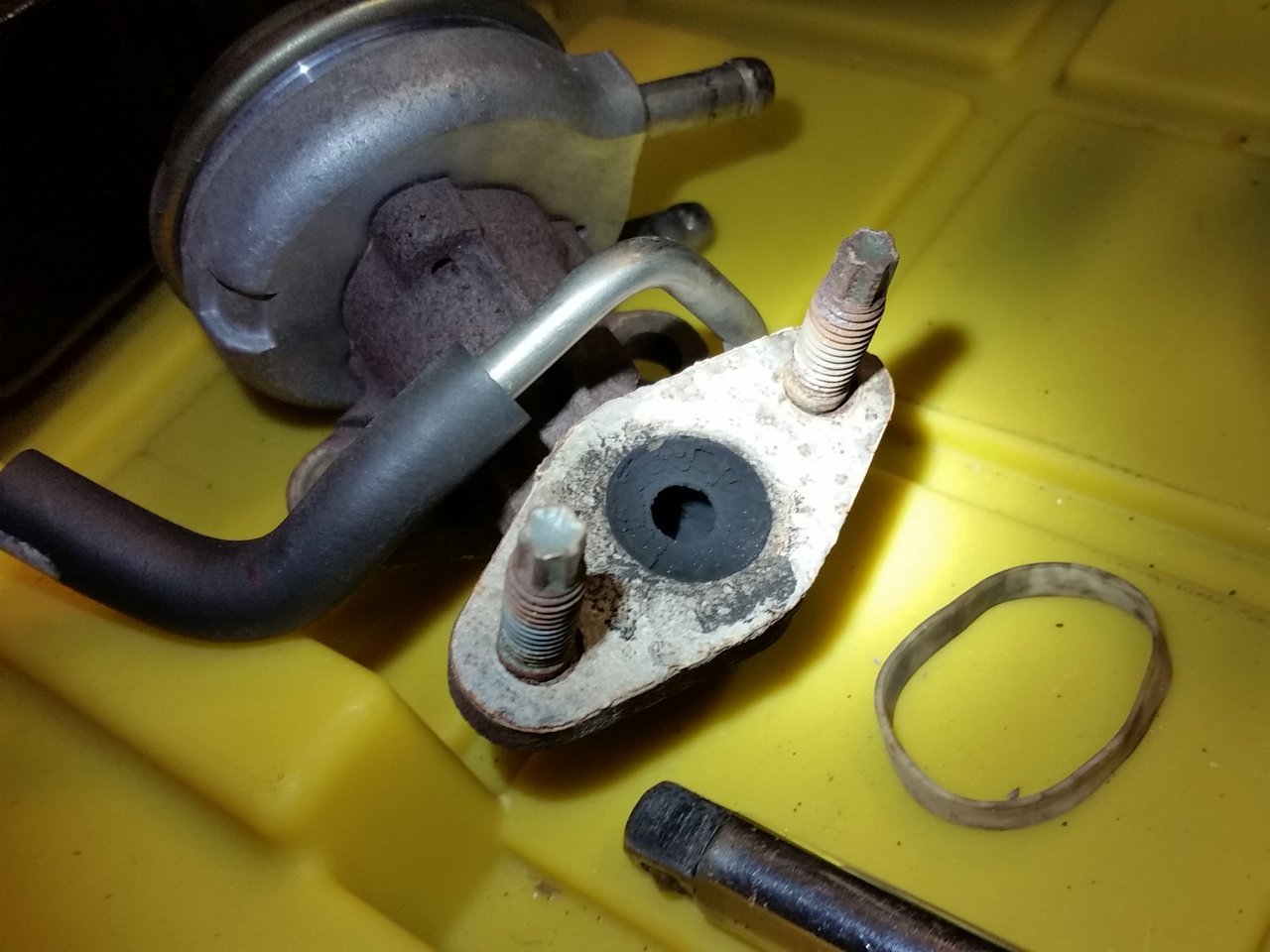

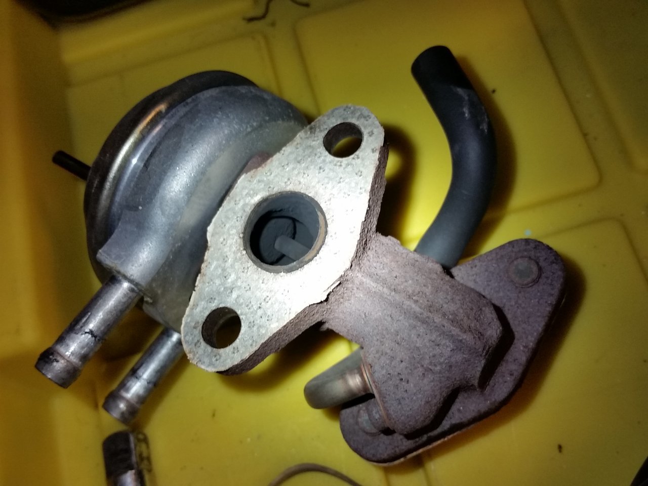

  20. Nov 17, 2017 at 5:36 PM
    #120
    rybern
    Apr 3, 2017
    #215281
    2,686
    N Alabama
    EGR valve.
