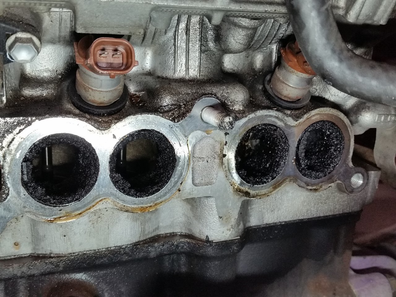

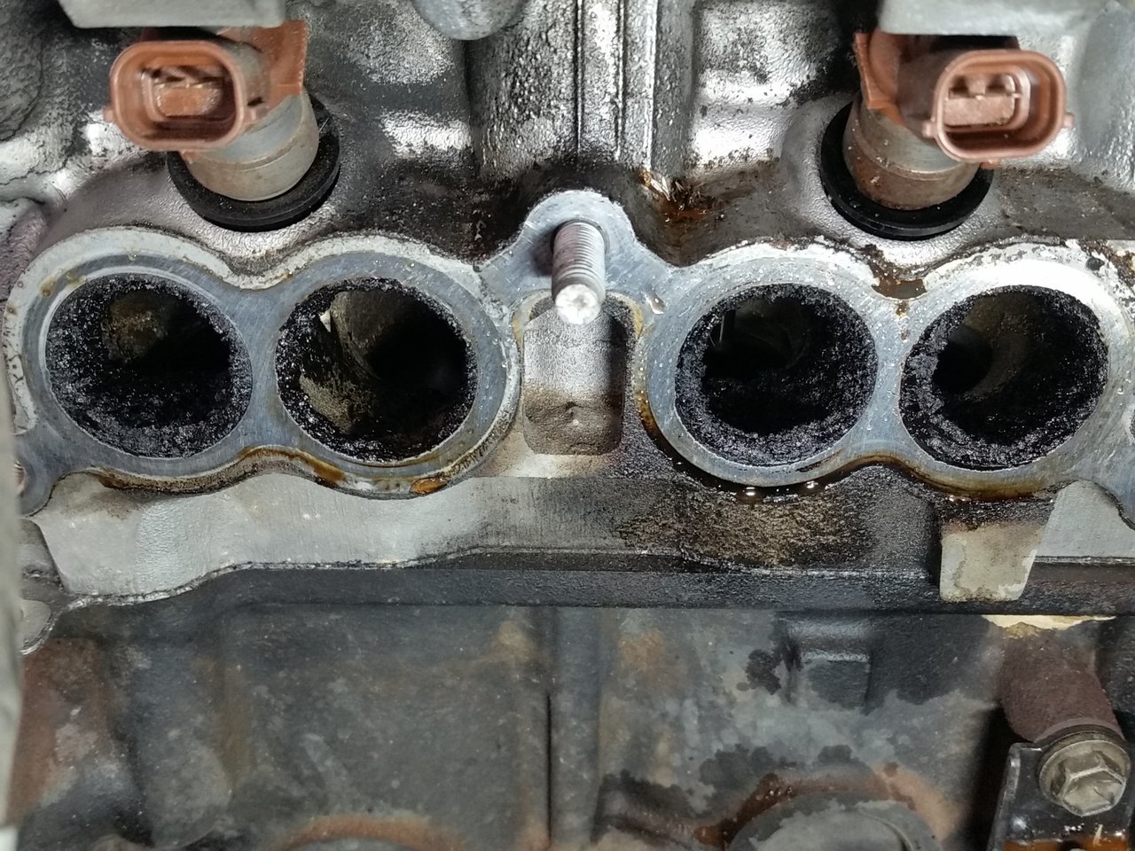

    I went ahead and pulled the lower intake plenum and... Holy sludgefest Batman.
    Here's #1 and #2.

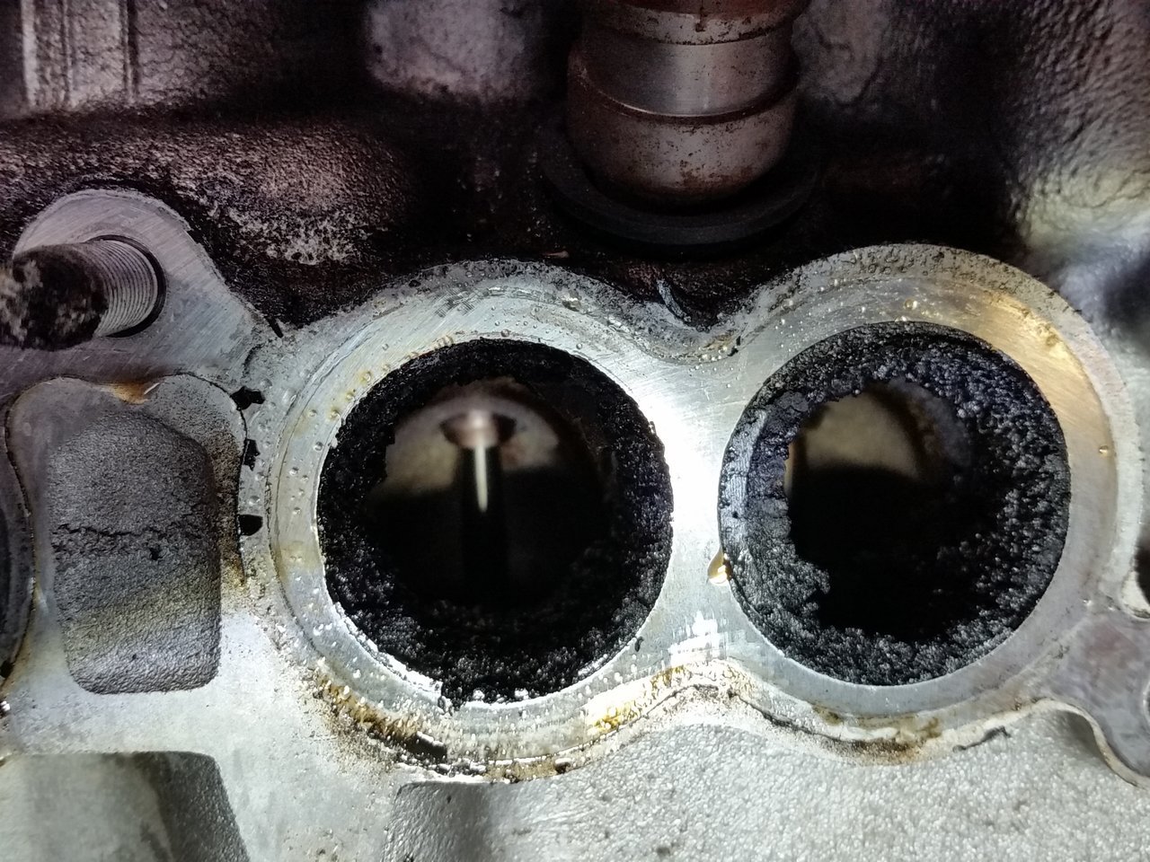

  5. Nov 18, 2017 at 10:46 AM
    #125
    rybern
    rybern [OP] Well-Known Member
    Apr 3, 2017
    #215281
    2,410
    N Alabama
    2023 TRD OR & 2000 SR5
    5100's & 3AAL, 265/70r17 Toyo AT3
    Here's #3 and #4.
    But the worst is #4.:eek:

    Damn you hats a lot of carbon build up! Cleaning all the junk out should make a noticeable difference. While you have it apart, you should really consider also having your injectors cleaned and flow tested or just buying a set of pink tops to replace them.

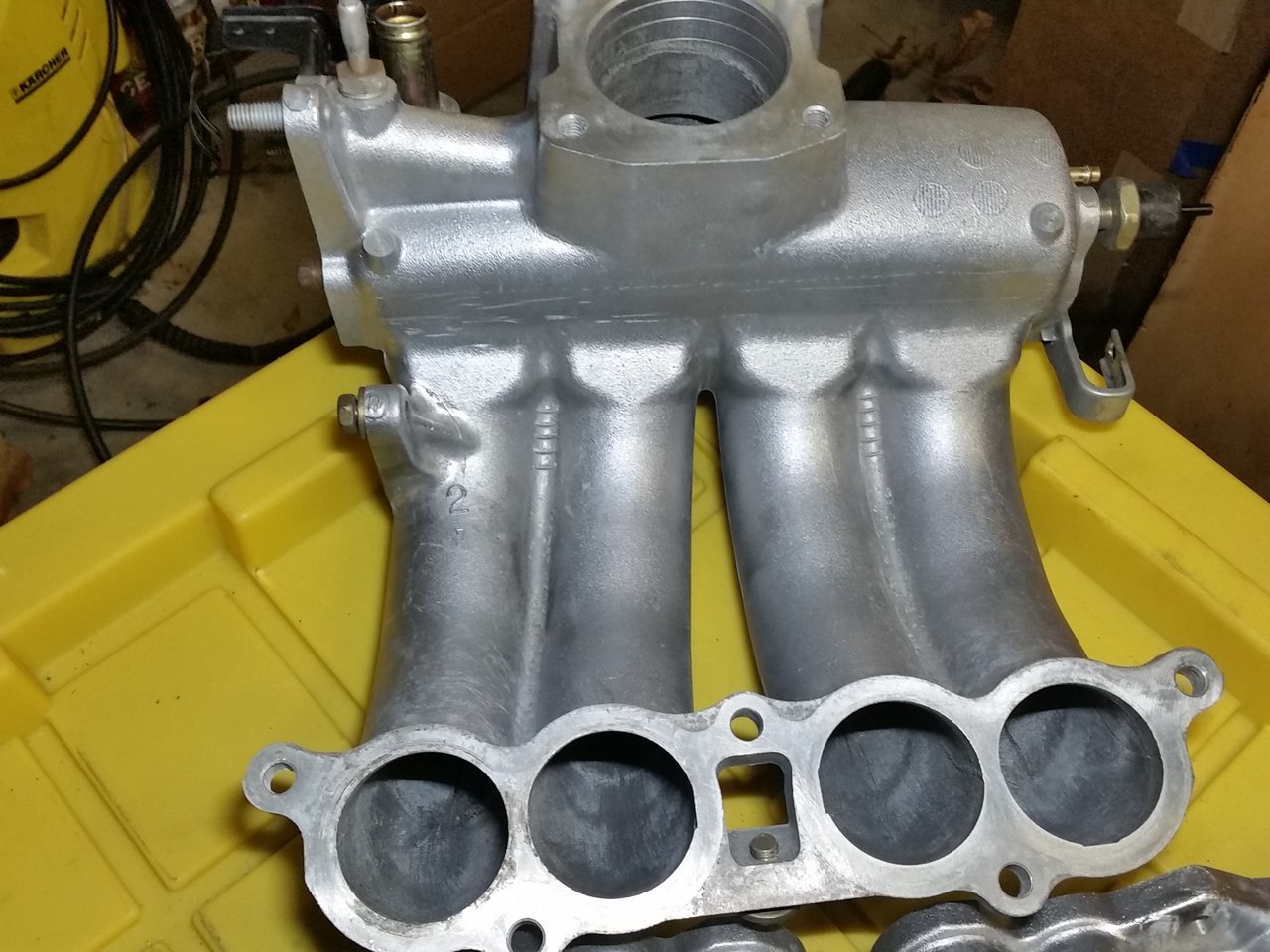

    Thanks for the response. After sleeping on it, I'm not sure about pulling the head. Doing so would really turn this into a much bigger job. Maybe the HUGE amount of build up in the bottom of the runners is causing the pinging, or an injector issue. Maybe I'll get in there and clean the build up out best I can, vacuum it out, gets some injector refurbs and button it all back up and hope for the best.
    Downfall is if I still have pinging, the next step is pulling the head.... I guess. I guess it boils down to if I think the problem is more likely due to the huge amount of buildup in the runners (or clogges injectors) or build up in the combustion chambers.
    Thanks for the input. I discovered that scraping the big stuff off and then spray degreaser, scrubbing with wire brush/long bristle brush and then pressure washer worked pretty well.

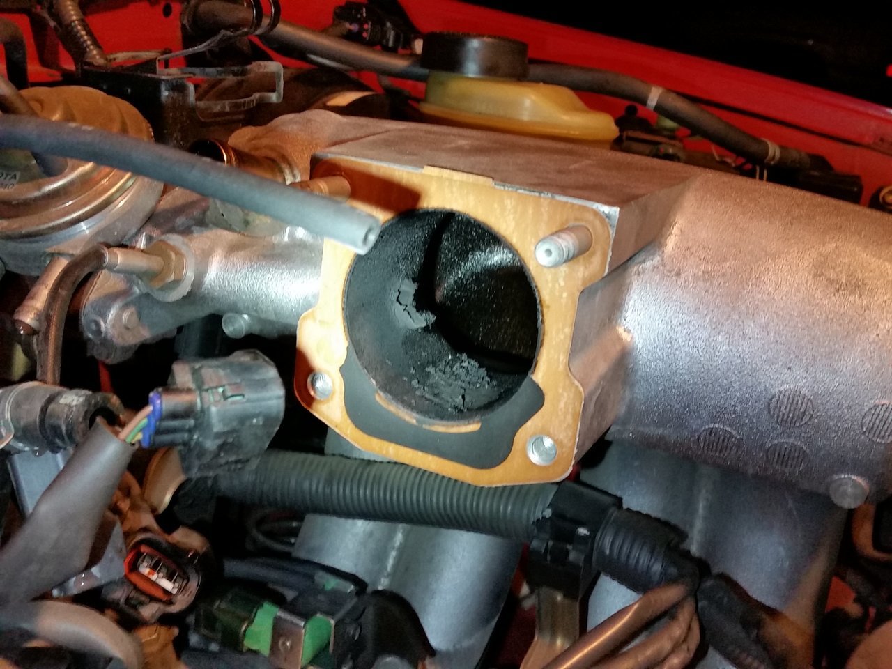

    out of curiosity... how does the EGR port look and does it have a passage that distributes the gas or does it just dump it in one spot?

    EGR port has some build up in it but not bad at all. EGR valve dumps into a side port at the beginning of the intake manifold. You can see the build up on the left side of the intake port in the pic below(this is where the EGR dumps in).
