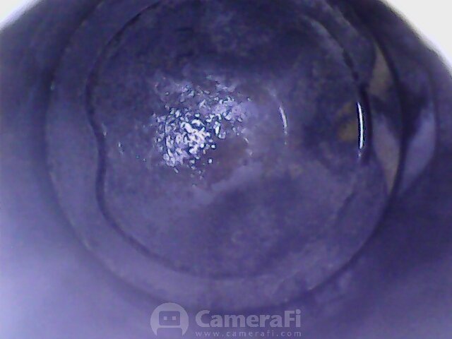

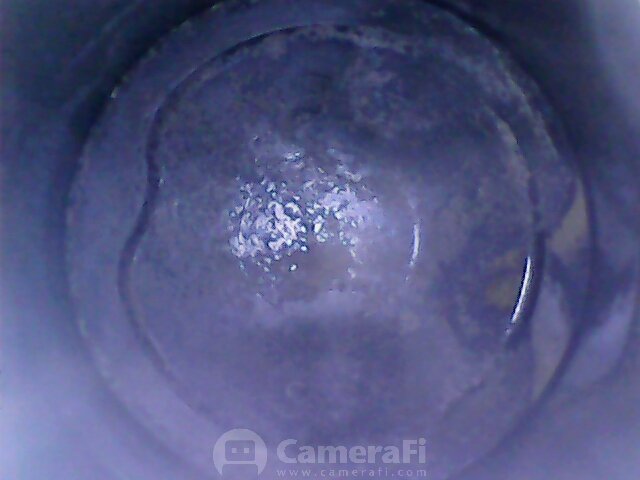

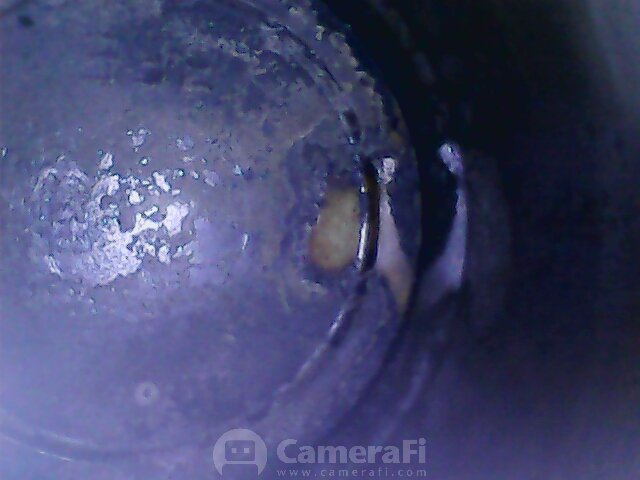

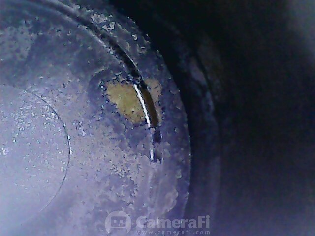

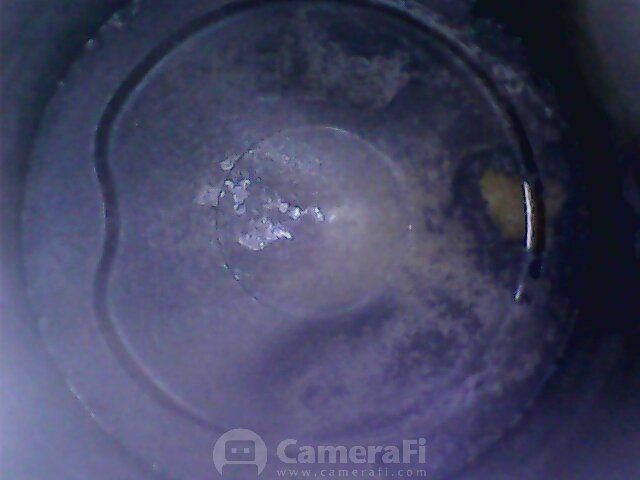

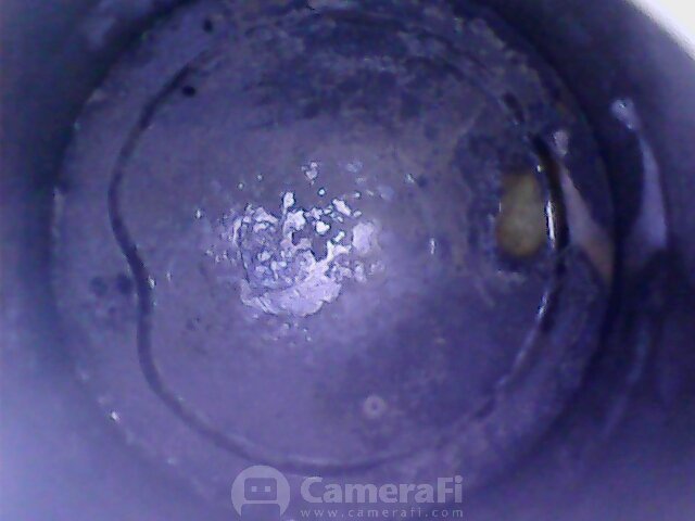

    The angled mirror didn't work that great so no shots of the bottom of the head. But here's some pretty good pics of the top of pistons. They all pretty much look the same to me but I don't have much experience diagnosing internal engine components. I'd say that the buildup looks minimal.
    Here's #1
  10. Nov 23, 2017 at 7:21 AM
    #150
    rybern
    rybern [OP] Well-Known Member
    Apr 3, 2017
    #215281
    2,688
    N Alabama
    2025 TRD OR & 2000 SR5
    Here's #2

    Here's #3

    Here's #4.

    Hmm. I would've expected more build up as well. Especially after seeing the intake runners. Maybe it is just the build up in the runners causing issues. The scope pics are impressive! I gotta get one now:D

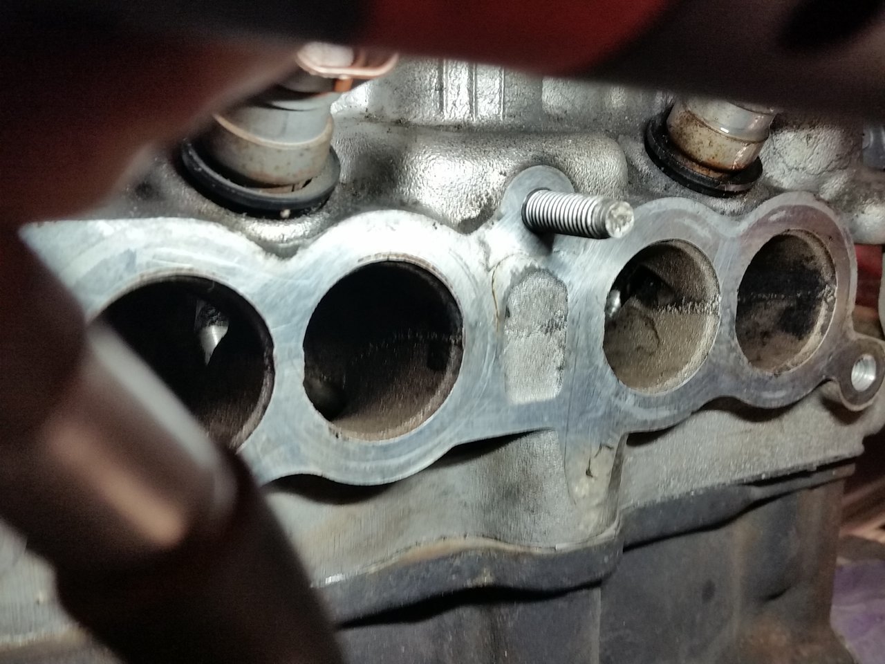

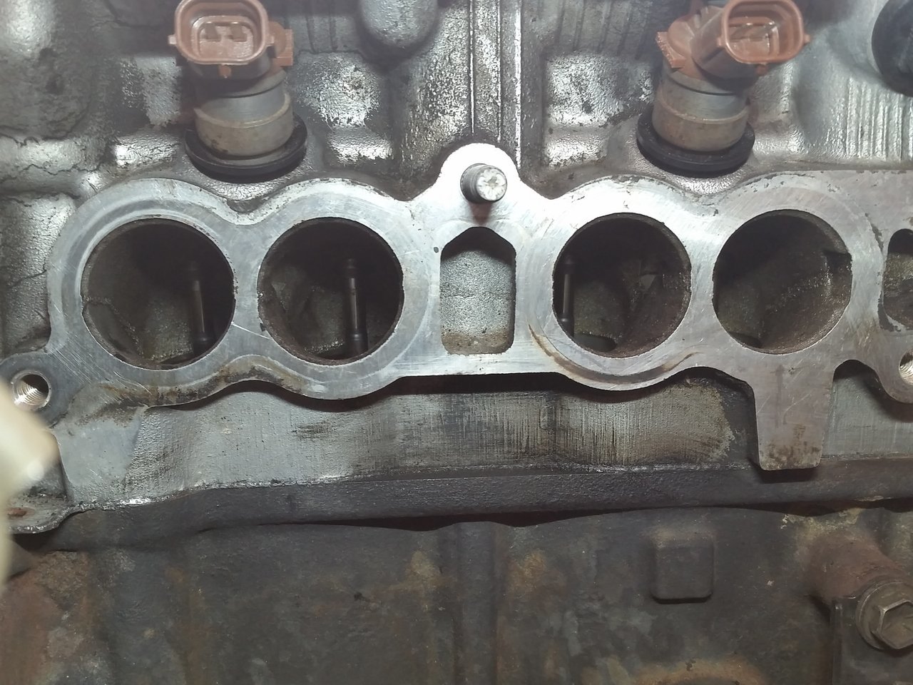

    I got the head ports cleaned up. The scrapper worked awesome. Then a rag soaked with carb cleaner cleaned the rest followed by vacuuming.
    Here's #1 and 2
    Here's #3 and 4

    Looking good. That's what I meant, the head, not the intake runners. But yeah, looking much cleaner lol

    my curiousity is with those clean spots on the edge of the piston. The edges of the carbon will glow and that will cause a pre-ignition. I have no eperience with Sea Foam so I do not know if it is a carbon treatment or not.

    Lower part of the intake runners were nearly as bad as the head ports. It's unbelievable how much buildup I've removed.

    I have no idea but I'm very curious what some experienced folks will think about the piston photos.

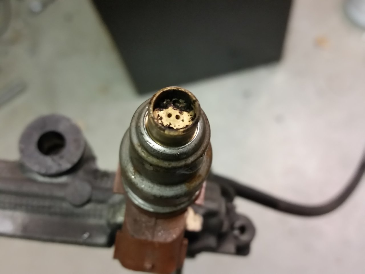

    I don't have the new injectors yet but went ahead and took a look at the old ones. They all have a little build up at the end, but here's the worst one.
