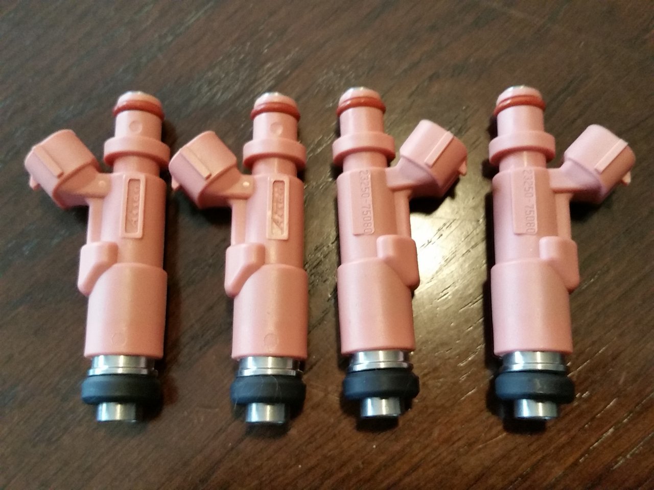

    Got the pink tops today. They look legit.

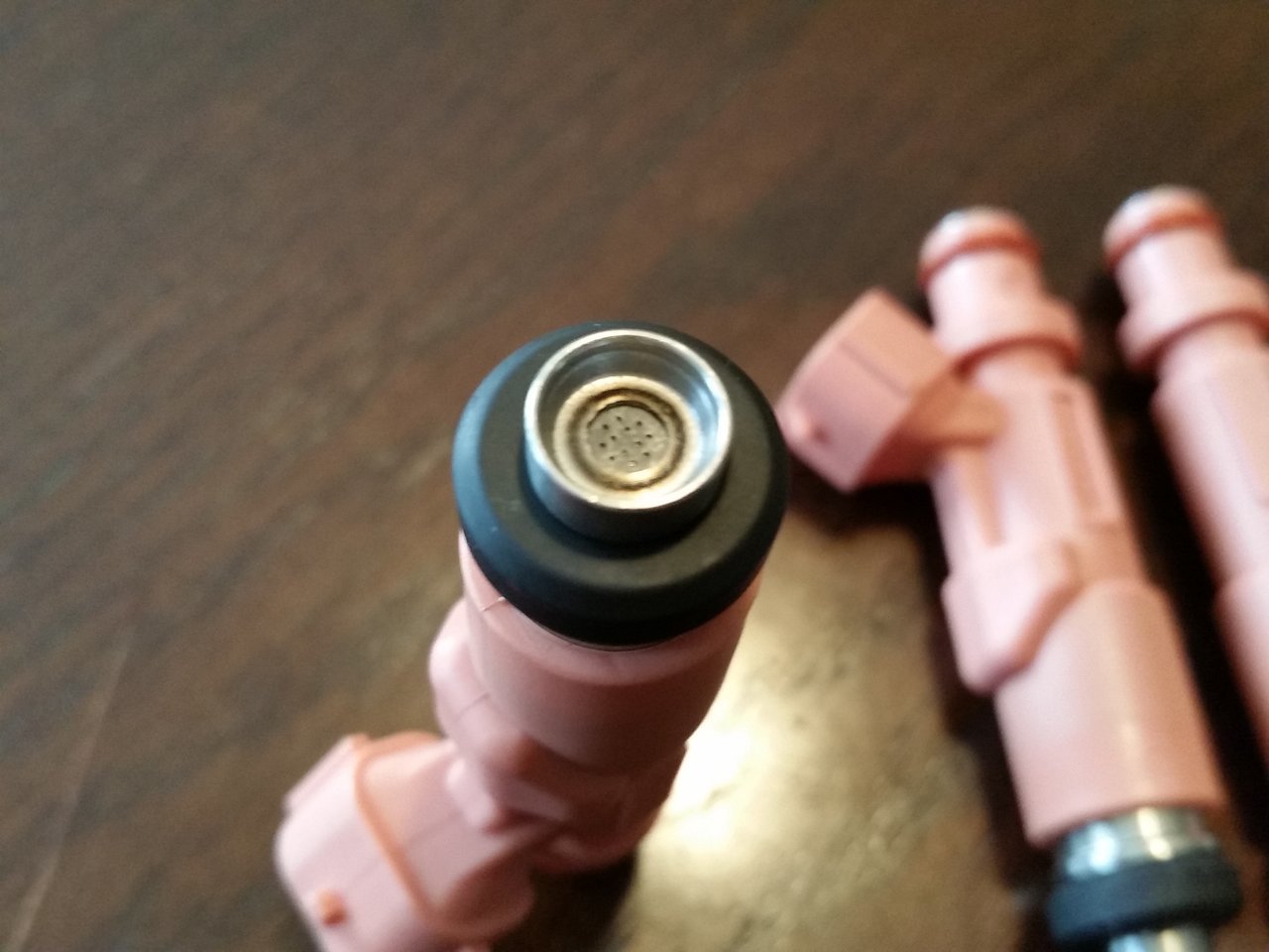

    The spray patter. Will be way more efficient on those compared to the old browns

    They definitely have more holes.

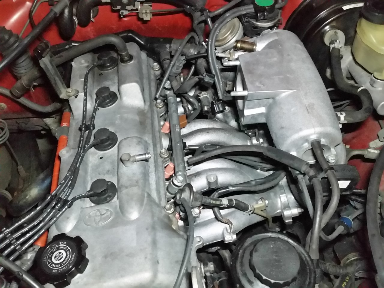

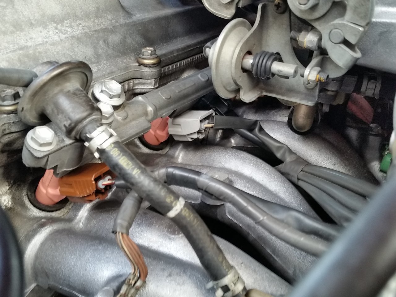

    I got it all back together and truck started up and sounded great. I smelt fuel and discovered #3 injector pouring fuel out between the rail and the top of the injector. Pulled the air intake and TB back off and pulled the fuel rail to discover a bad O-ring. In fact, all of the Orings were .070 thick while the original Orings that came off my old injectors are .078" think. I swapped all of the old ones over to the new injectors and put the rail back on. Unfortunately, I broke the TB gasket when I removed the TB this time. I've already called Oriellys and they will have another gasket between 8-10am. So, that's it for tonight. Man it was great to hear it fire up and run. :)

    I got it all back together(for the 2nd time) and fired it up. Sounded good but a first inspection shows at least 3 injectors leaking between the top of the injector and the fuel rails. This was with the old o-rings. I'm a bit surprised and now thinking there is a problem with the injectors. Off to the part store again to get new o-rings. Back home and a bit or research and this time I installed the injectors with a super light coat of dielectric grease(I used gas previously). I suspect that without proper lube, the o-rings were rolling out of the groove and leaking. Then for the 3rd time, I meticulously put everything back together. Fired her up and all is great. Truck is definitely smoother, starts quicker and even idles quieter(its always been pretty smoother but its actually quieter). A quick test drive reveals No Pinging. Under no circumstances was I able to get it to ping.
    :cheers:
    I'll know for certain when I take a longer drive but the truck was warmed up for my test drive and I nearly certain that I'm finally a success.
    Here's two celebratory pictures of it all back together and of the pink tops. In the end, it was the intake buildup or the injectors. I'm super curious to see what kind of mileage I get now.
