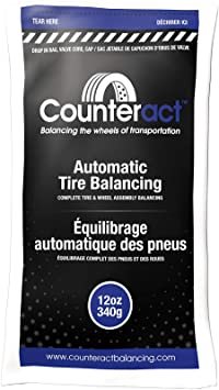

    Tire balancing: lead weights or ( the name escapes me) bag of beads? These things FC8FCF0E-6073-4434-8B82-6FC1292C176B.jpg
