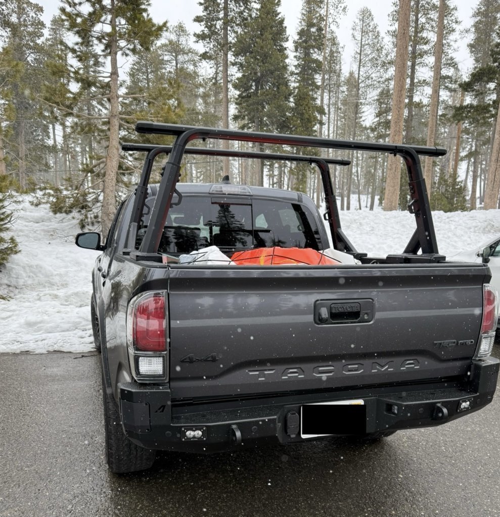

    For those who care or those who end up on this thread, I was not able to fix the sensor. I've been in talks with Chassis Unlimited for about 3 weeks now trying to figure this out. They are now talking to their engineers to see if they can get a bracket designed for me that allows for more movement on my sensor so I can move it around a bit more to get it positioned correctly.
    According to my Gearwrench Professional Diagnostic Scan tool, it's saying that the slave BSM's horizontal axis is off. So hoping that the new bracket is going to help with that. I'll update if there's anything else.
    Original:
    Hey everyone! I was wondering if anyone has installed a Chassis Unlimited Octane rear bumper that accomadates the BSM and how that's been working out for you in terms of the BSM working.
    I recently just got it and my BSM isn't working at all, or throwing false reads. Was hoping to see what I can do about it. I had a shop do the installation and calibration and they can't get it apparently.
