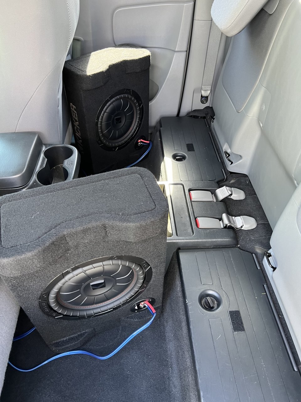

    I just did something very similar in my access cab. There’s a few options that fit behind the seat pretty well.

    Hi Cosmic,
    Nice looking sub! Do you have rear door speakers? If so, did the the truck come with them or did you add them later? I'm adding them hopefully this week, but since I do not have OEMs already installed, I'll have to modify my rear door panels to uncover the speaker grills. I'm looking for ideas. I referred to a thread above that has a couple of decent ways to do it but hopefully there's some other options out there that I've not found yet.
    Thanks!

    I do have rear door speakers, my truck is TRd Off-road, I just swapped out the back panel to the utility panel when I removed the seats and installed the Goose Gear platform. That being said, they’re unnecessary in my opinion, and I only run them off the head unit while my amp powers the fronts. If I were you, I’d put no effort into installing rears. Put the money towards a better front component set and amp.
