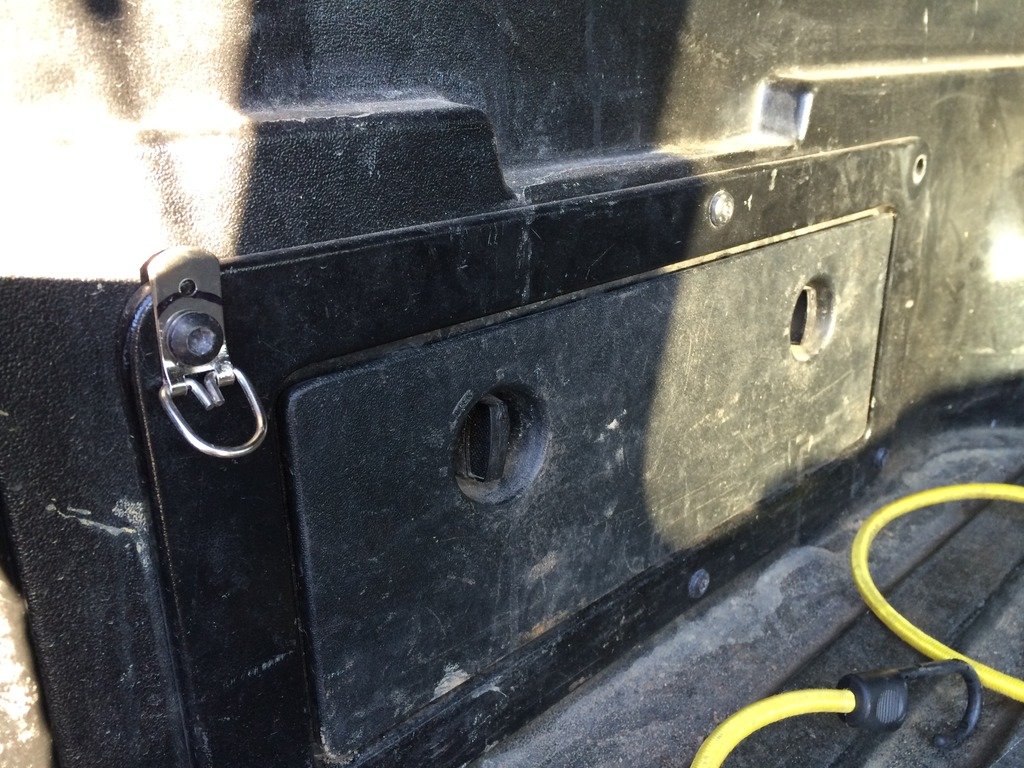

    Yes they should flip up and down as well

    Thanks! I was going to take PB Blaster/a hammer to them to see if they would free up but then thought I should ask first. lol.

    I used Rust Cure Formula 3000 on mine about a year ago , still working good

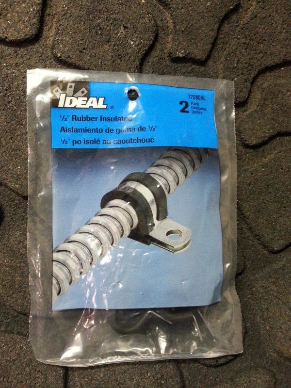

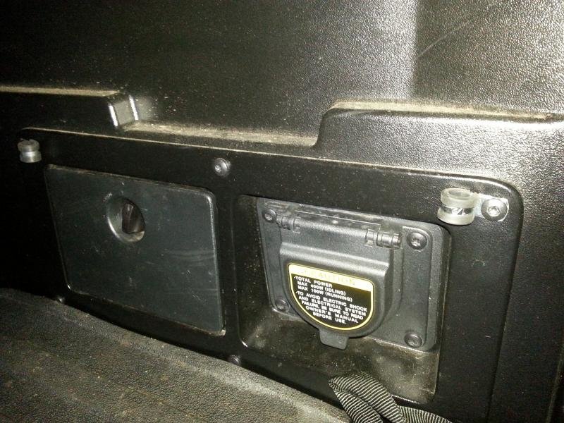

    Thanks Gabassman....all credit goes to you on my mod...I bought rubber insulated conduit clamps..why rubber coated? I didn't want to create a knuckle buster...these at $1.70 a pair and strong. I put a set on each side...no drilling, just unscrew, insert, and retighten...I'll post this in cheap mods also.
    pics tell all...

    Nice. I do like that idea. I looked and looked for some rings locally but couldn't find anything. Finally found what I used, online. I'm glad that folks are still finding this useful.

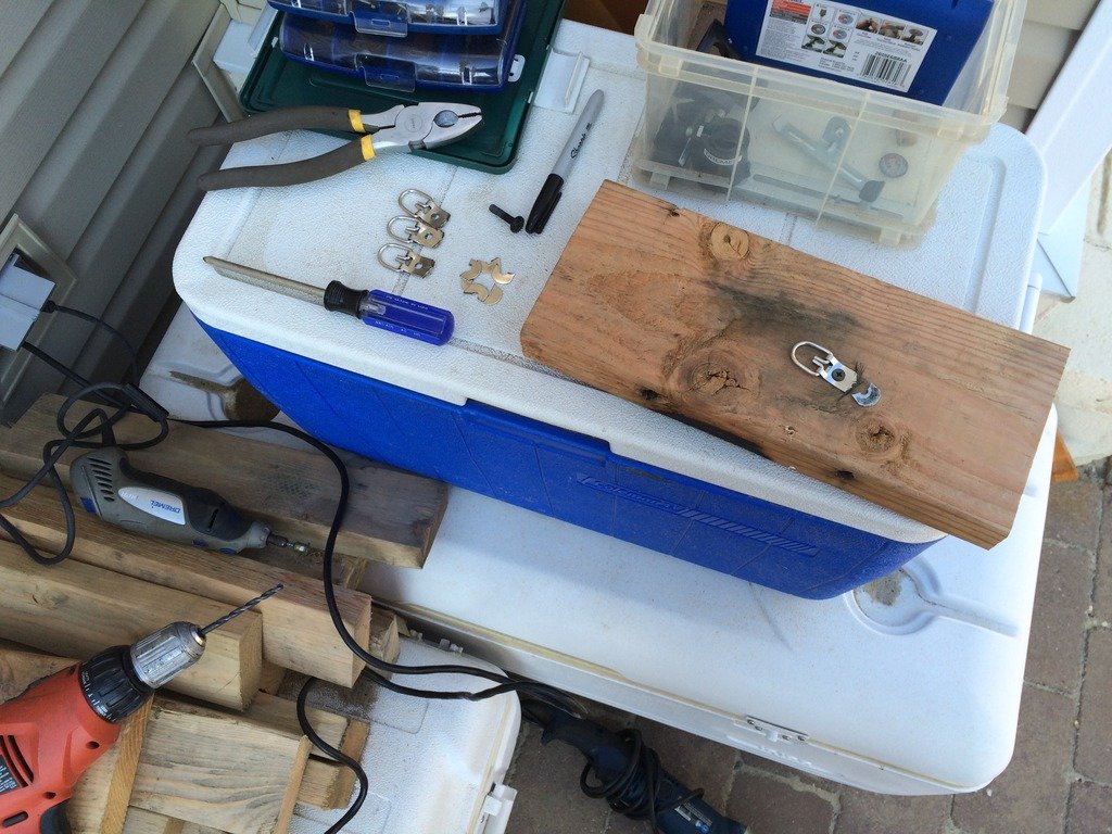

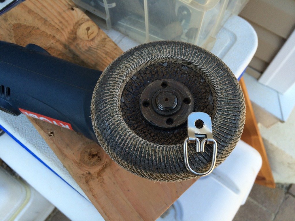

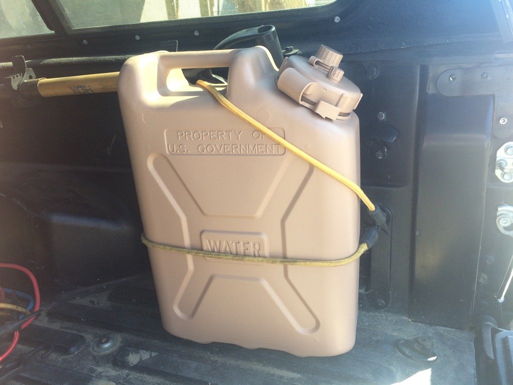

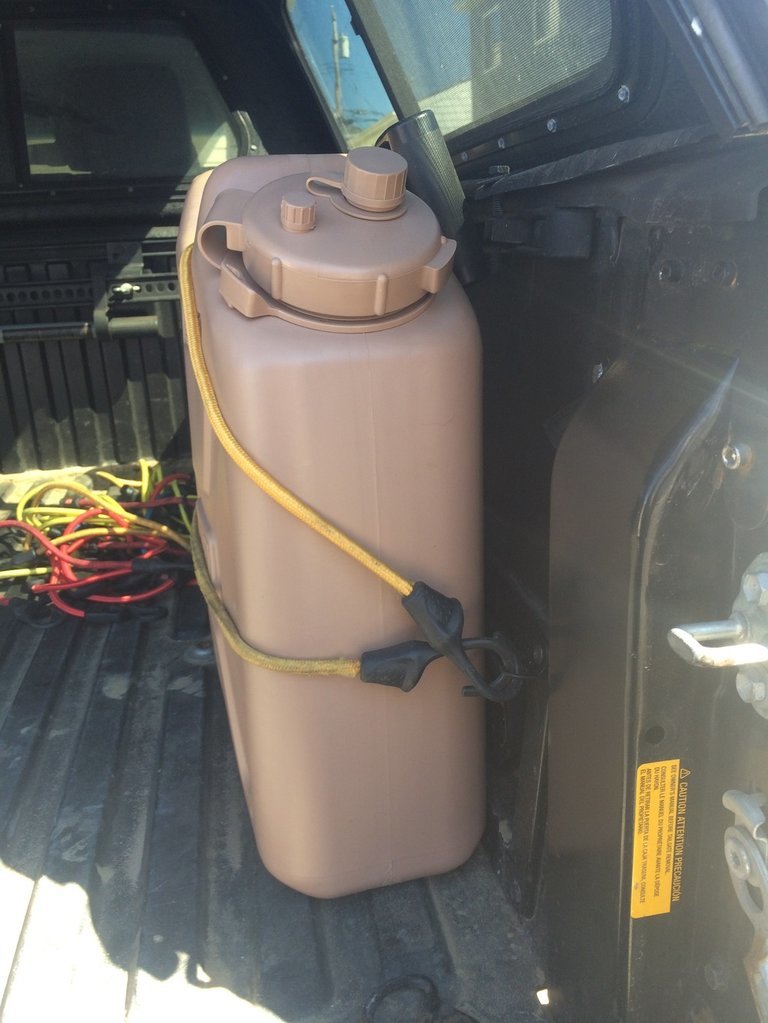

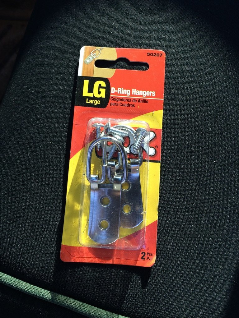

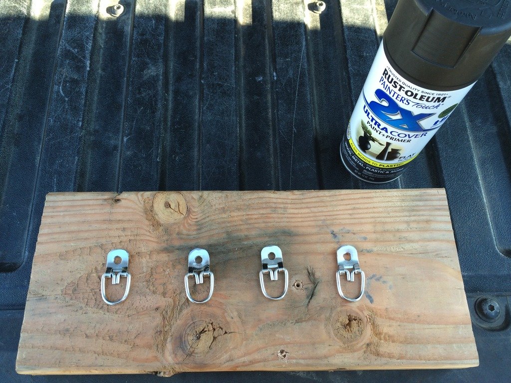

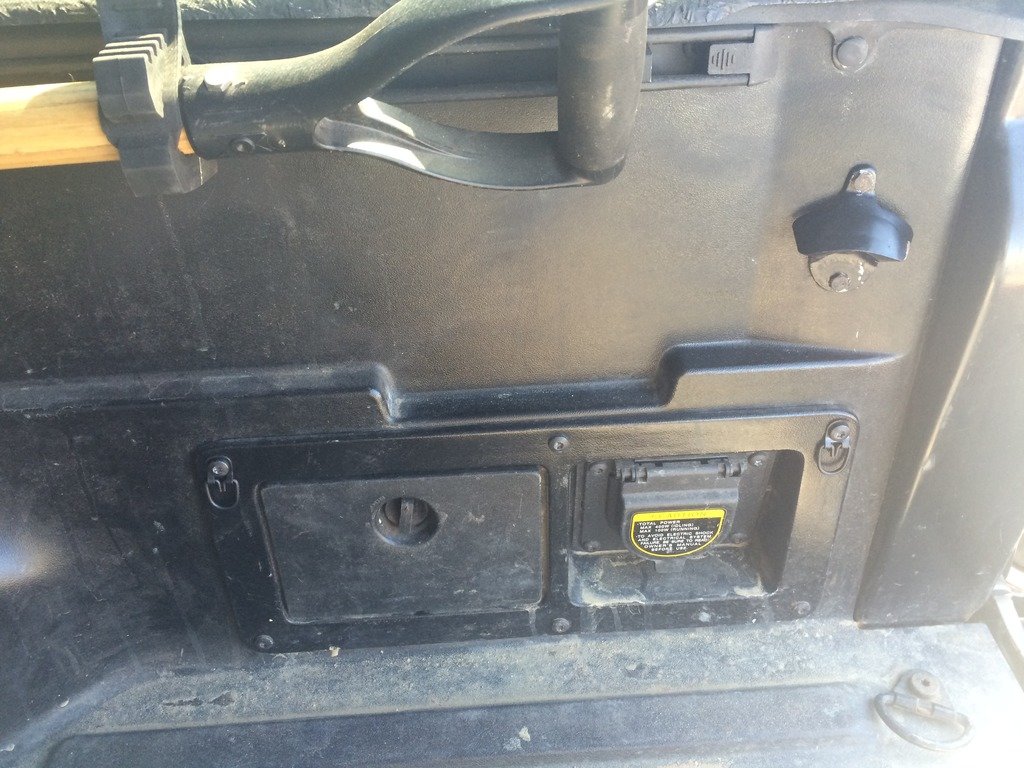

    Did this yesterday. Great idea OP! Rep sent your way :thumbsup: So obvious you would never think of it.
    E44FA8F0-6C94-4A95-99F0-0EE42B8BDB65_zps_389da6c8f19ce1f84df85a46fb3898e4c31b43ac.jpg
    4C25C47F-8F6F-49B5-8333-F7538916C914_zps_b4d14688634c83774ed10712a42fd648a8f026c4.jpg
    5F83C42B-0664-41E3-AAA4-D566B6C3BEF1_zps_fa1f3960092d333b22c71a140cbb3833fe606631.jpg
    46FA5560-83D7-4B73-B516-DB87DAC81C10_zps_2eb3c4b118eec3f75461a9f6273443c355427ada.jpg
    24858BA7-2AB2-4B01-B533-24094437AB81_zps_40b1102cda1aa80e08c5fc7f51c3324b1bb03d08.jpg
    174587CD-D6AC-44B6-9E86-88B33D767DA5_zps_d1b0ed8b548a0eeb9cac6c61dce919364c7289b2.jpg
    74D06A16-A8DB-4B40-BAA5-919DB04EBDAC_zps_99eed5c58f78c099f23bd3230472abbaa215630b.jpg
    3C9DF024-74F9-4B30-AF13-347339D8CBB9_zps_8cddb620bd86188ef77942414ec1ddc424181981.jpg

    Get the web strap , shit can the $1.49 day bungees
