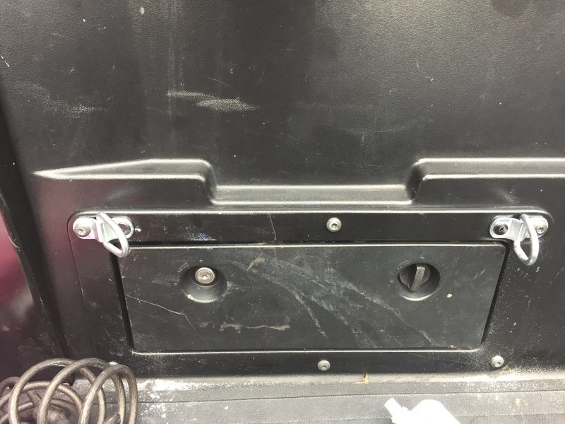

    Used your method today! Since it's hard to find D-rings with silver holes I just got some surface mount ones and cut out the D-ring portion.

    FYI , if you slide one of the bed rail tie downs down to the end , they fit perfectly into the handle void of the MFC cans
    Thats how I attached mine with a web strap

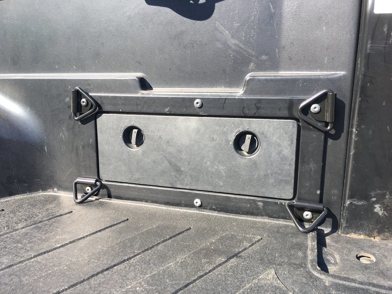

    Did mine today. Hardware store only had 2 hole tie downs, so I just drilled a second hole and attached a small bolt in the second hole.

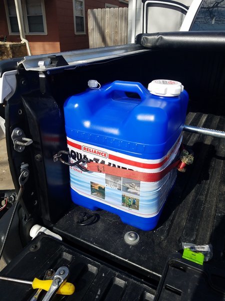

    Just wanted to throw out a big thanks guys. I was searching for something cheap and came across this thread. I took both of your ideas and made my own little twist, it's rocksolid and just what I was looking for. I added a small strap across the top for ease of removal and insertion.

    Just got my rings in the mail. Went with some hefty 2" steel V rings ($13 for four). Definitely overkill, I know, but I figure I can always mount them somewhere in my bed with more support and use for heavier loads. https://www.amazon.com/gp/product/B01CGXSNC0
