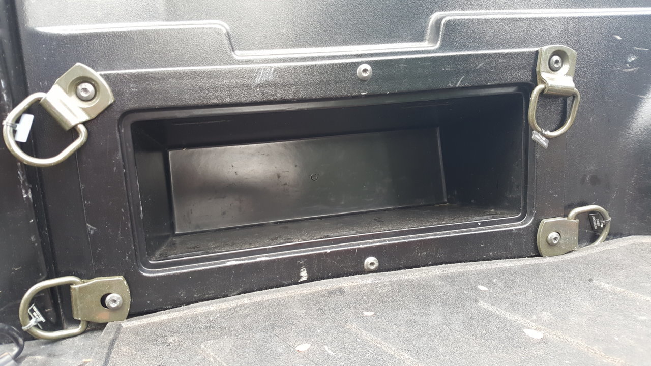

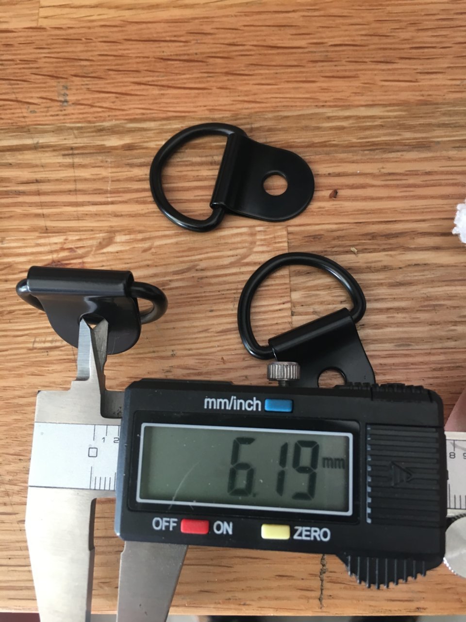

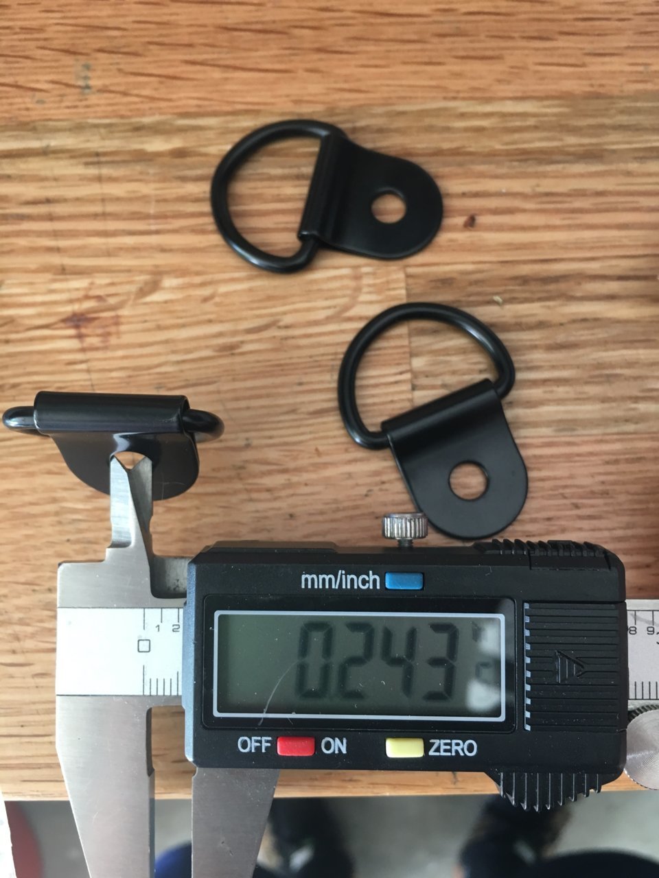

    The D rings from Amazon have a 3/8" mounting hole. The bolt used to secure it is 6mm, too much wiggle room. I used 1/4"ID x3/8"OD bushings to take up most of the wiggle room......

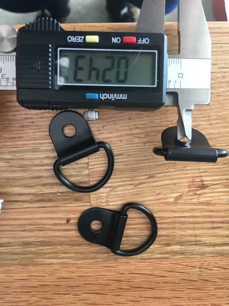

    Hmmm ... this is consistent with the Amazon reviews too regarding fitting. Except the rings have a 13/32'' mounting hole.
    Regarding fit I suppose I could just get different bolts to replace the stock ones in the bed.

    The other issue I had with these D rings is that when exposed to the elements, they will rust..... don't know if they will fare any better under a tonneau cover.....

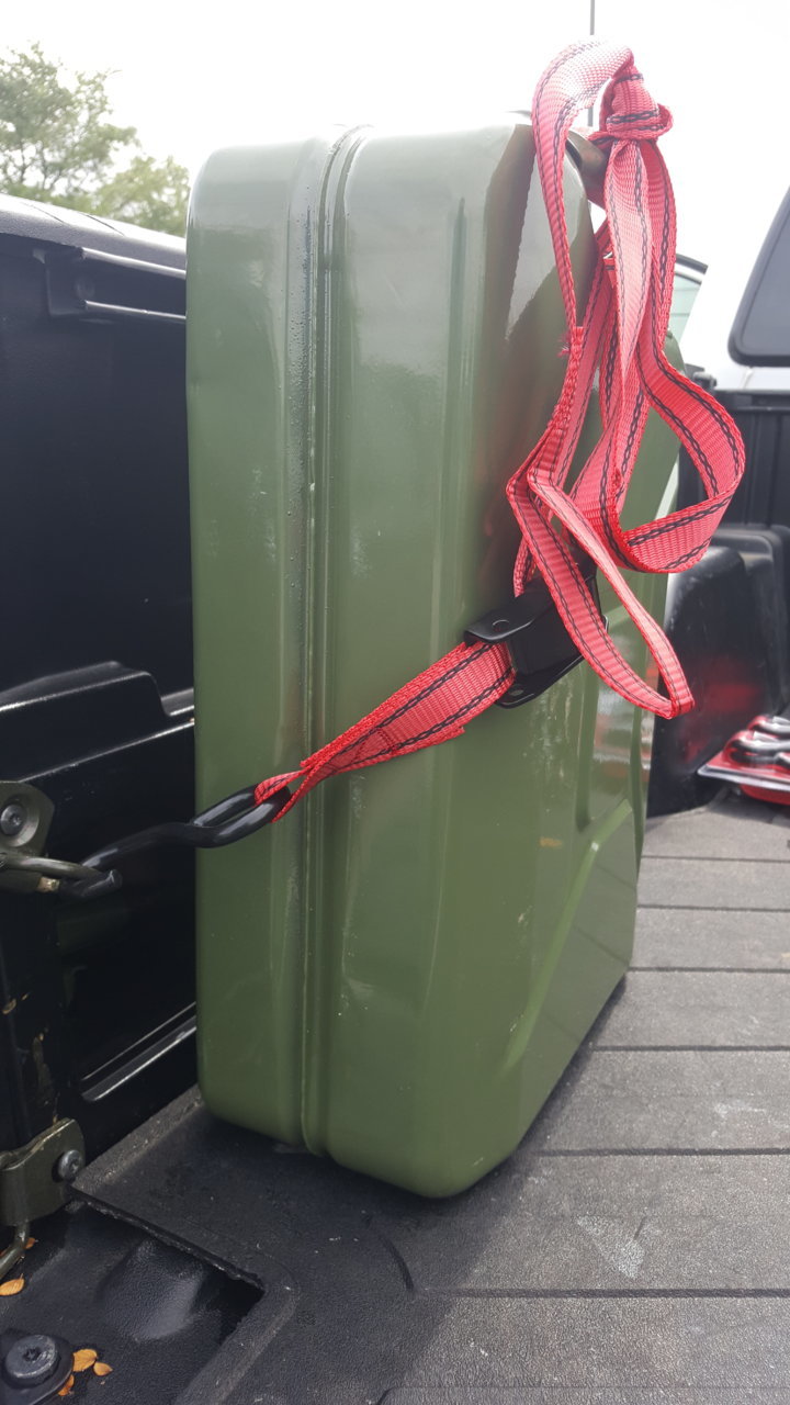

    I wonder how it would work out to put a jerry can of gas back there... just gotta figure out how to lock it down.

    I'm using a web strap until i find a good way to secure it with a padlock.

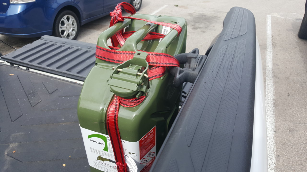

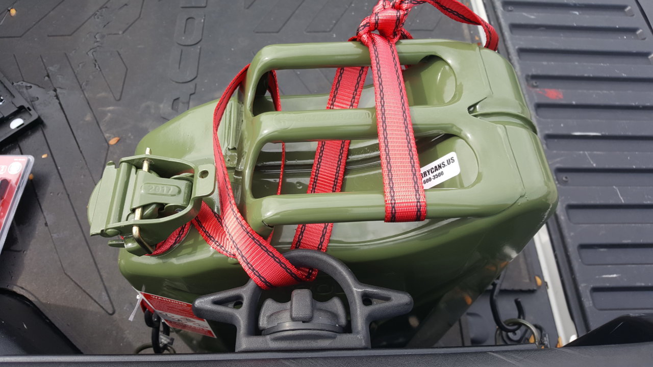

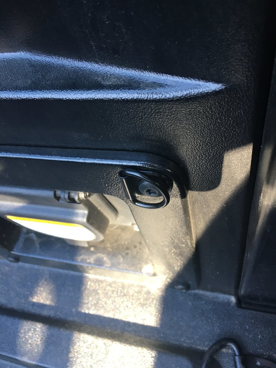

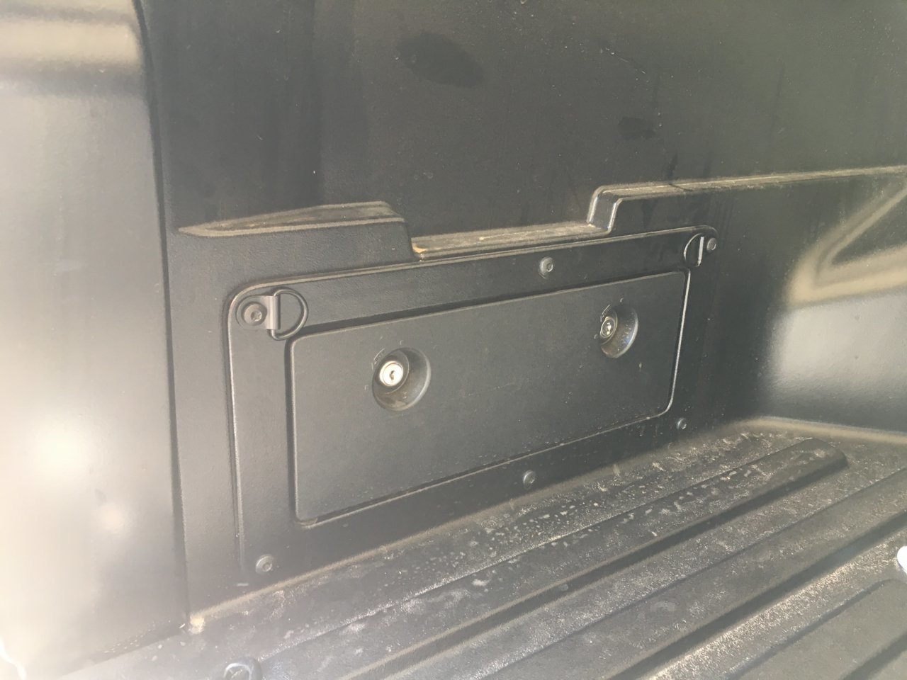

    Good call! My rings came in today. Super heavy duty and no modification required as they are the perfect size for the stock bolts in the bed compartment.
    I ordered 8 and one was slightly out of spec - too large. All in all, I'm happy.
    I bought the "Husky 1 in. x 10 ft. Locking Tie-Down with S-Hooks" from Home Depot. The can is very secure and its not going anywhere - i took sharp turns on the way home to verify. Word of advice, avoid the straps with the large ratcheting mechanism as it hinders your ability to tie the can down tightly. A simple buckle as shown in the pictures is adequate.

    The hole on the ones I got from Amazon were too large for the bolts so I bought fender washers at local hardware store and used those for install. Works fine and was cheap fix.

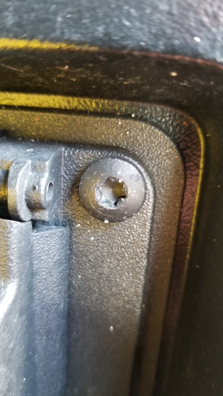

    What type of bolts/fasteners are these cubbies held in with? I ordered the tie downs but dont have any tool to take the bolts out. What did you all use ?
