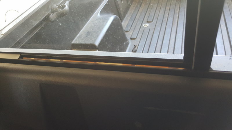

    Greetings Tacoma fans. Quick and easy rear window security tip for you.. I used a small pipe cutter, to trim an old aluminum arrow shaft, to fit the rear window rail; creating a sturdy lock for my rear slider. Pictures attached. Hope this helps someone.

    Allegedly you can press hard inward from the outside to release the plastic clip and gain access. I keep a small dowel rod in place to prevent it. Better safe than sorry I suppose.

    I use a #2 pencil

    A wooden oak dowel, cut to the right length will do the trick too. Wrap it in electrical tape for the stealth look and longevity.

    Also if you cut it the length of the track, a small tape tap makes it easier to take out and put back as needed.

    I do this at home with wooden dowels cut down to size for windows & sliding back door. If you cut them down a lil short then you can still open enough to get some fresh air

    Brilliant! I grabbed a fresh carpenter's pencil and dropped it in the slot.
