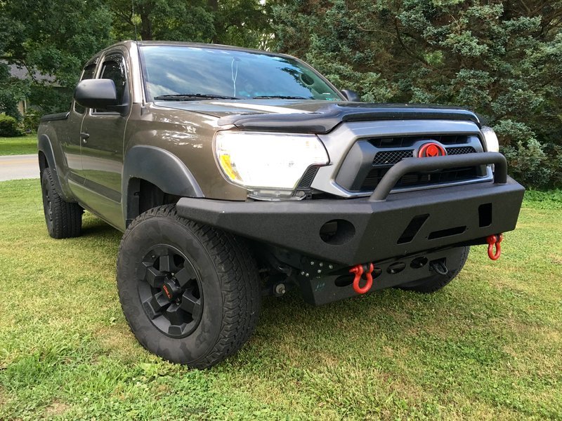

    2014 TRD Sport
    Cheap ebay bumper, plus others
    What a fucking pain in the ass. I got it installed, not pleased but I am content. If I had to do it over I would double down and go with a name brand.
    I'll post details after getting back with the seller.

    Looks good from my house...
    ChadsPride and Donefore like this.

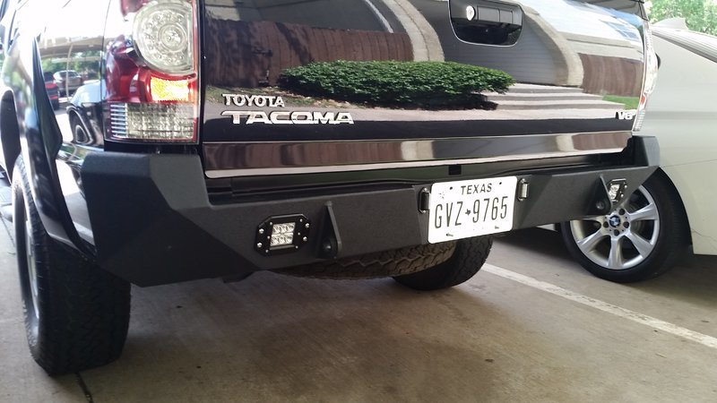

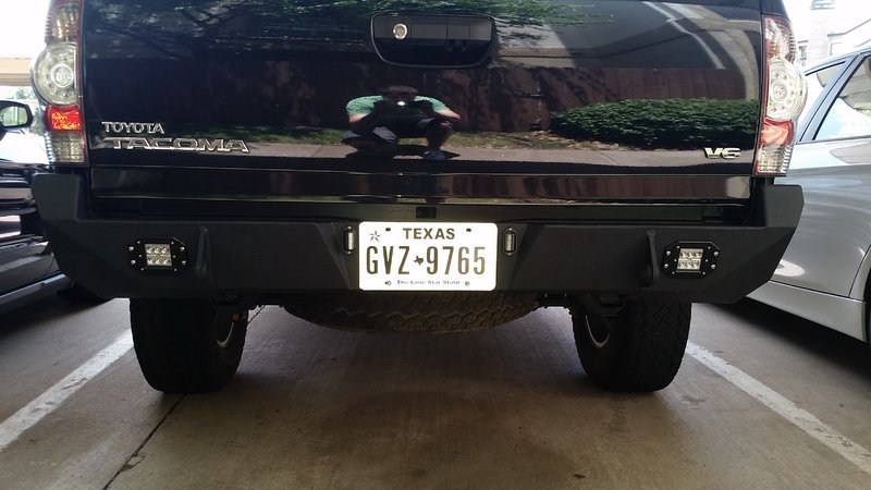

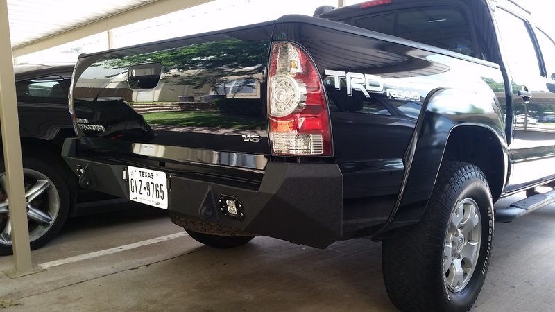

    Got my rear bumper on. no problems getting on. I have ordered the all pro hidden hitch, so when that gets in i'll see if it fits well.

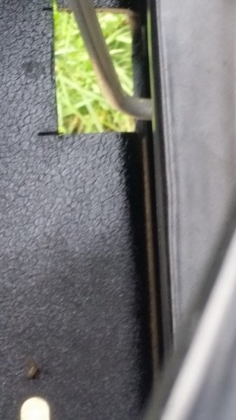

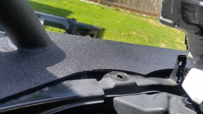

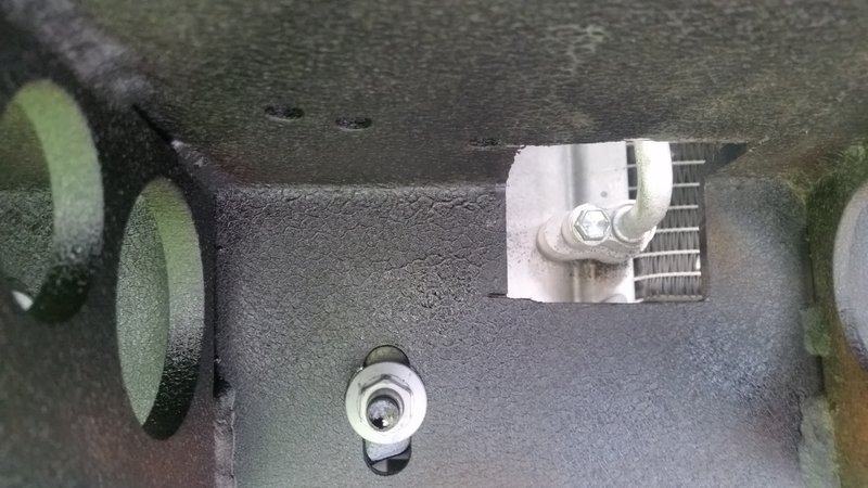

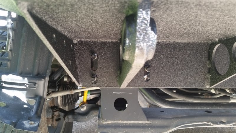

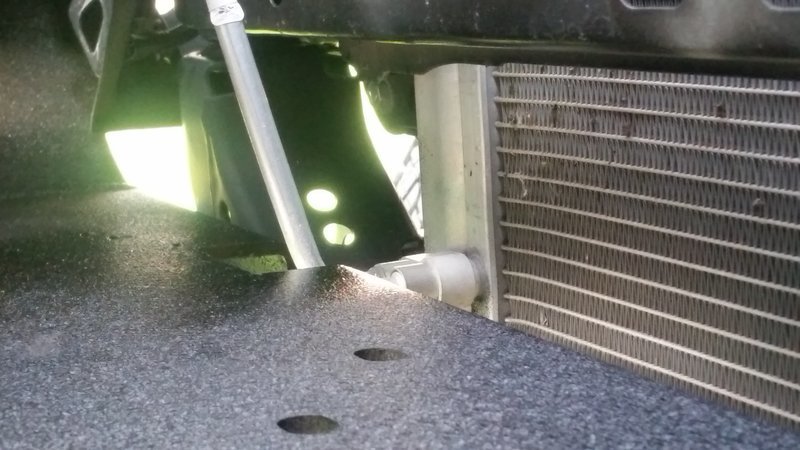

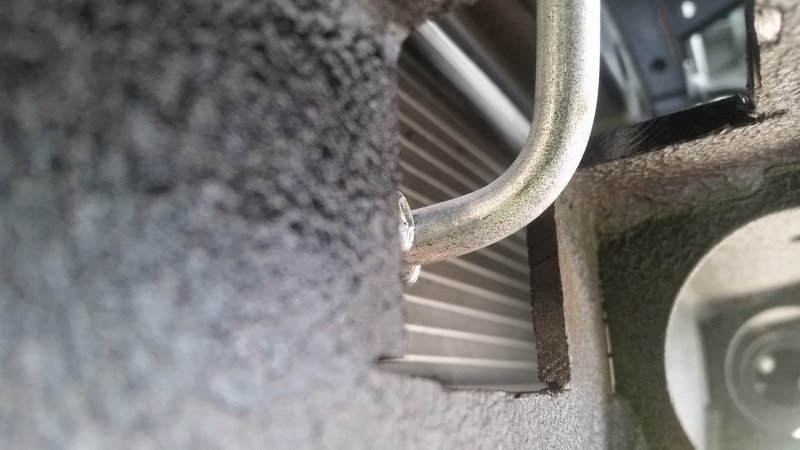

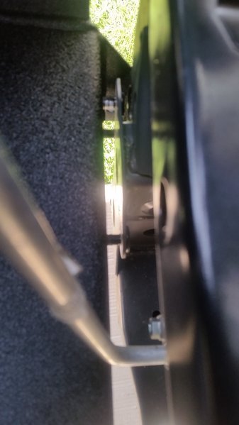

    Here is the fitment issue I had. First 2 images shows the bumper in place and the interference of the line. The 2nd picture shows there was no dropping it down to clear, and the first shows it would take a 1/2" spacer to clear by spacing. Wasn't an option, the bumper actually raised further whenmounted. Other pictures just show the cutout and how much clearance was needed. I cut it wider incase I ever have A/C issues I the line nut can be accessed without removing the bumper. I'll make a dust covdr and drill and tap some holes so it can be removed. Mainly to keep road debris from piercing the line.
    20160709_155420.jpg 20160709_155518.jpg 20160709_180114.jpg 20160709_180253.jpg 20160709_180329.jpg
    Danny72, Donefore, 5 Lug Fury and 4 others like this.

    So, basically @14 Tacoma, what you had going on that you didn't like was the bumper was spaced too far away from the truck and when you tried to make it sit closer, you encountered other problems as well?
    Got news for you, that's the way they fit. Look at pelfrey's, SOS, and about every bumper is set and there is a gap between the grill and bumper, as well as not being completely tight to the fenders. So it fit properly, just you wanted it to be REALLY close to grill and fenders. Go out wheeling and you'll figure out why they weren't such a close fit.

    I just wonder ehat the AC line looks like in others. Hopefully those that have installed checked the clearance. Last thing you want is a hole rubbed in the high pressure line.

    Um no, the bumper would not go low enough, see first two pictures. I would have had to elongate all the slots probably a 1/2 inch and remove the bracing that extends the length of the front end below the headlights.
    I appreciate your insight, just not your insinuation of my intentions.20160709_155428.jpg

    My Ac line just touched with no spacers, I was able to make a small 1 inch v cut on the bend and have plenty of clearance. The line doesn't even go through the bumper, I could easily have made a small plate to cover the cut. My issue is my left to right, looks like the passenger side doesn't sit back as far as driver side. I'm prob going to have to space the one side 1/4 inch to level it out. I am going to try and grab some pics and post.

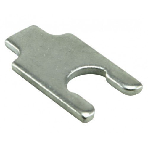

    I was hoping for a way to shim, thought maybe I missed something the first go around.
    If I could shim and wasn't going to make a one piece shim I was going to use shims for alignments on older cars and trucks. They also use them for shimming body panels. Don't have to take the bumper off for washers. Pretty cheap at auto stores and have varying thicknesses.
