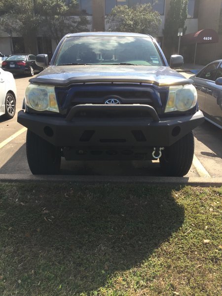

    Well, I've gotten mine in, it's well made.
    Very heavy and it has nice weld lines.
    It seems rather sturdy and robust.
    However the nuts and bolts seem rather average, those are getting replaced.
    The coating has a very odd slick feel to it.
    It's very good at resisting abrasions but cuts easy with a knife. It's has a different composition than any other coating I've felt.
    Maybe it IS lead-based... lolz

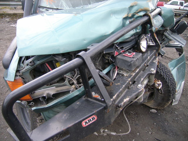

    This guy actually expected us to believe he fucked up an ARB bumper? The ARB demolishes both parties of an accident while Australians chuckle at the evil they're created.

    i did the same thing too. Grade 8 hardware for the sides, and metric 10.9 nuts for the front 6

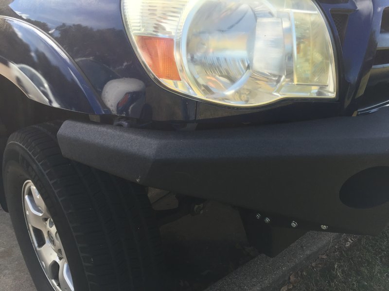

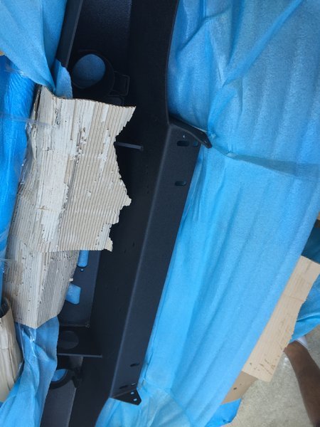

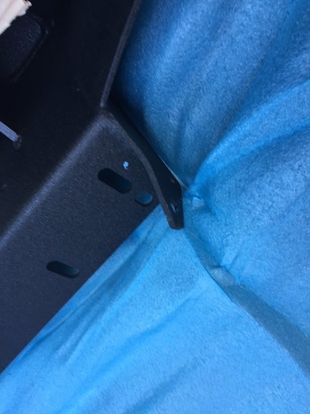

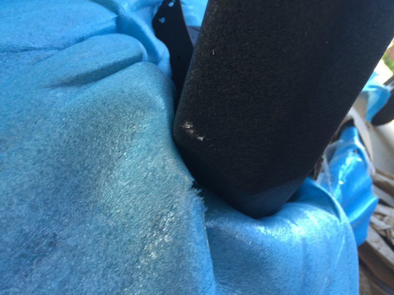

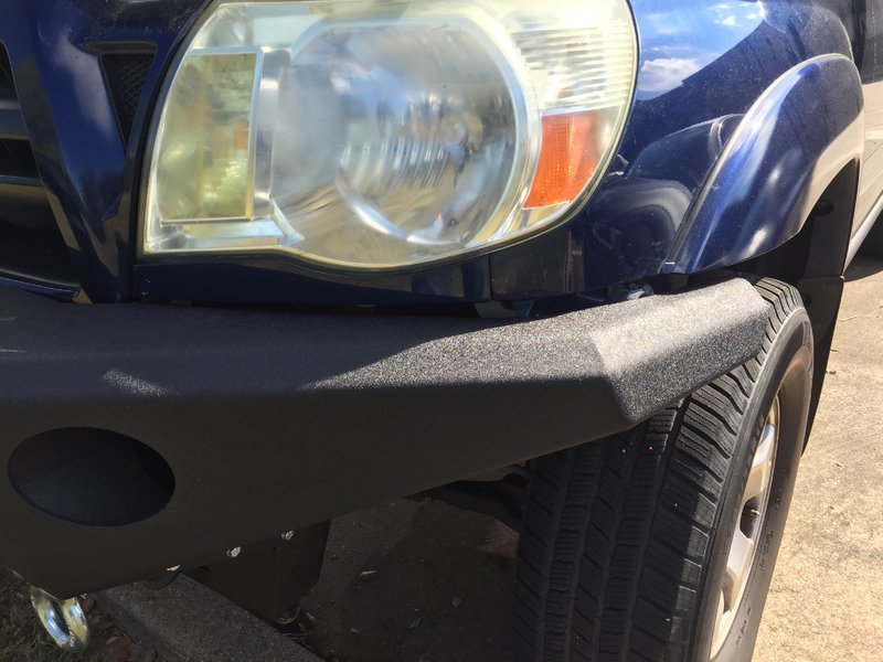

    I purchased this a couple of weeks ago directly from the seller for a 5% off for $568 shipped.
    Open it over the weekend I open it up and one of the bracket was bent from shipping. I hammered it back in placed. Also slight blemish on one corner due to shipping.
    The mount takes at least 3 people to install since it so heavy. It didn't come with any instructions. Took us 2 hours to install and another 2 hours to troubleshoot. (details later). You literally take off all bumper components and skid plates. The bumper mounts onto your sway bar bolts. You will have to cut both fender well plastic covers.
    After the install, it was flush on driver side and and off about 1 in. on passenger side. During the troubleshooting process, we loosen every single bolt and tried to flush passenger side. In the end, both side is now open about 1/2 in.
    On another note, I broke the welded nut in the box frame for the sway bar bolt. So it's just sitting loose right now. I been reading some threads about this and one member had a welder to weld it back on, another member mention to cut the bolt, and drill another hole on top of box frame and put a 5 1/2 in bolt through.
    Overall, the installation was hard and the bumper is not flushed. I wouldn't recommend this product.
