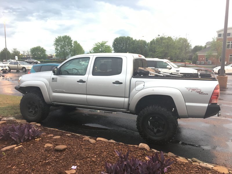

    The rear bumper is pretty solid and fitment is good. I'm happy with it for the money.

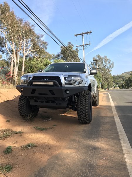

    So does this mod delete the stock skid plate? Does it make the undercarriage vulnerable? Pictures? I just got mine yesterday

    I had to remove the skid...you have to remove it

    Yes it does....which is why I bought a pelfreybilt IFS skid....unfortunately I do t have a pic...but it looks pretty damn exposed
