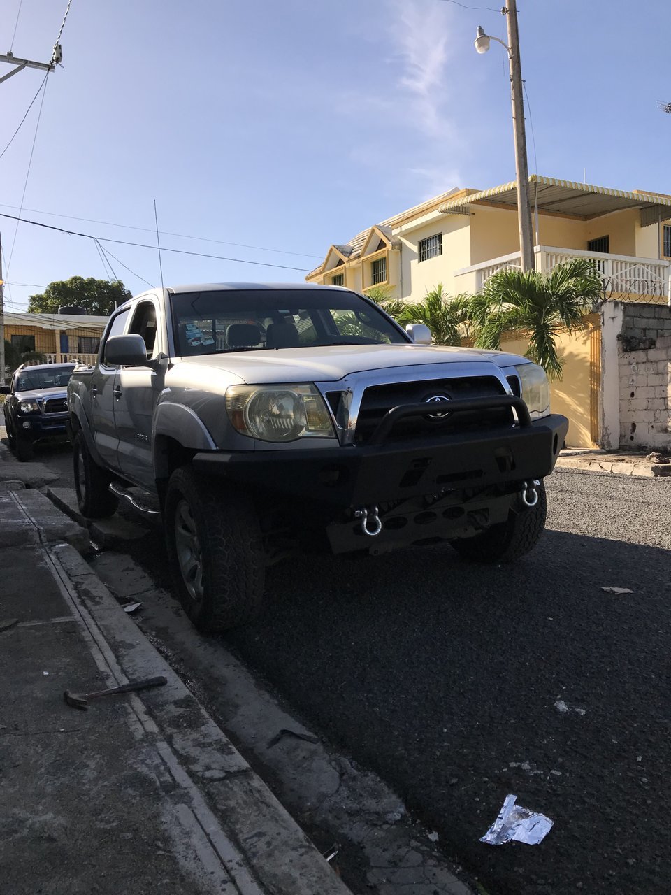

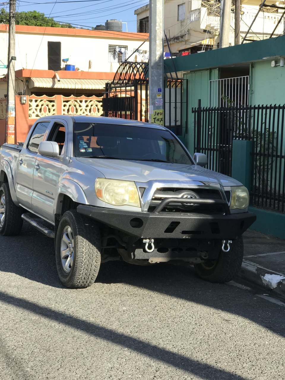

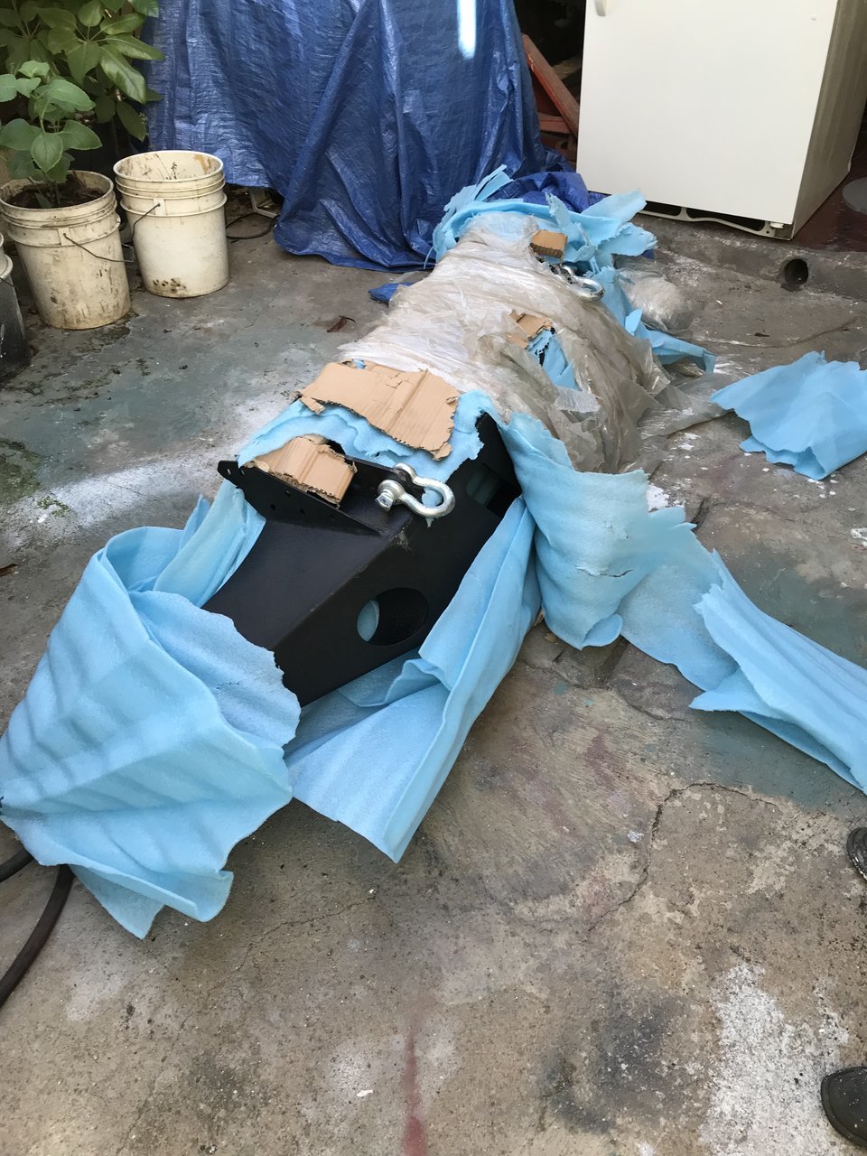

    9FDA2C6E-93EE-438B-A7FB-EDC353A2659C.jpg E38A0A69-7553-4F08-9F3A-BA1FCD84268A.jpg Arrived

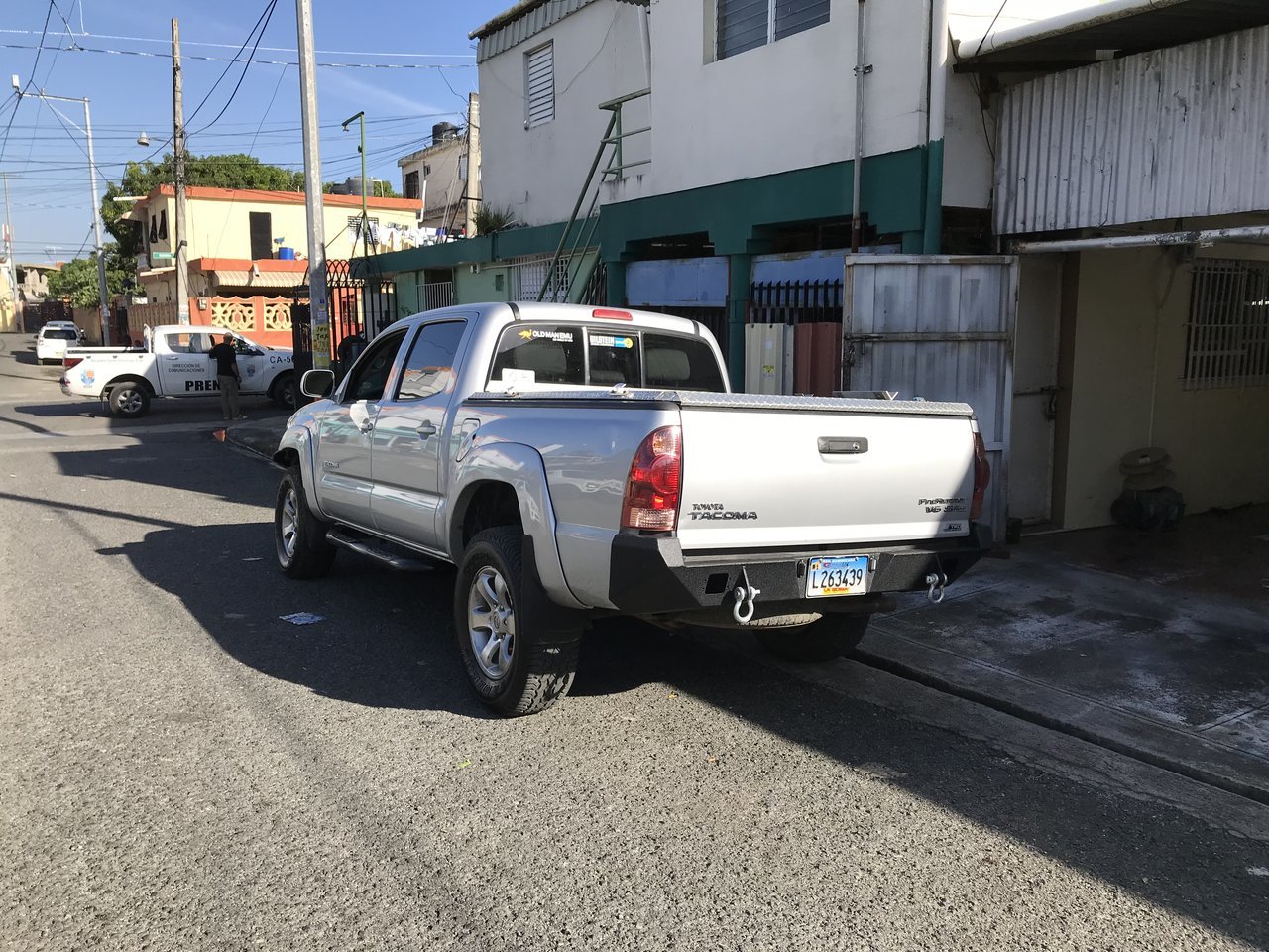

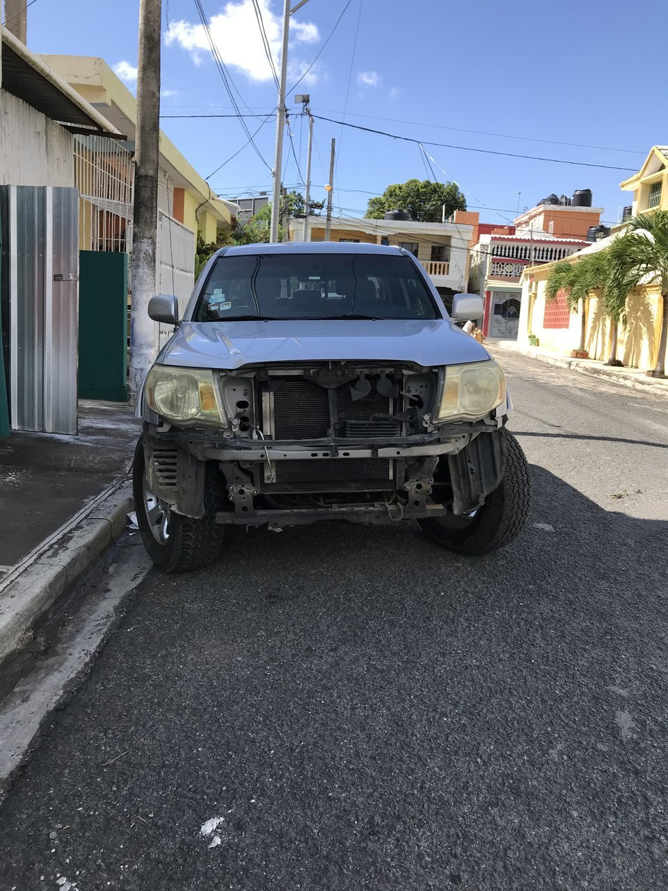

  2. Dec 9, 2017 at 12:11 PM
    #5922
    libagui
    libagui Well-Known Member
    Feb 16, 2009
    #13689
    594
    Dominican Republic
    05 tacoma prerunner
    Bilsteins 5100 set at .085 Rear custom 1" add a leaf 265/70 R17 tires. Custom made aluminum tonneau cover with bike rack. 4x4 conversion with 4Runner transfer case.

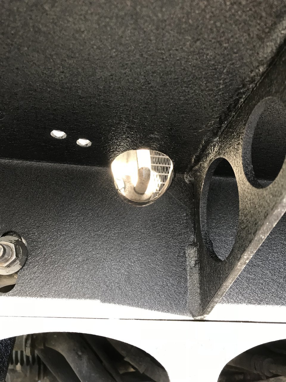

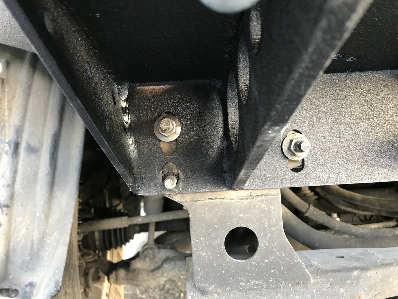

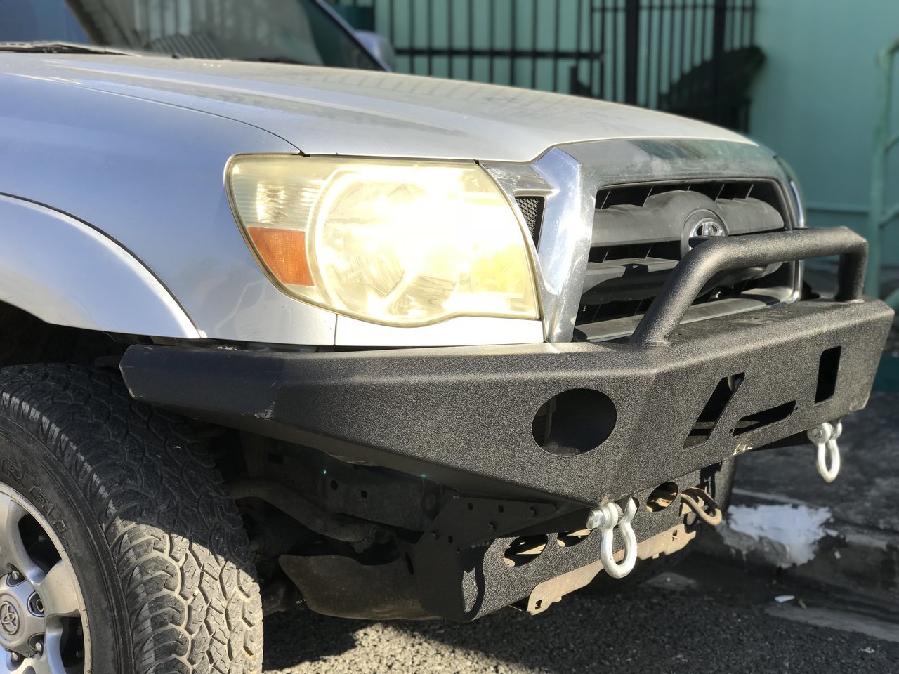

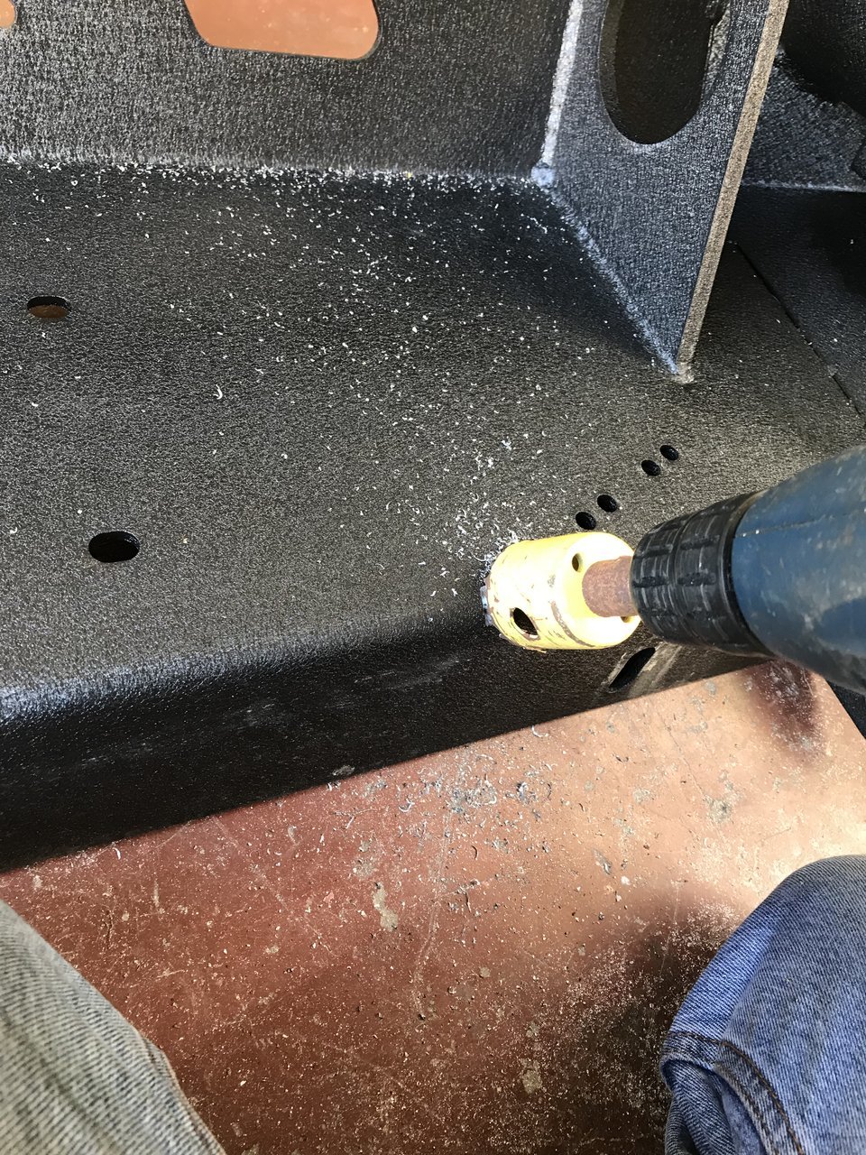

    9AEC0155-5FF1-4972-AD8D-91BF353C3A92.jpg E2AAD9F2-5274-41A3-9FAF-72D814A8A7D0.jpg C5550774-B779-4B3C-8BF2-8595980B313A.jpg A9E0E0A0-3507-4FD0-B36E-3553EC369786.jpg C0549D4E-23B8-4E24-9B9B-19B2585521CF.jpg F02EE3AC-27F9-414E-8213-F6F0702913A8.jpg 2B816B3A-181A-458D-BEBF-5FD76D645AEE.jpg B84EFE64-E82A-4497-AC5F-E6E69BB52EBA.jpg E51F8159-891C-4AAF-AC14-7EC81520288A.jpg Installed, Had to drill a hole to eliminated A/C pipe contact.

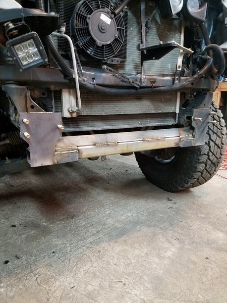

    @Sub-Zero
    Can you link me where you posted those pics of you beefing up the mounting points for this bumper? If this thing ever comes off again its gonna get plated up I just cant find where you posted pics of it. thanks

    @MurderedTacoV2 I welded 1/4" plate to the existing mounts and replaced the stock hardware with 1/2" grade 8 bolts tacked on the back side

    Thanks man, so it is relatively similar to what SOSconcepts offers for their beef up kit? And you just added that extra few pieces of 1/4 in a few spots for extra strength right?

    Yea, we reinforced the cross member with angle too....the side wings that tie into the frame are a good idea too

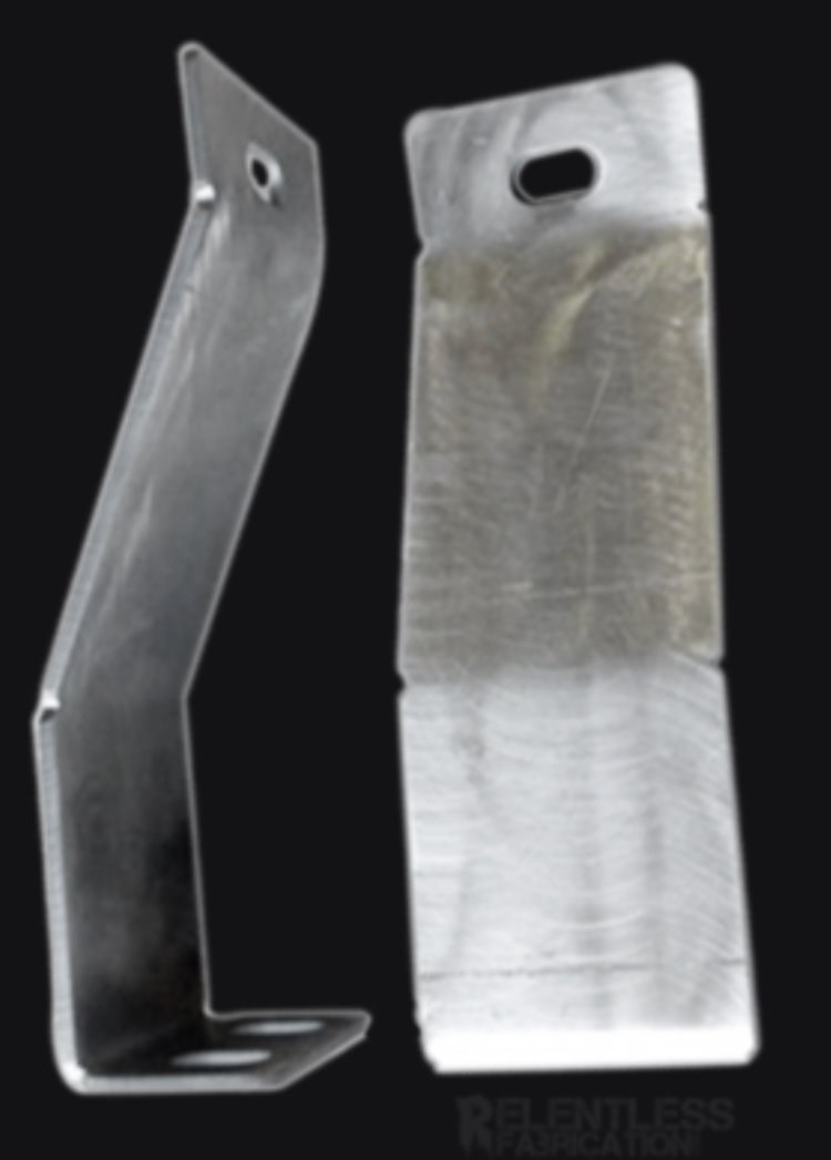

    Will those even work with this bumper? I looked at some brackets but the supports look to be in the way
    Relentless fab brackets

    No idea, never looked into them, I'll be making my own
    Impulse05Taco[QUOTED] likes this.

    Don’t those supports go behind the Bumper?
  17. Dec 12, 2017 at 10:39 AM
    #5937
    EatSleepTacos
    Mar 24, 2015
    #151688
    59,841
    Randy
    West Valley, AZ
    2017 4Runner
    They’re supposed to go over the bumper and mounts to provide reinforcement.
    Backcountry chef likes this.
