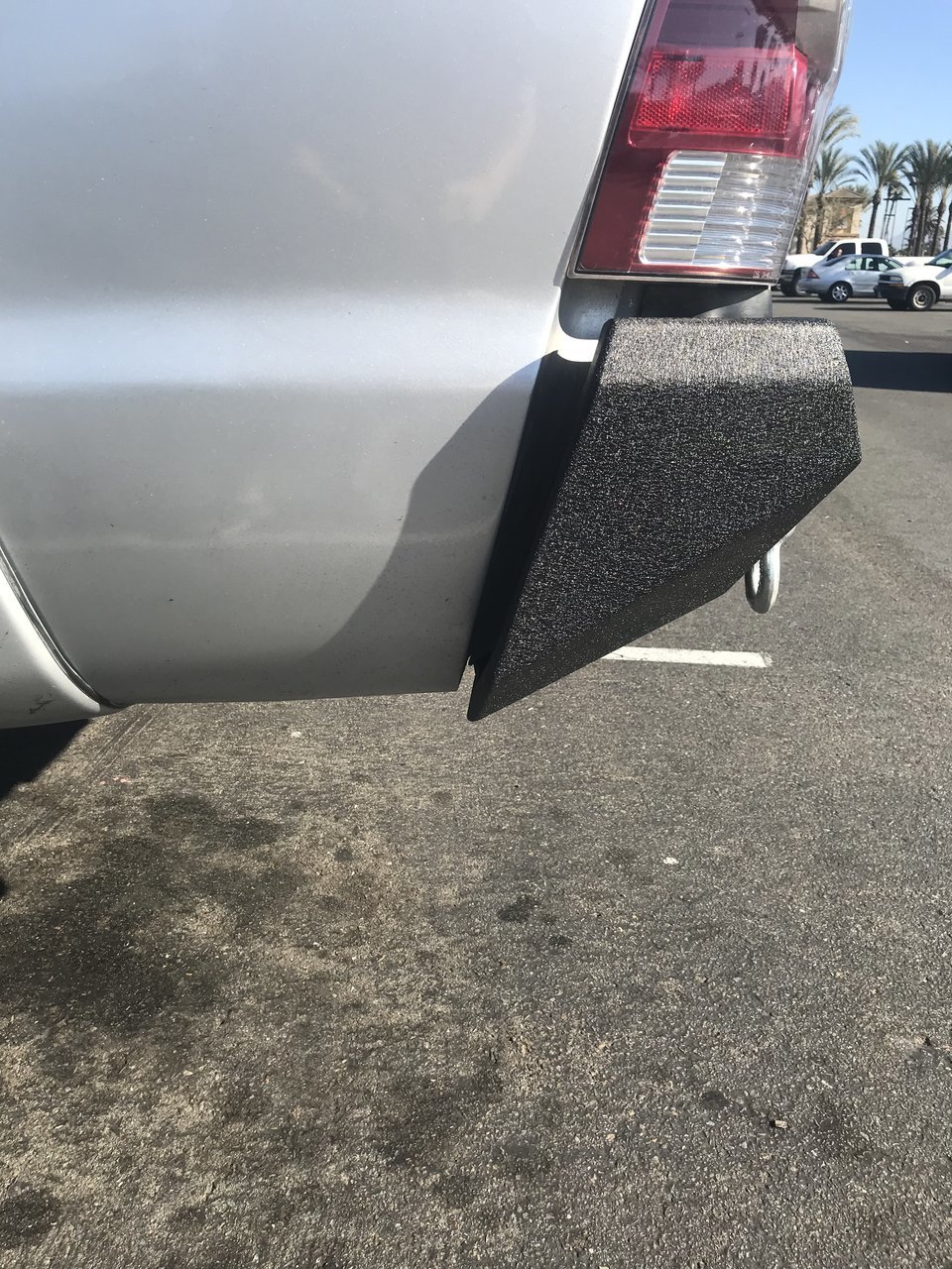

    More often than not, the rear bumpers I've seen, except high clearance rears, aren't perfectly even to the bedside under the tail lights. I've talked about this with many people, often. Some say it bothers them, others don't want to fool with such OCD.
    I have a Fab Fours rear, not the fugly one, the simple one. And it's not perfect, but I haven't adjusted it since my 10yr old cousin helped me mount it :D

    Yep…

    Not bad at all. Mines suppose to be here the 13th.

    I’m very happy with it

    That looks better than the pic I posted from their eBay ad. Thanks!

    Yeah I’m very happy with the fit! Bumper bolted up perfectly

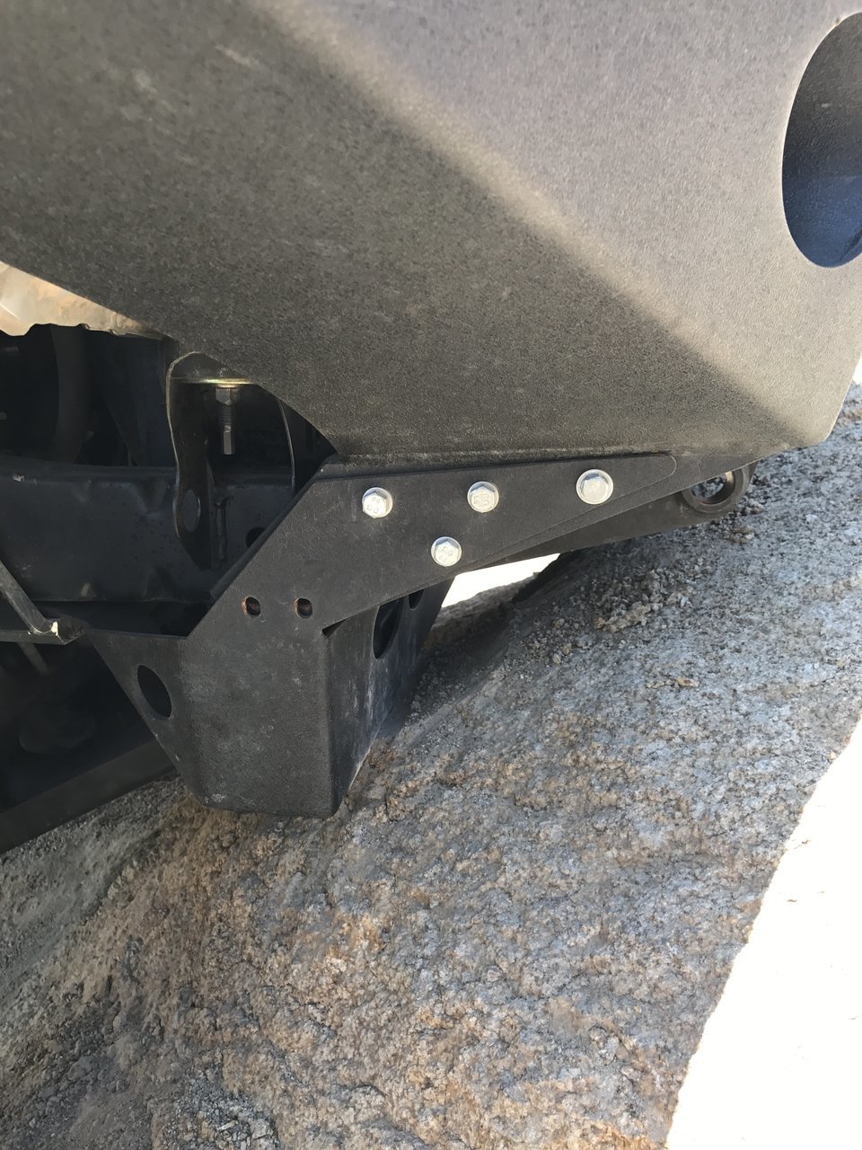

    Can anyone post a picture of how the second piece for the front bumper bolts up? I can’t figure out how I would route the brackets to attach at the sway bar location. Picture for your time (;

    You have to loosen and remove the sway bar bushings. The bumper goes under the bushings, the second part of the bumper is sandwiched between the frame and bushings. They are labeled left and right for future reference lol. Put the heavy peice of the bumper on first.

    My sway bar is already disconnected. I just cant figure out it’s supposed to sit right where the 4 blots on the bottom bracket can attach, and so can the side ones that go to the bumper.

    The metal bar on the bottom is what is causing me not to be able to get the bottom piece on. The width of the metal piece is bigger than the width of the bumper piece, so it can’t sit inside of it. Idk Looks simple but not workin out for me
