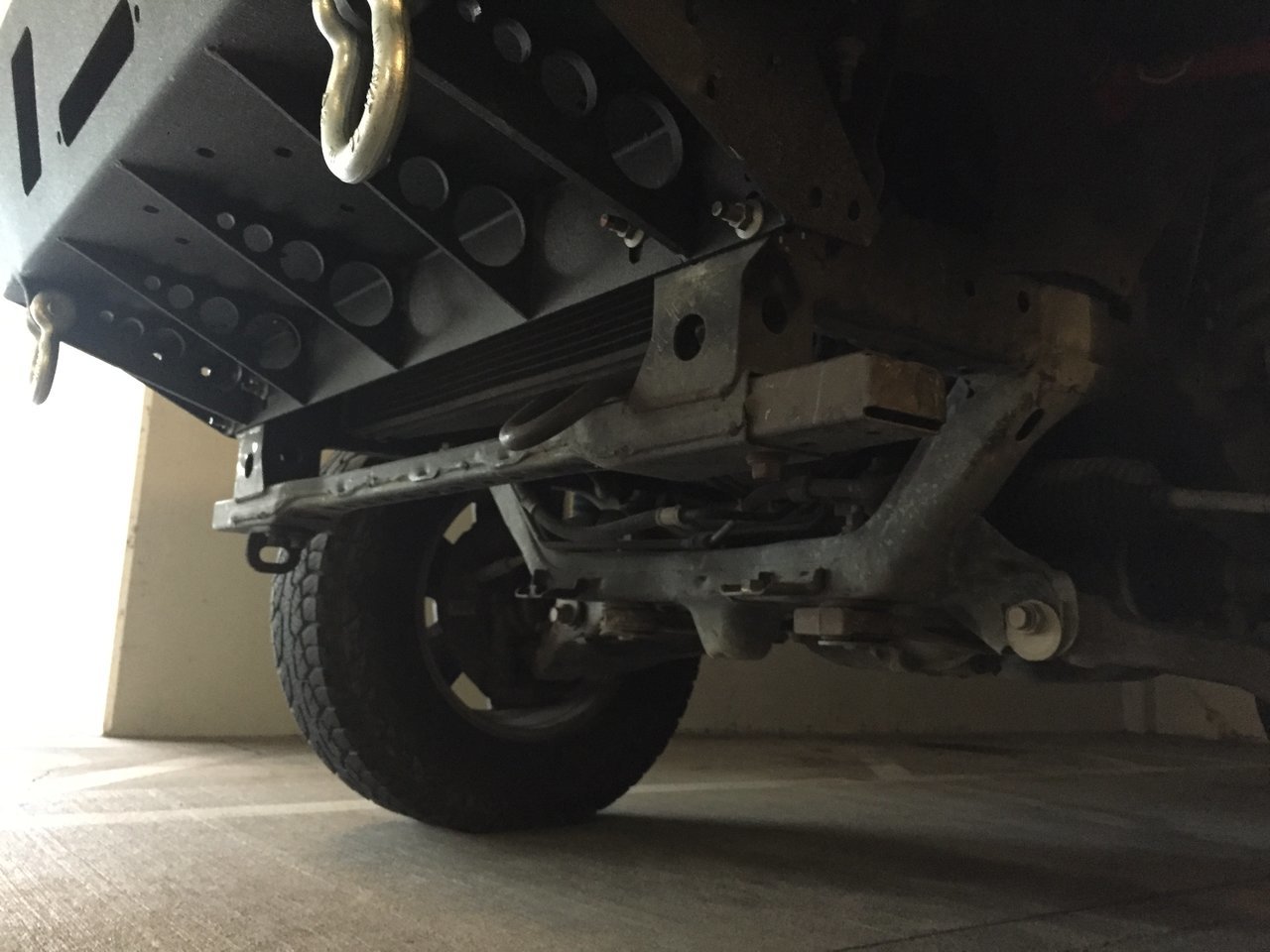

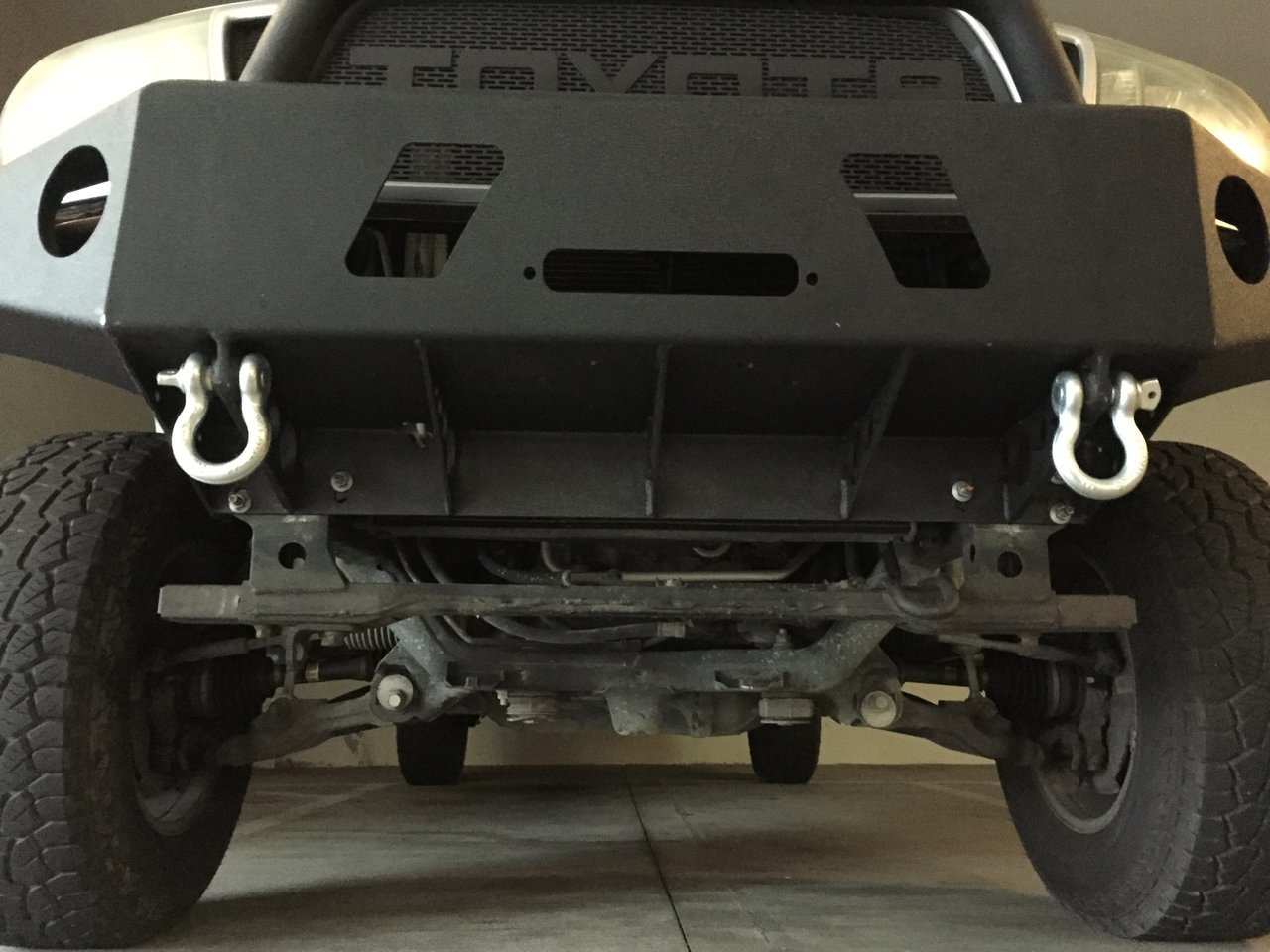

    You could try removing the end pieces. Just undo the bolt

    I feel so dumb... Thank you for the help. I was about to take an angle grinder to that piece!

    You have to remove that lol
    I cut mine and slid it back in so I could have two extra bolts holding the bumper on

    Ah just for extra support? Think it helps and is worth doing?

    If you have a winch yeah. It only takes a minute so it was worth it for me

    Got it, thanks! so by removing those two end pieces, the lower part for the bumper fits up?

    Yes

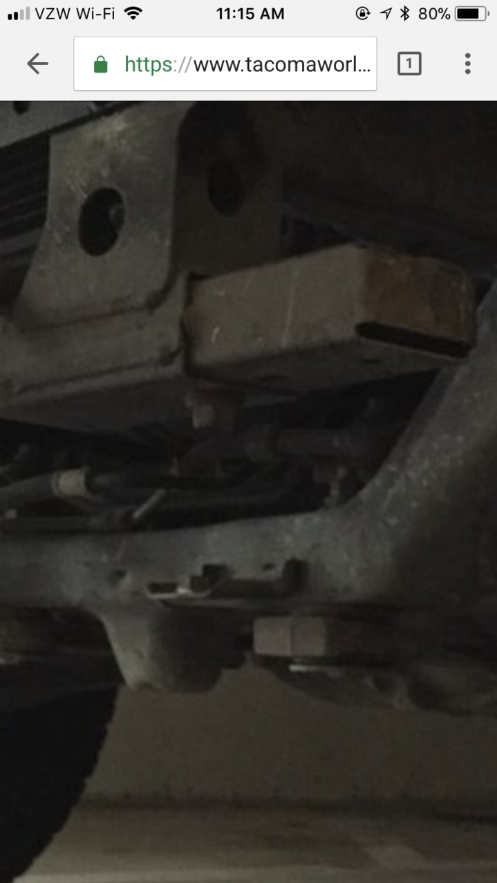

    can you take a pic of how you cut and slid it in?

    I can’t because that would involve removing the entire lower support.
    Just simply cut it so it doesn’t stick out past the cross member
    Leave it slide in while you bolt up the lower portion then re install the bolts
