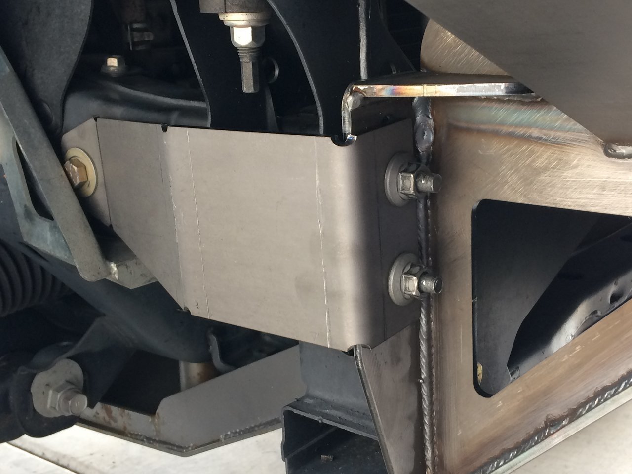

    I guess I am a little confused as to what exactly would need to be done. Do you have to drill new holes? Or are they already there. Does there bumper mount to the sway bar? Sorry for sounding like a rah tard, just not very mechanically inclined.

    Because the stock mounts are very thin and weak
    You would need to do welding and grinding/drilling to install the plates

    He is referring to modifying the second lower part of the bumper. There are two parts, one that mounts to the crash bar bolts on the frame rails, and the sexond piece mounts under the sway bar and is bolted to the top by like 12 bolts. Yes it mounts under the sway bar bolts, yes you will have to bend/grind out the holes THAT ARE ALREADY THERE. Everything you need is there besides these fancy reinforcing plates we are speaking of now.

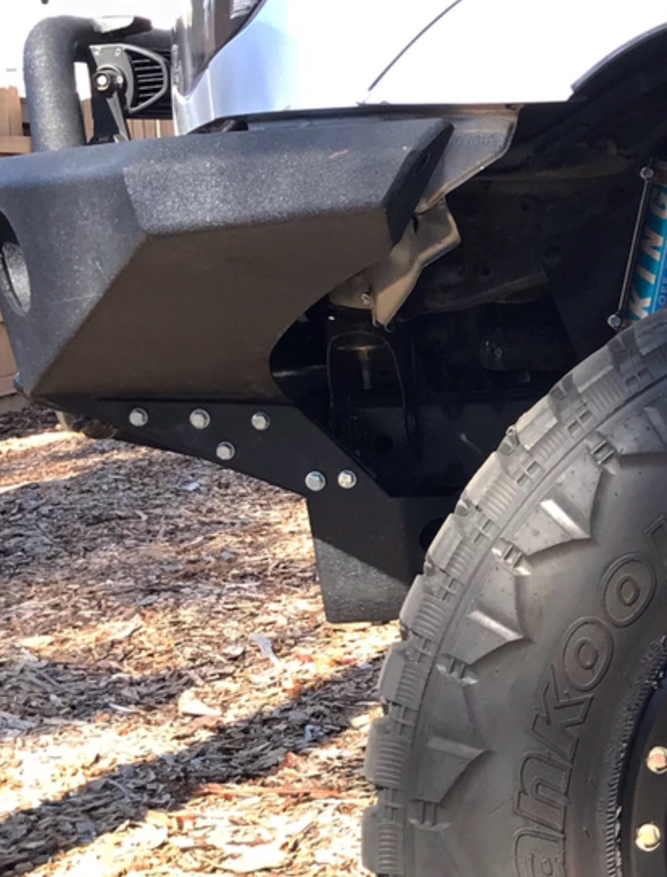

    Because of the design of this Bumper

    Yo he can make that work. Cutoff wheel a slot right into the bumper and hammer it through.

    Would be a major pain. Easier to upgrade the mounts
