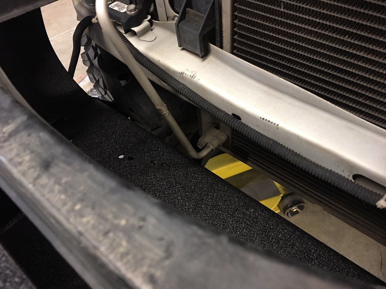

    AC Line modification NOT needed w/ 1" Body Lift. It's hard to see but there is a 1/2" gap between bumper and line

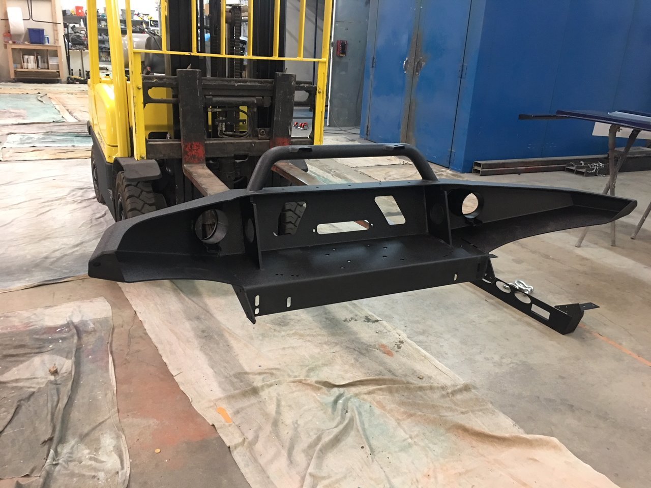

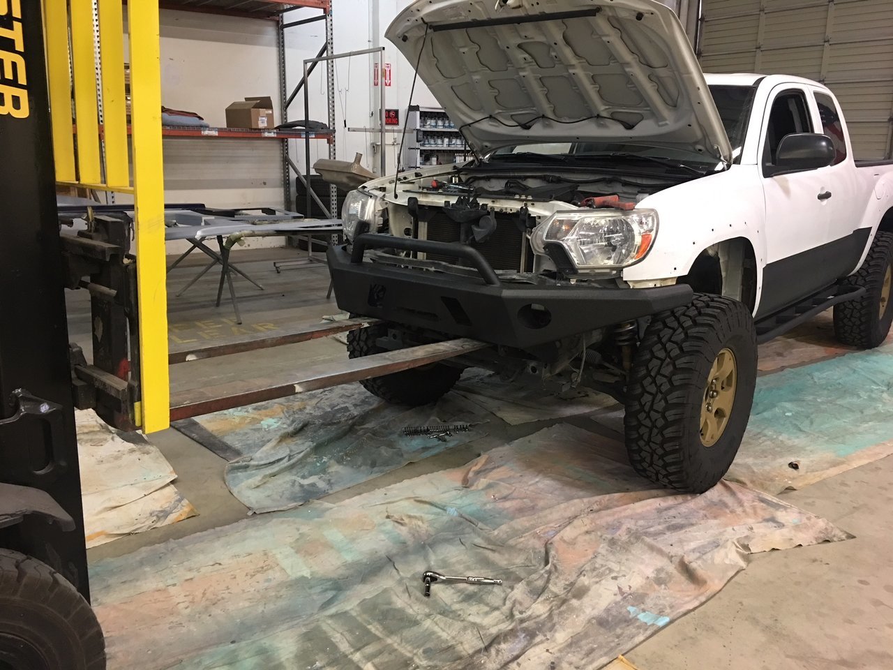

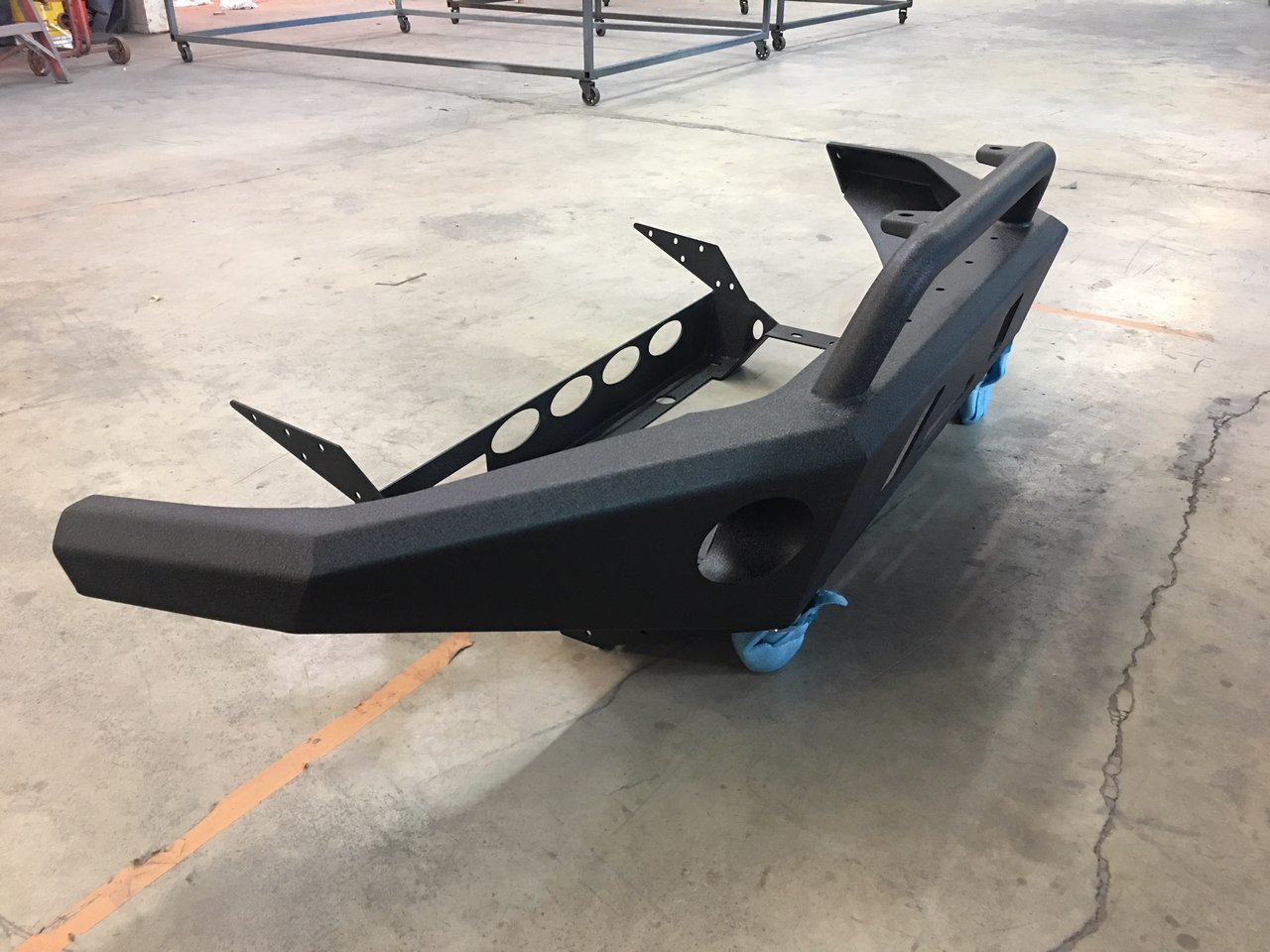

    Undamaged - derrr, that's what you get for Will Call.
    Also, the bumper is around 100 or so Lbs. I don't have a scale but screw picking it up by hand..... The Hyster is always nice to use, especially when you need to suspend it for fitment....

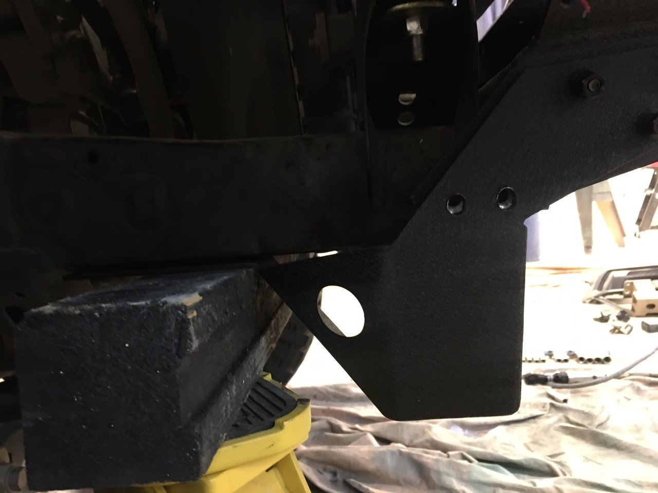

    The only parts that didn't bolt up 100%. Easy fix, took a 4x4 and a jack - pressed it up to "form" against the frame rails and then egged the holes to accommodate the holes. Eventually, once I remove to weld the KORS reinforcement plate; I'll be upgrading the bolts and re-reaming them out.

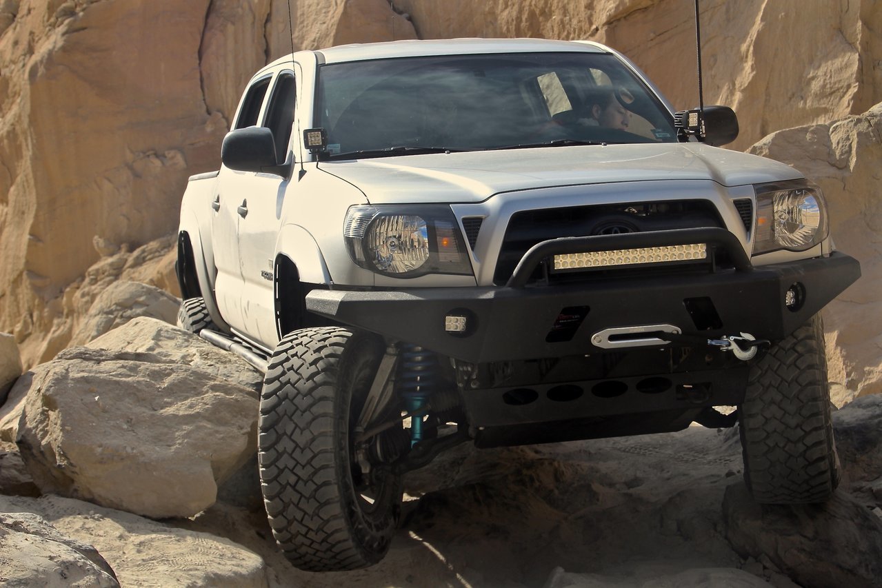

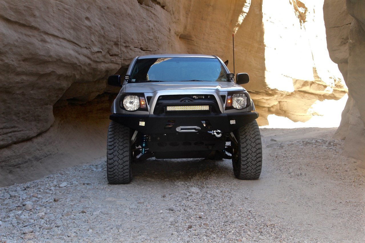

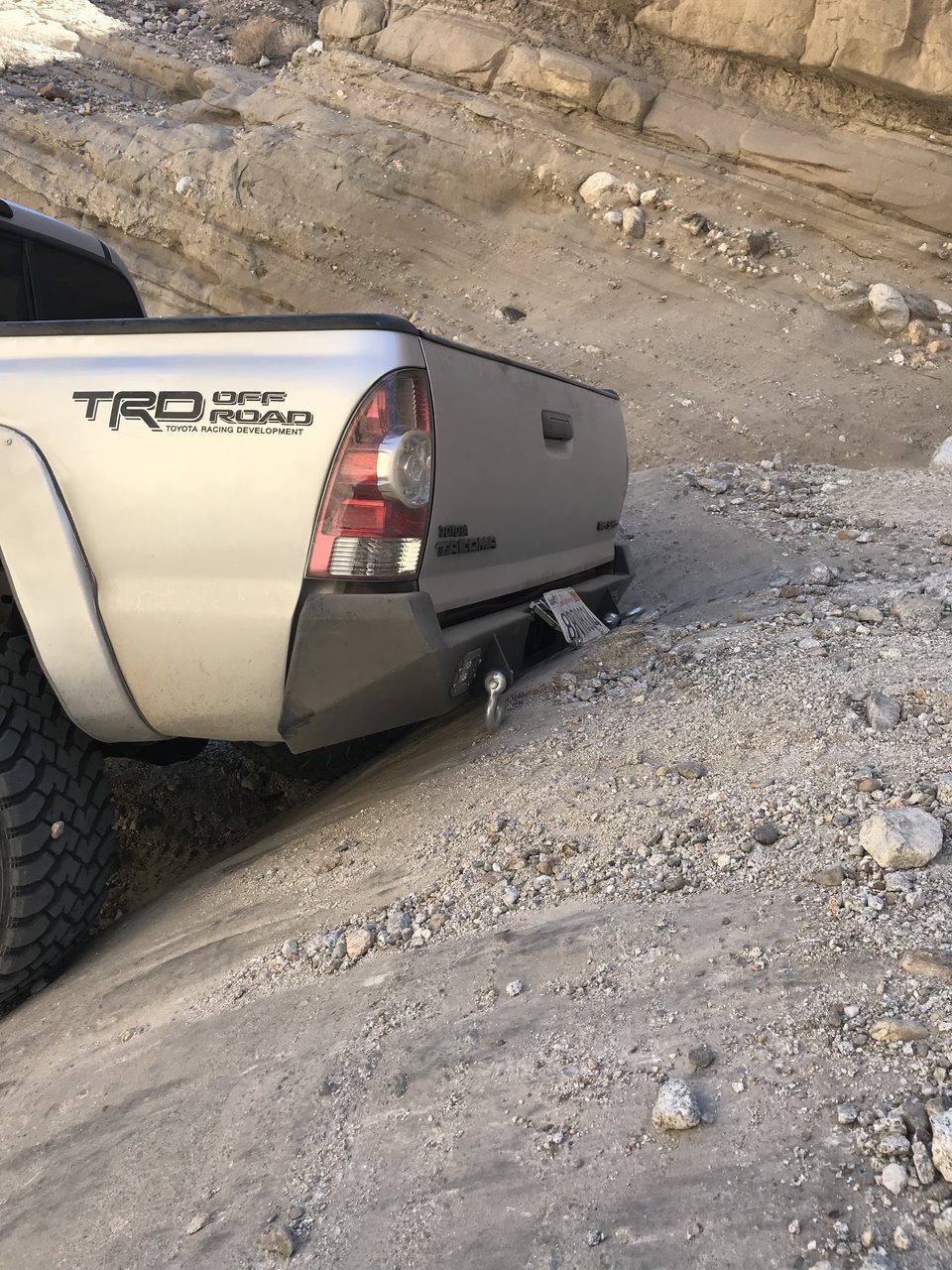

    Any square pod fits
    21” bar
    Bumpers taking a beating
    C9AC15AA-5D28-49A9-B48E-F61140A47FDD.jpg CDFC1C10-B6DD-475D-A653-42A98A3153C8.jpg 04A01A63-BF63-41B0-B1F1-84D01BCBCDC5.jpg

    Great pic's! Thanks.
    Any reason to not use round LED's? I like that look better in the round holes.

    What license plate flip kit is that? Thanks.

    Just from Amazon. Don’t remember the brand

    I’m not too sure they came installed on my Bumper when I got it.
