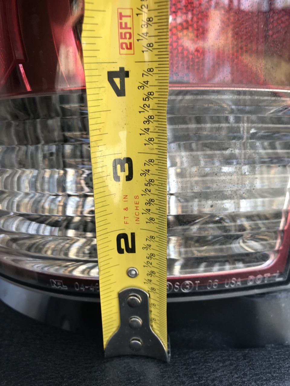

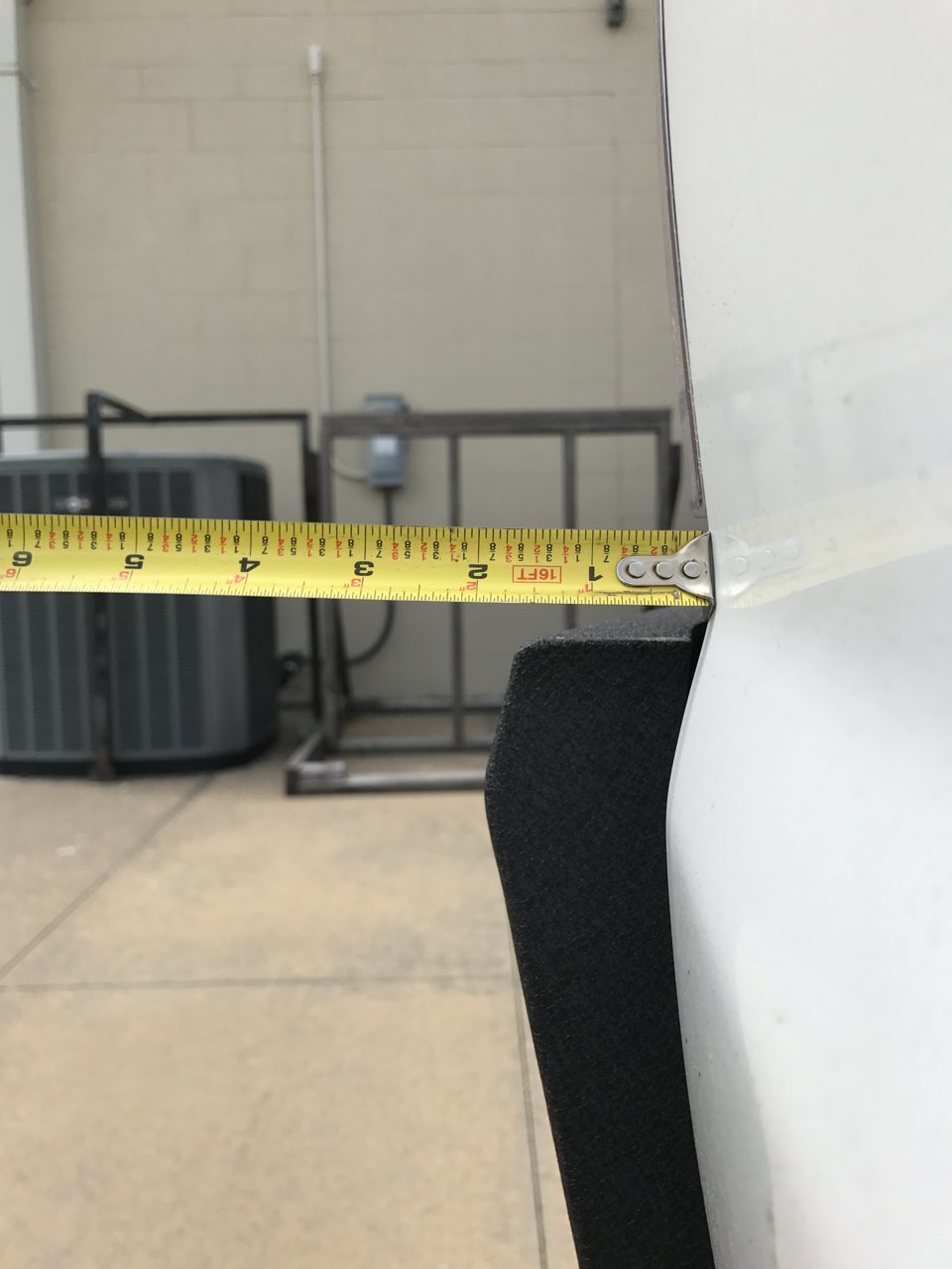

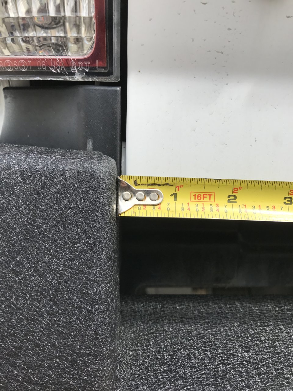

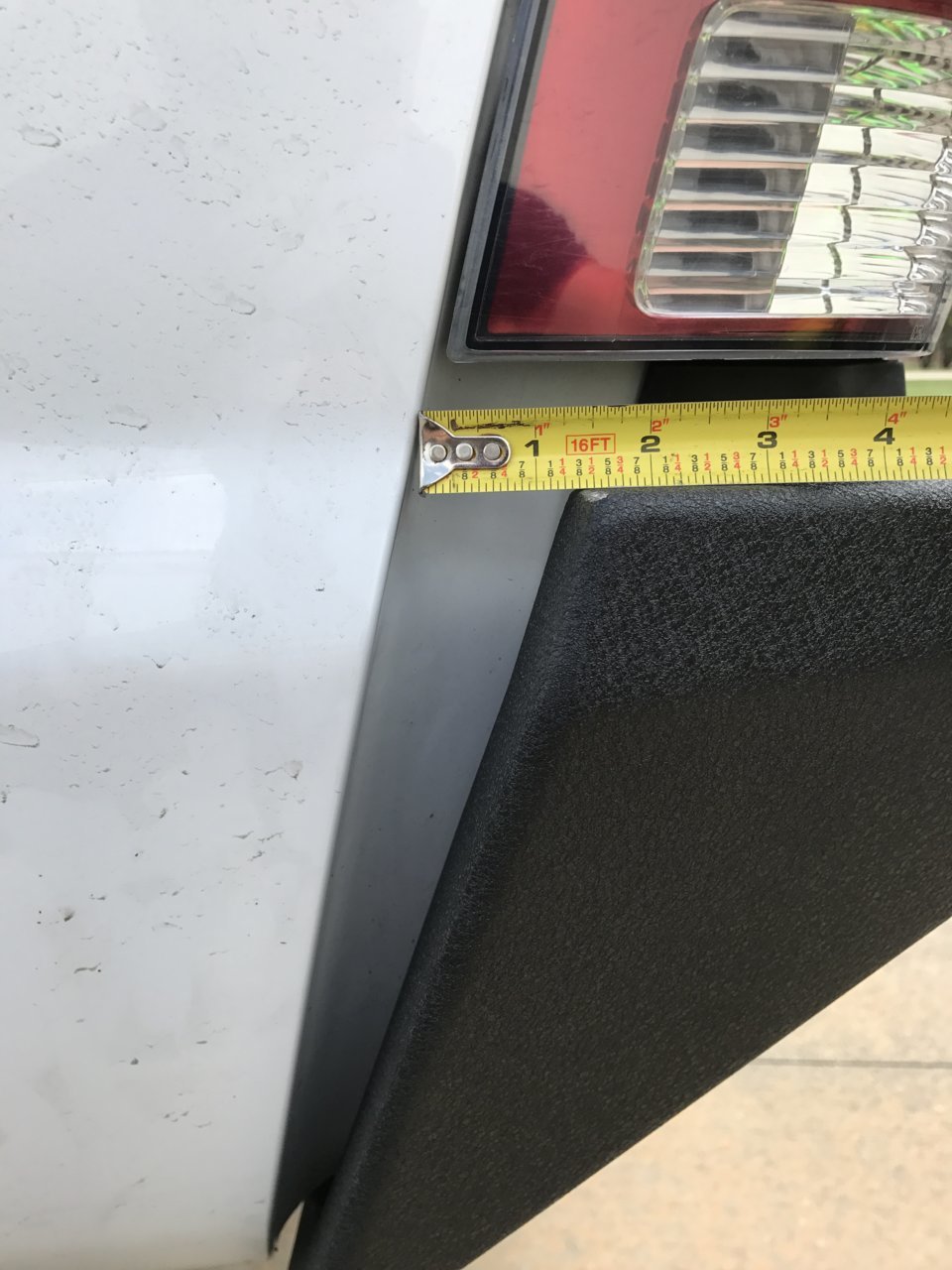

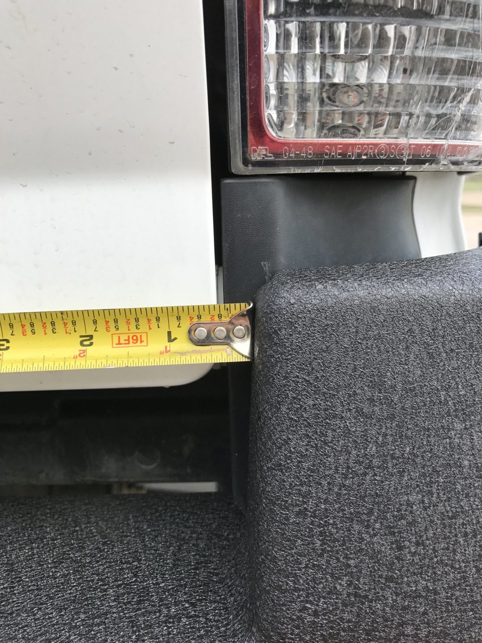

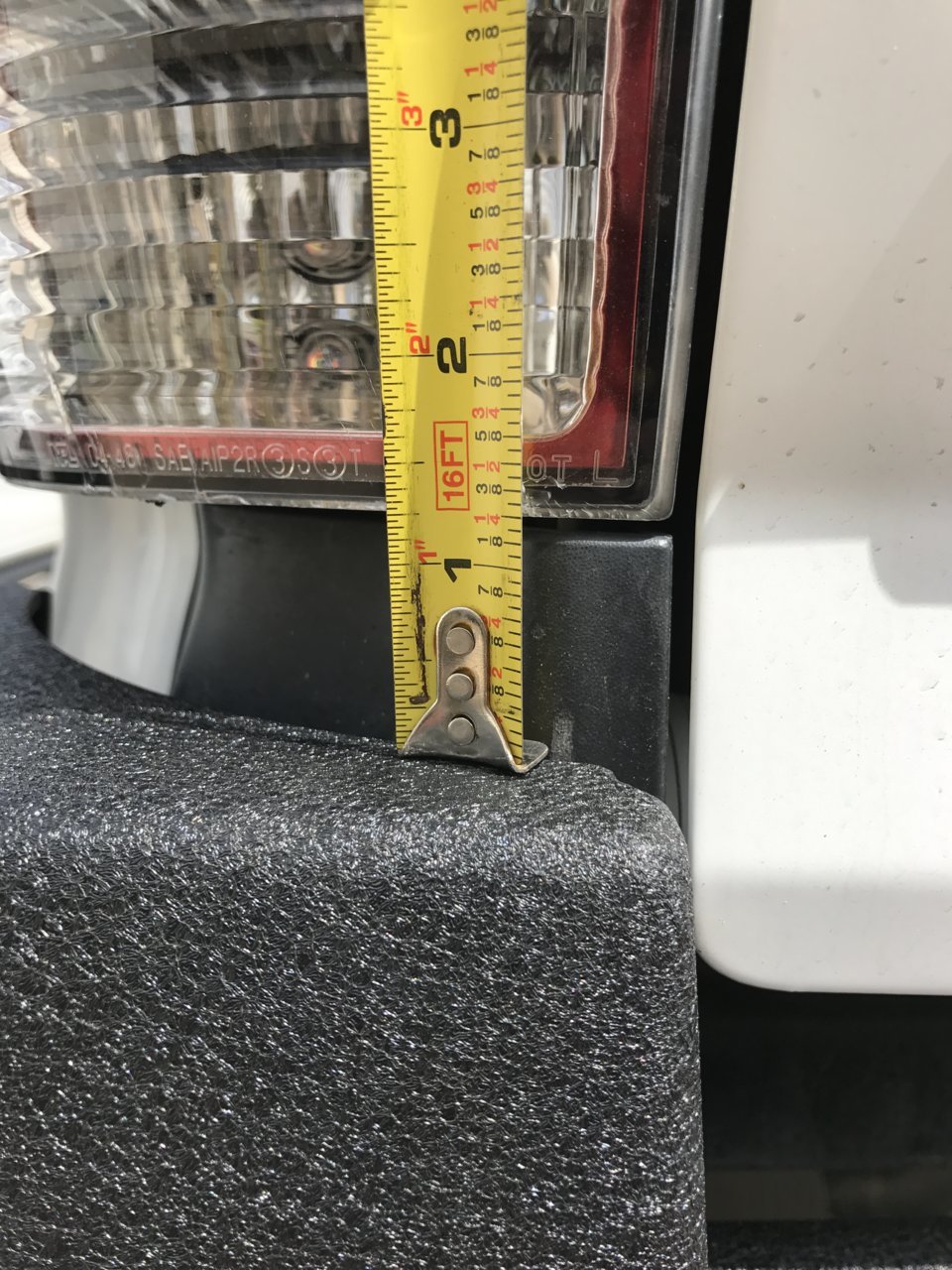

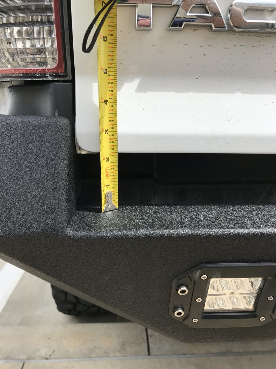

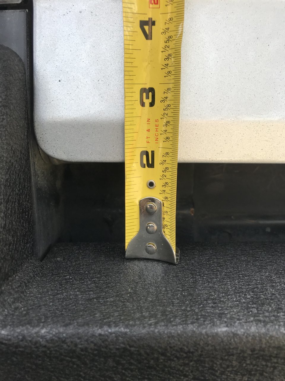

    Here are my gaps
    About 3/4” at the tail lights and 1 3/4” at the tailgate

    Yeah, that's more like stock than mine is. I talked to them today about receiving my replacement front bumper. I told them about the rear but said 'F' it and I'm just going to fix it myself. Worst case scenario, I'll weld their holes shut and drill new ones exactly where I want them. Thanks for the pics!!!

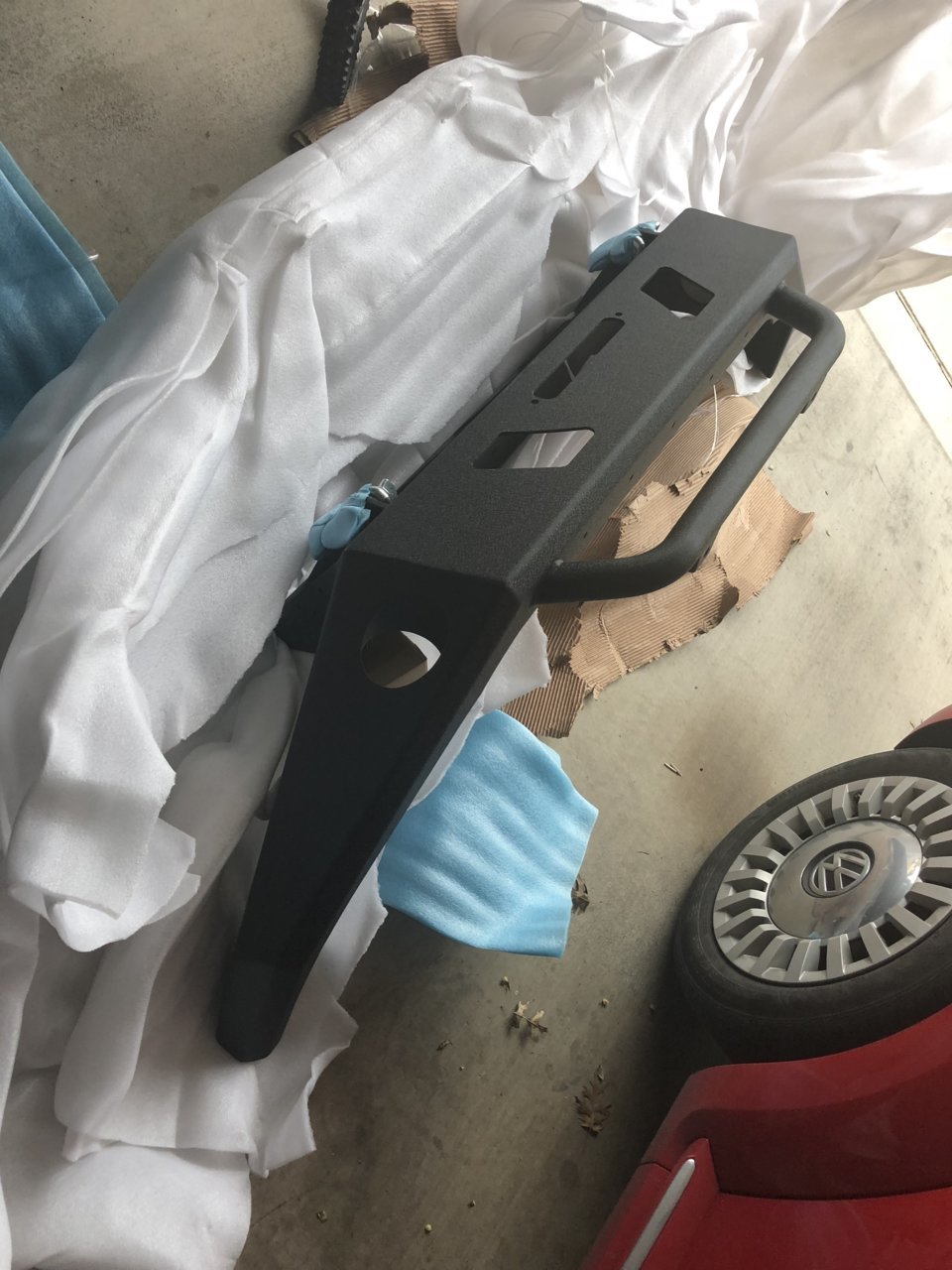

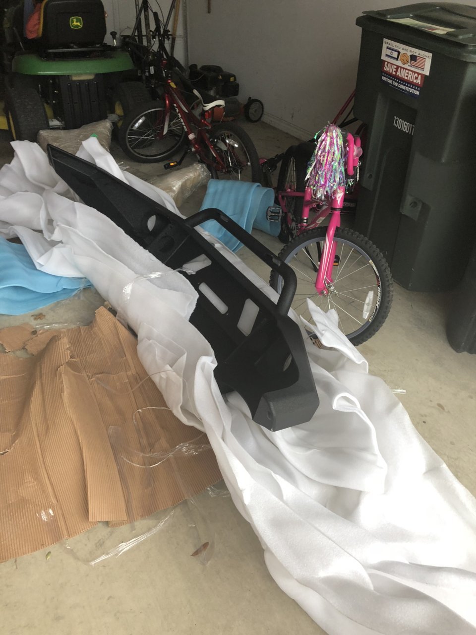

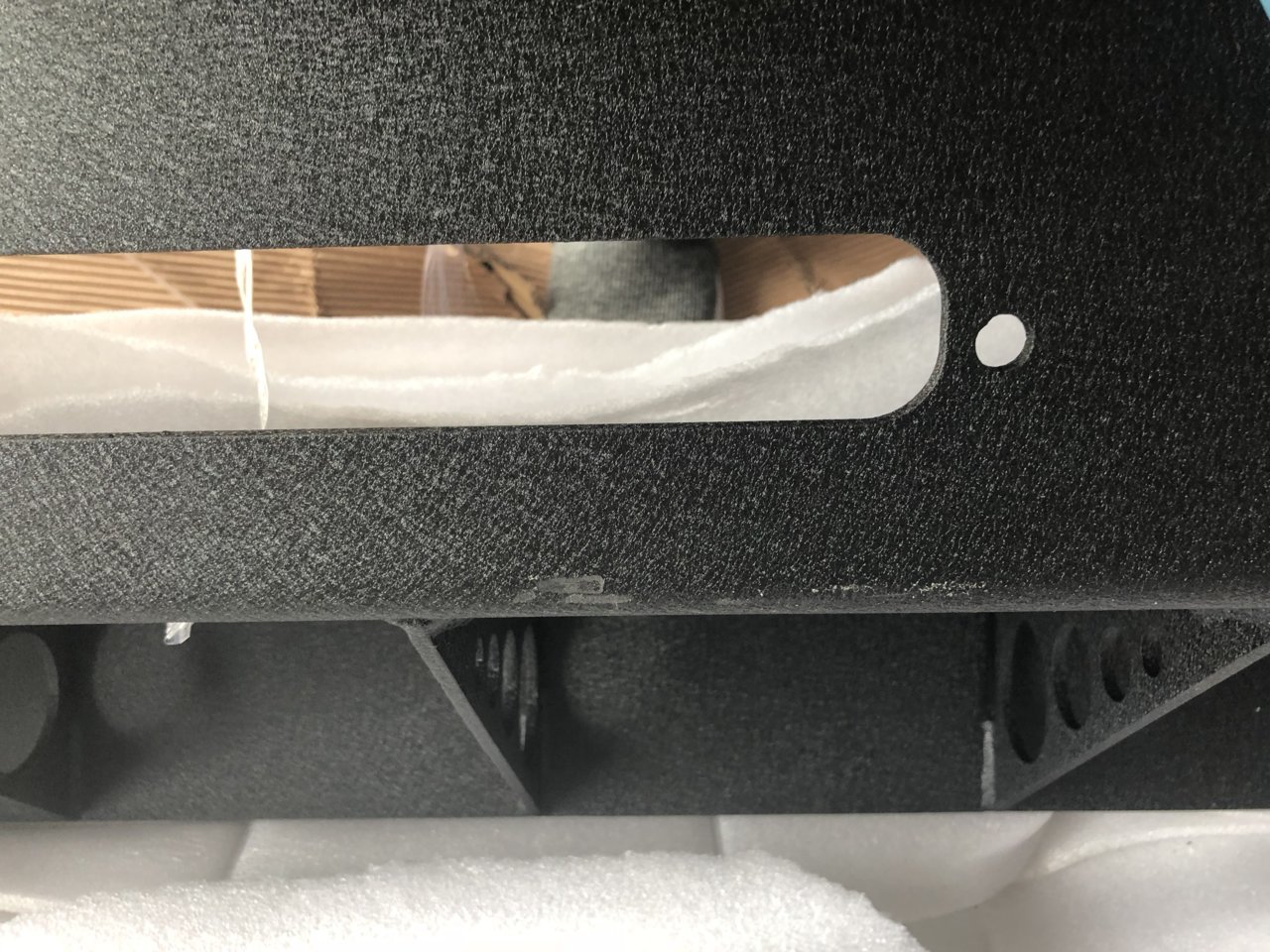

    Here's one arrived safely no damage I lucked out. The mark was my handy work dragging it across the box scraped the hardware I opened.

    Well, I feel like a douche. My buddy who helped me install my rear was told to "lift up and pull the bottom out as hard as you can while I tighten the bolts". He clearly did not do that. I just loosened the bolts and the bumper didn't drop any. Put a jack under it and jacked up and towards the rear. It now sits exactly like @anthony250f bumper. I'm amazed it was able to move that much with the holes being the size they are. Having said all that, I'm now happy with the rear bumper and think it's a best bang for your buck!!! Sorry for the confusion and I'm going to slap the shit out of my friend when he gets here in a few minutes for me to weld some jerry can holders onto his Heep.

    Awesome! I did the same thing and mine looked similar, then I broke out the jack.
