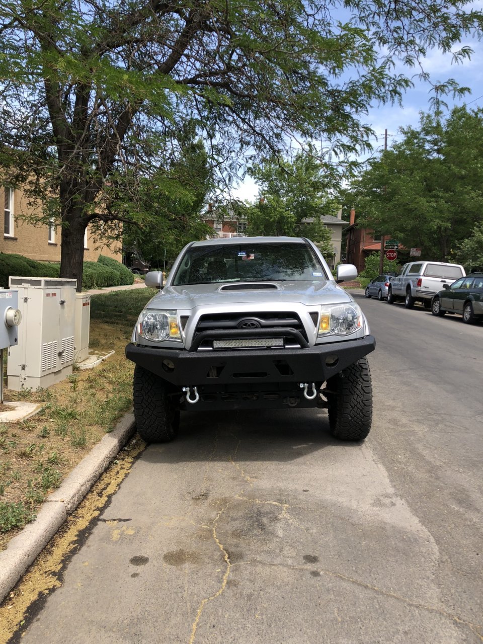

    Just wondering, what size is that LED bar? I thought I read a 20/21" when I originally read all the posts somewhere. Does that sound right?
    Nimble9 likes this.
  6. May 30, 2018 at 8:57 PM
    #6546
    anthony250f
    anthony250f Well-Known Member
    Feb 18, 2012
    #73066
    16,775
    Anthony
    San Diego, CA
    2008 dcsb trd offroad 4wd
    Yes

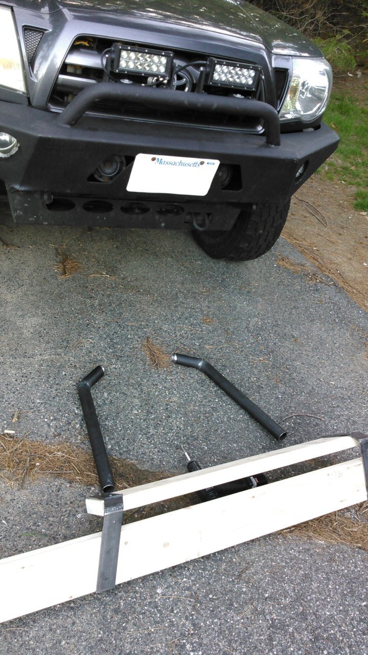

    Here is a pic (not mine) of what it looks like (hope you can see it...)
    I'm going to cut mine off tonight & run a light bar in the spot. (I'll post a picture in the next day or so. I cut support plates out and need to weld them on tonight. the stock plates ended up cracking. [​IMG]

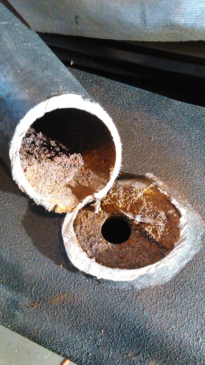

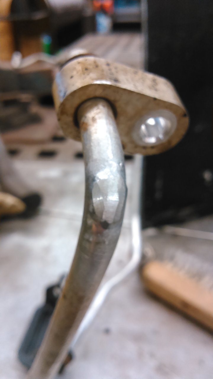

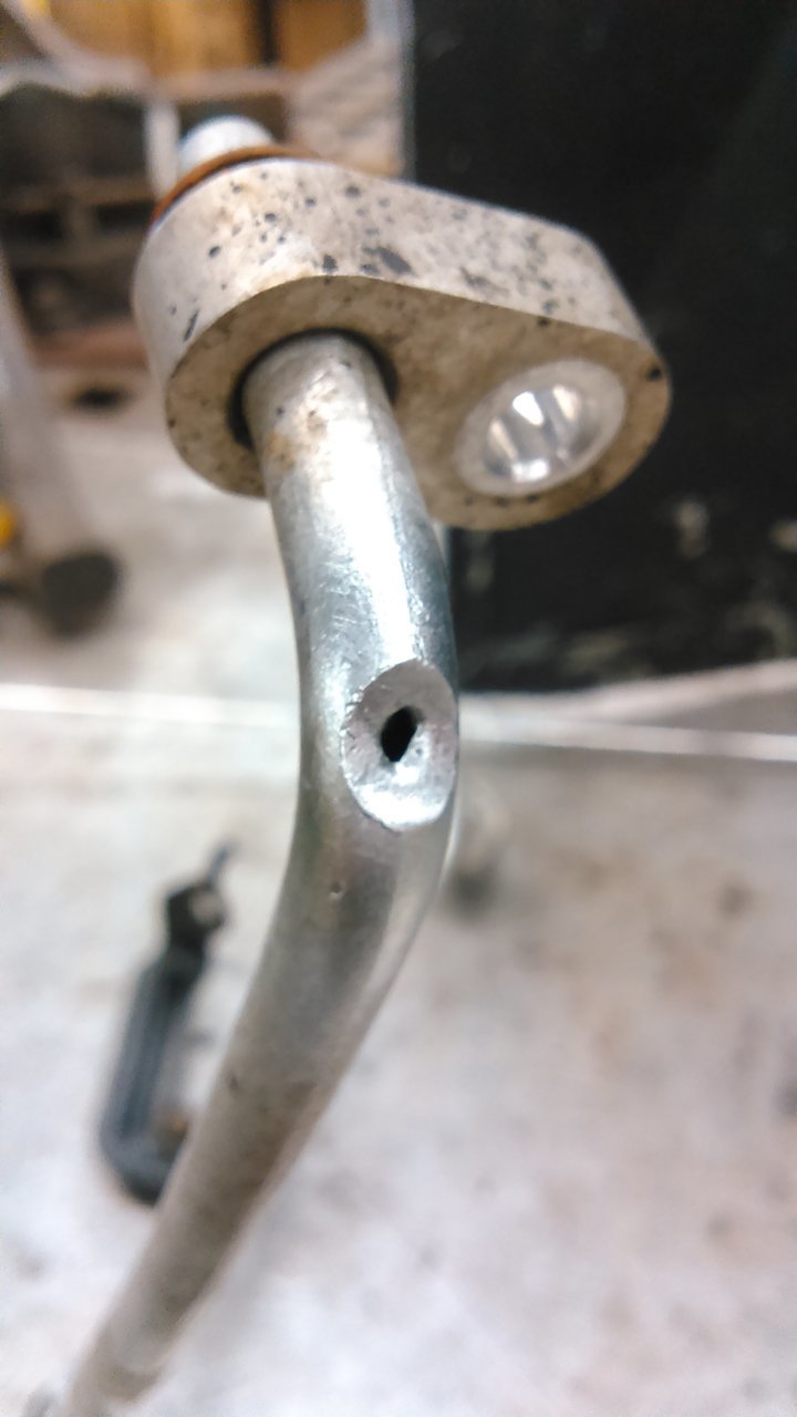

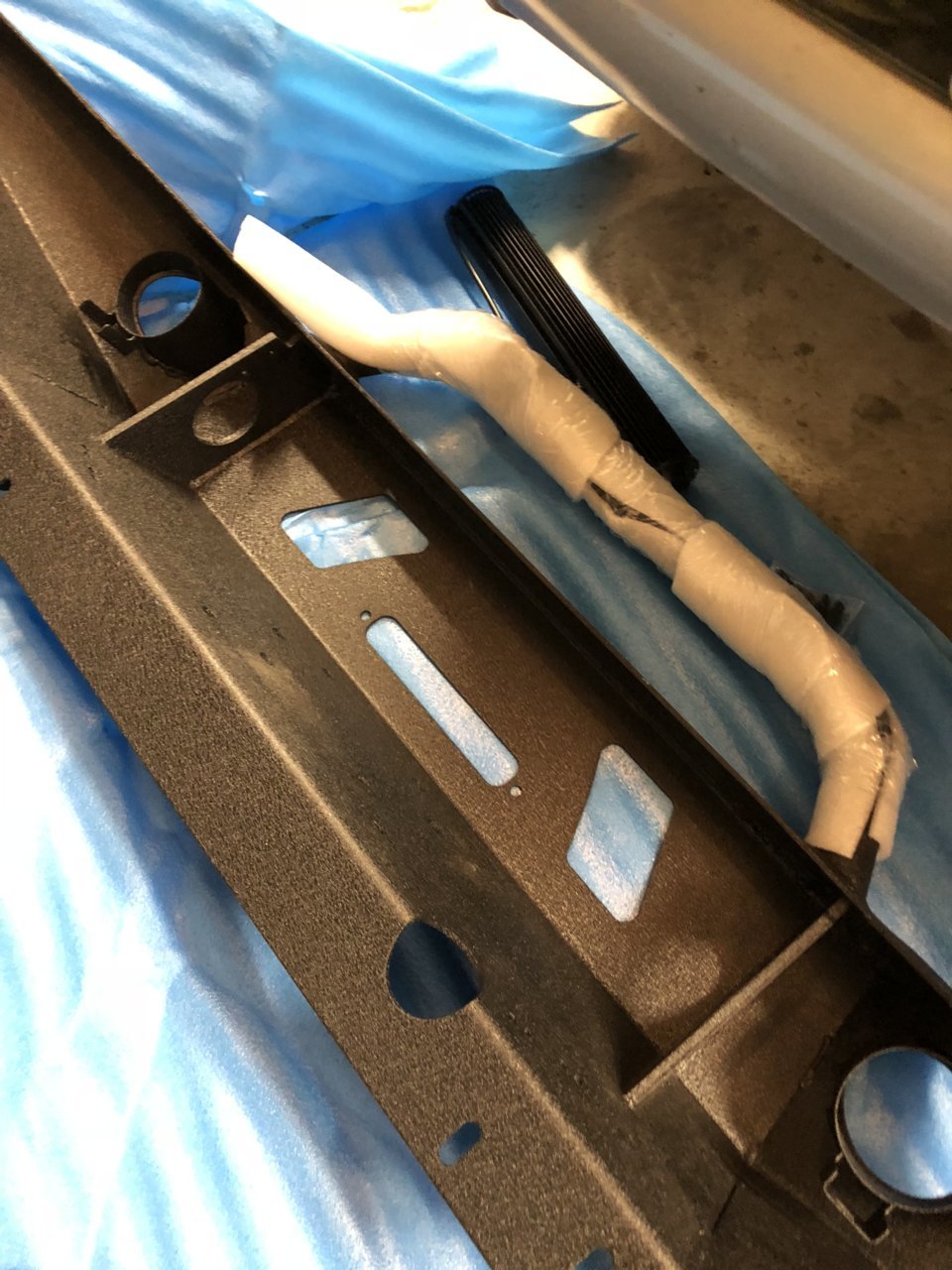

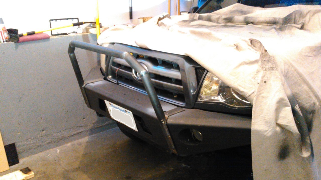

    I got the AC leak last fall. Ended up taking a welding class at my local tech school, just because. Pulled out the AC line and Tig welded it, works fine after a full recharge.
    Cut off the little hoop off and welded up my own as my final pet project in the class. It's more of a glorified brush guard, but came out OK. It's a bolt on because I didn't want to grind and burn the powder coat, and have to deal with that after too. The hoop had a lot of rust and these tiny rusted metal balls compressed together on the inside of the hoop.
    To notch the bumper I didn't take it off. I drilled a hole where I needed the notch from the outside, working up to 1/2" diameter and worked the drill around. Probably need a new drill bit, but saved me the headache of removing it.

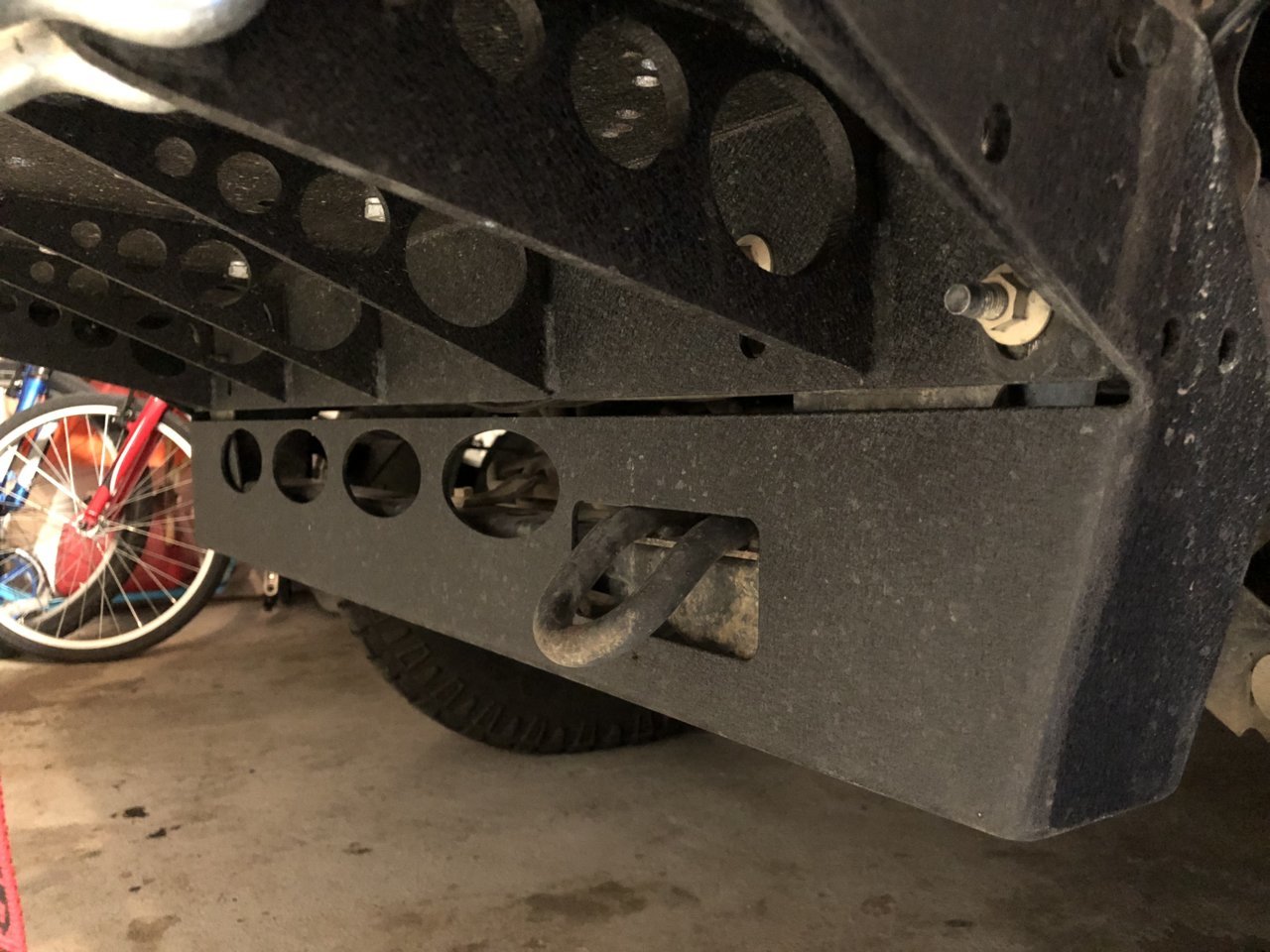

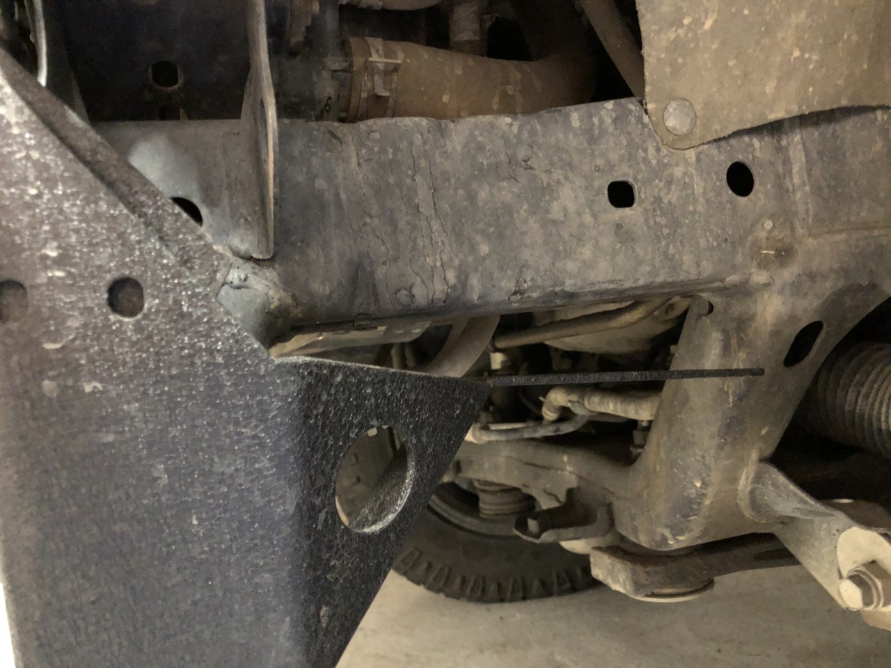

    I didn’t have the winch in or the lower segment on yet in the photos above but after installing I ran into an issue. Can anyone see something obvious that I’m missing? Can’t seem to get the 2nd half of the bumper to line up with the frame/1st half properly and not sure why. I don’t think the winch has anything to do with it (no where near the lower portion) but said that in case it’s relevant somehow.
  16. Jun 17, 2018 at 3:06 AM
    #6556
    MattCowsmasher
    MattCowsmasher ( -_・)ᡕᠵ᠊ᡃ່࡚ࠢ࠘⸝່ࠡࠣ᠊߯᠆ࠣ࠘ᡁࠣ࠘᠊᠊ࠢ࠘
    Apr 7, 2017
    #215629
    48,694
    Temple, Tx
    O3 Rubicon wrangler
    Mine doesn’t line up perfect either I had to fiddle with the lower half for a bit to get the holes lined up. An the sway bar mounting bolt I had to make the holes a little larger.

    It took me forever to get that section on. Put a jack user it and get it as close as you can. I also used ratchet straps to pull it sideways.

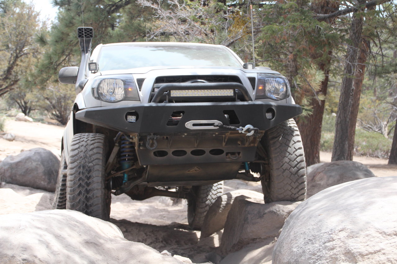

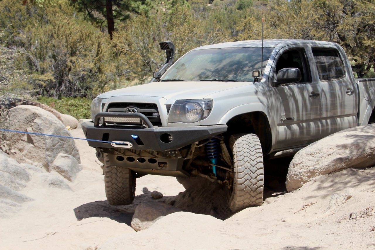

    Bumpers have seen some serious abuse. Also I have used the winch multiple times and have not had any issues. The stock mounting plate is gonna need to be beefed up soon though..
