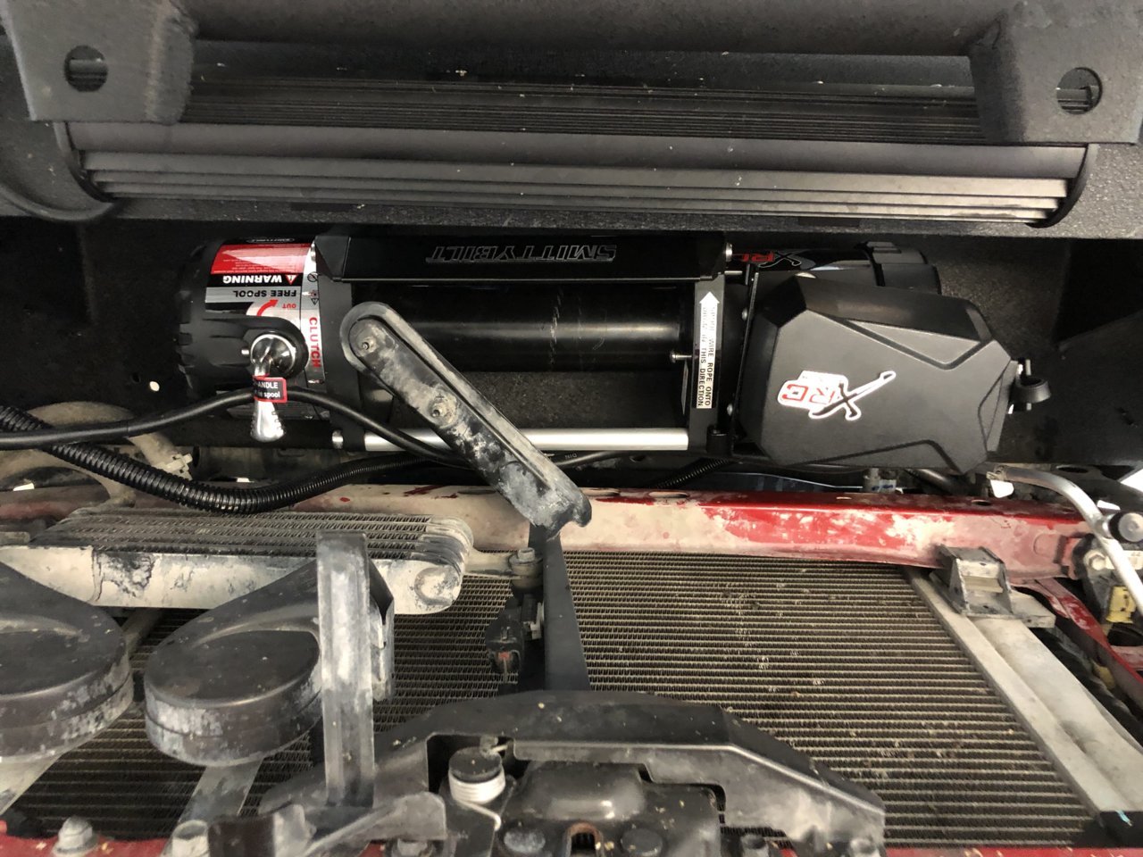

    If you already haven’t installed the winch some good news you don’t have to remove the bumper. I installed mine this weekend didn’t have to remove it I took the grill off an the brace that runs in front of it off an bent the center support 90 degrees an it slid right in from the passenger side. Made the support straight an bolted brace back down.

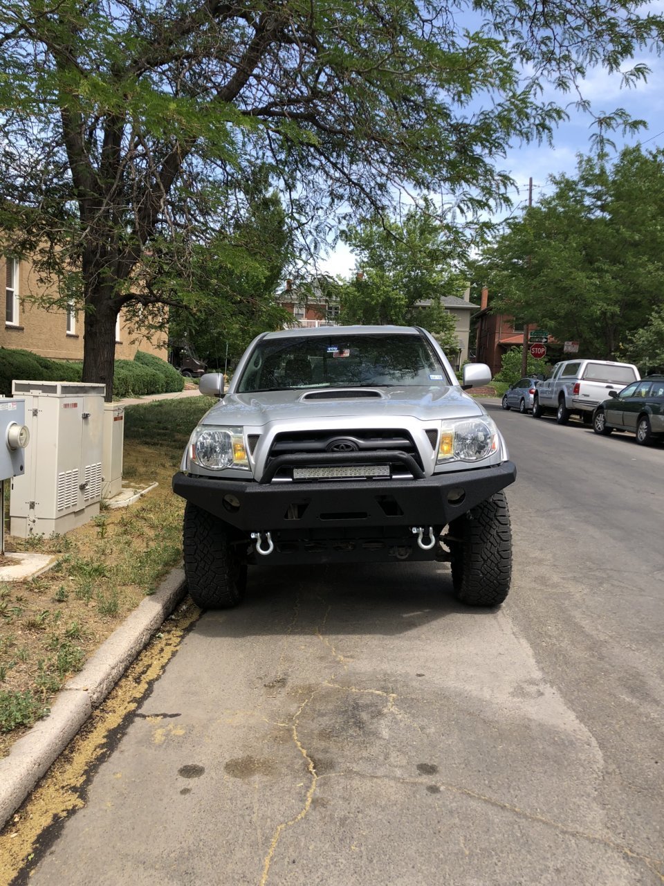

    You keeping it with that dent?

    yep, I did the exact same thing. still can't figure out what I'm doing wrong with the lower part though

    I thought about it at first but to be honest I forgot it was there after a day. Not worth the trouble of sending it back personally and I don't think it looks as big in person. Harsh lighting in that photo. Winch takes some attention away from it now too.

    Ok, I'll give that a go thanks.
