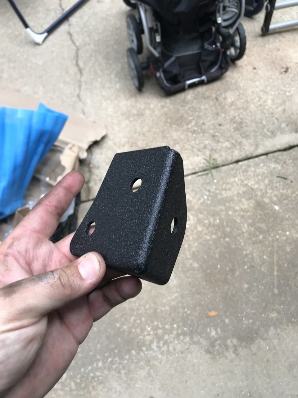

    Any idea what these brackets are for? I ordered front and back at the same time. I know I was missing some stuff that they’ve since sent. However, I’m not sure where these go.8AD8F264-7903-46BF-BB74-072C71430E02.jpg
  4. Jul 24, 2018 at 9:34 AM
    #6604
    MattCowsmasher
    MattCowsmasher ( -_・)ᡕᠵ᠊ᡃ່࡚ࠢ࠘⸝່ࠡࠣ᠊߯᠆ࠣ࠘ᡁࠣ࠘᠊᠊ࠢ࠘
    Apr 7, 2017
    #215629
    48,694
    Temple, Tx
    O3 Rubicon wrangler

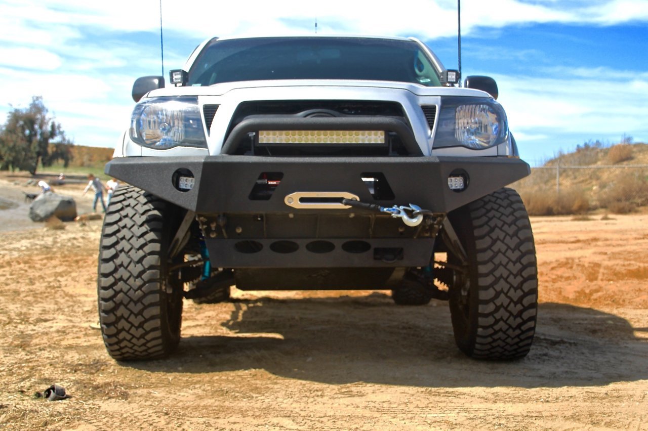

    I have your same set up sos skids. I just went thru the bottom of the bumper only trimming was for the AC line.

    Only pic I have of the front

    MolonLabeTaco
    MolonLabeTaco Well-Known Member
    Jan 30, 2018
    #242953
    2,786
    Dude
    N. Texas
    '12 DC 4x4 OR
    I ordered/installed front and rear eBay bumpers as well. I didn’t have a piece like that.

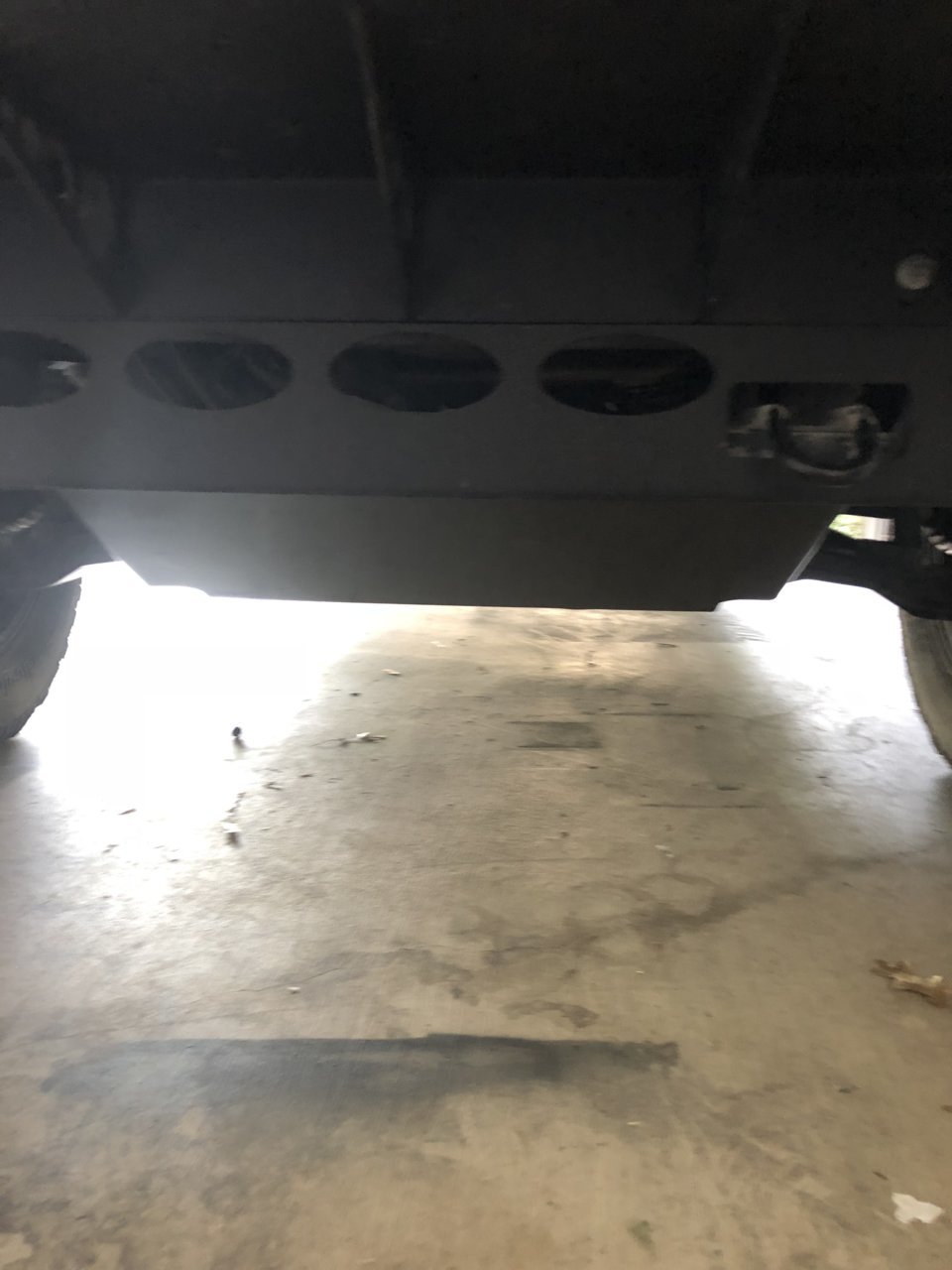

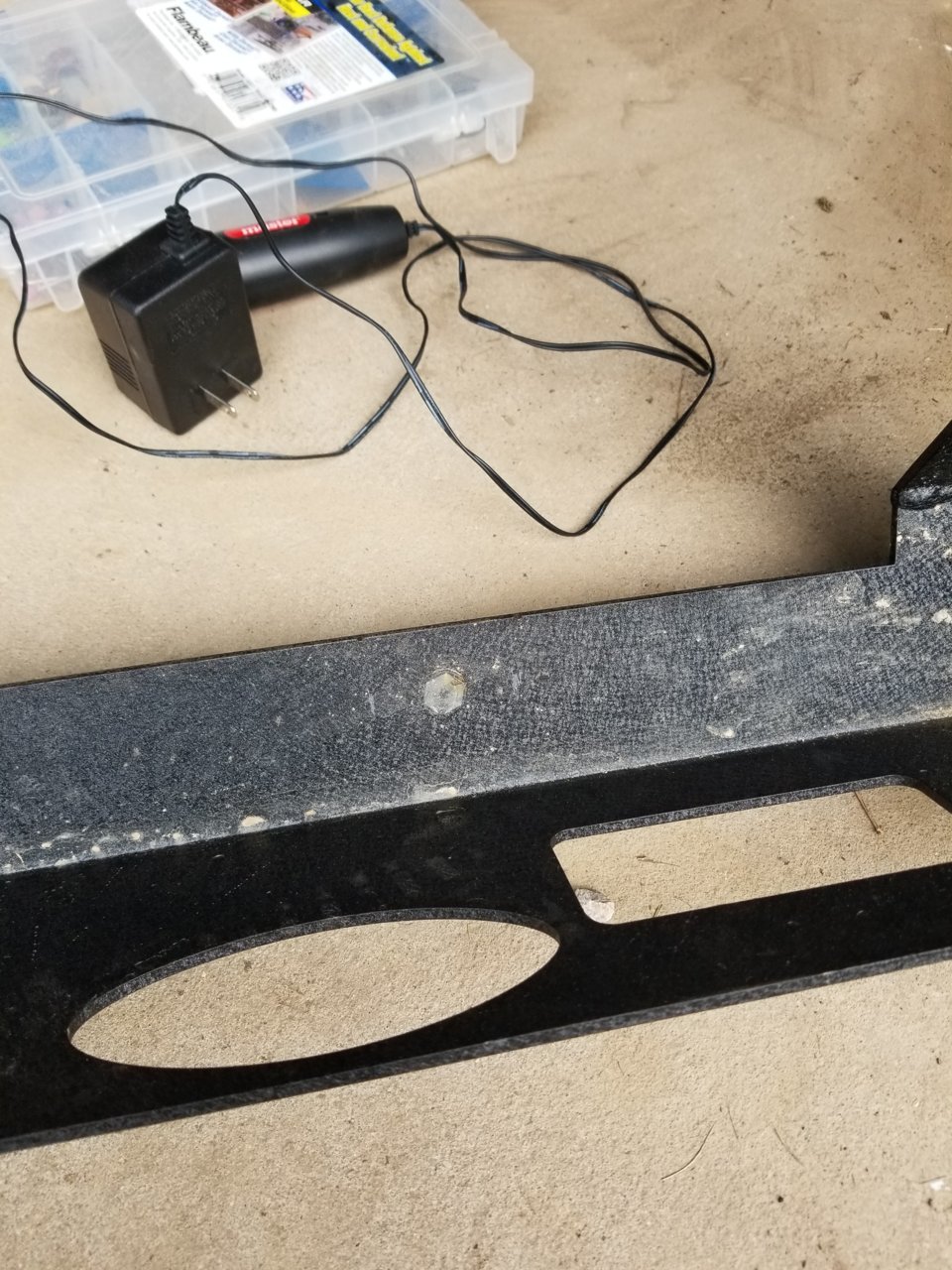

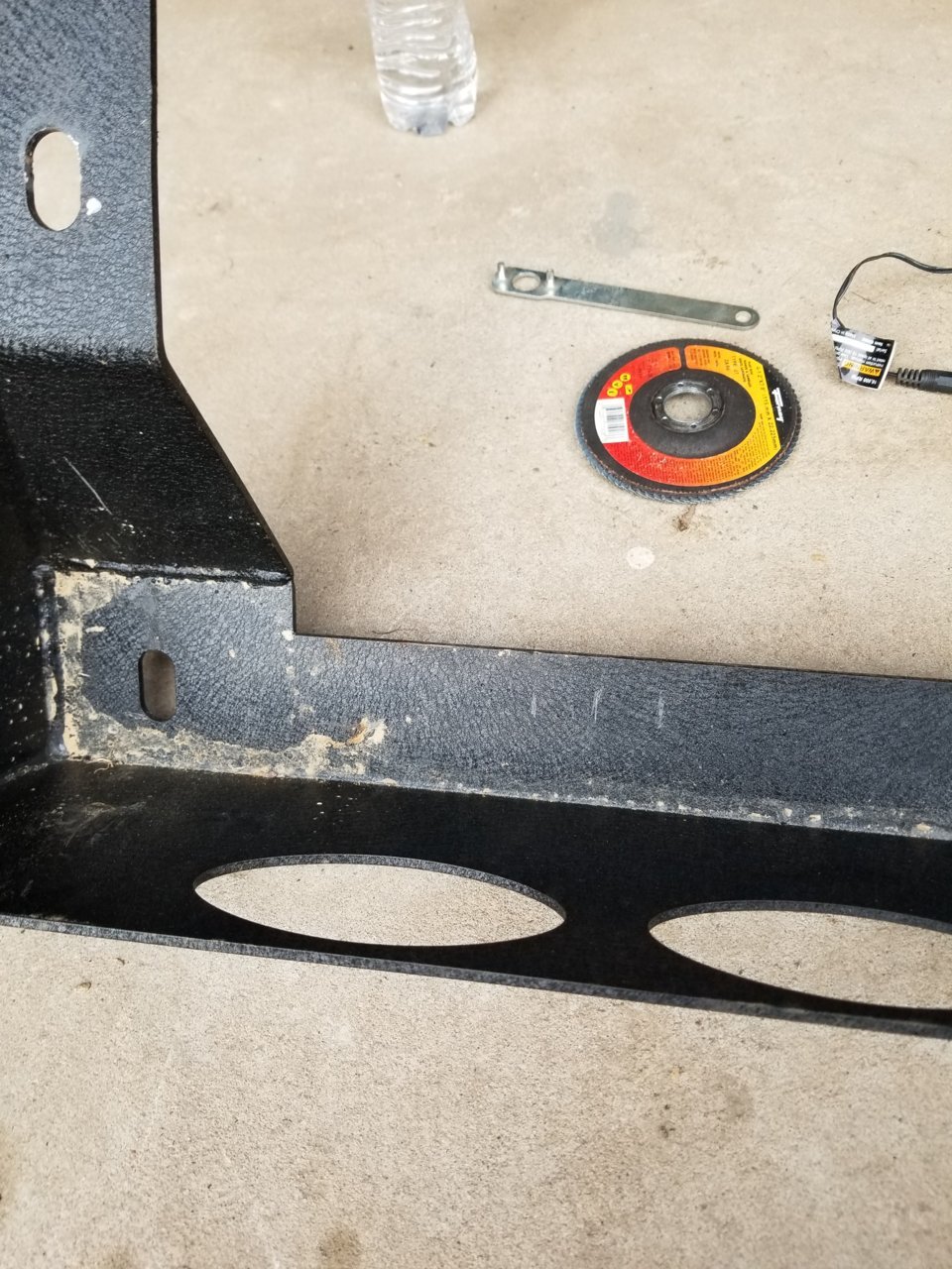

    No holes for skid bolts. First pic is where I marked where it is. Second pic shows a dirt impression of the other bolt head.
    It's getting notched.

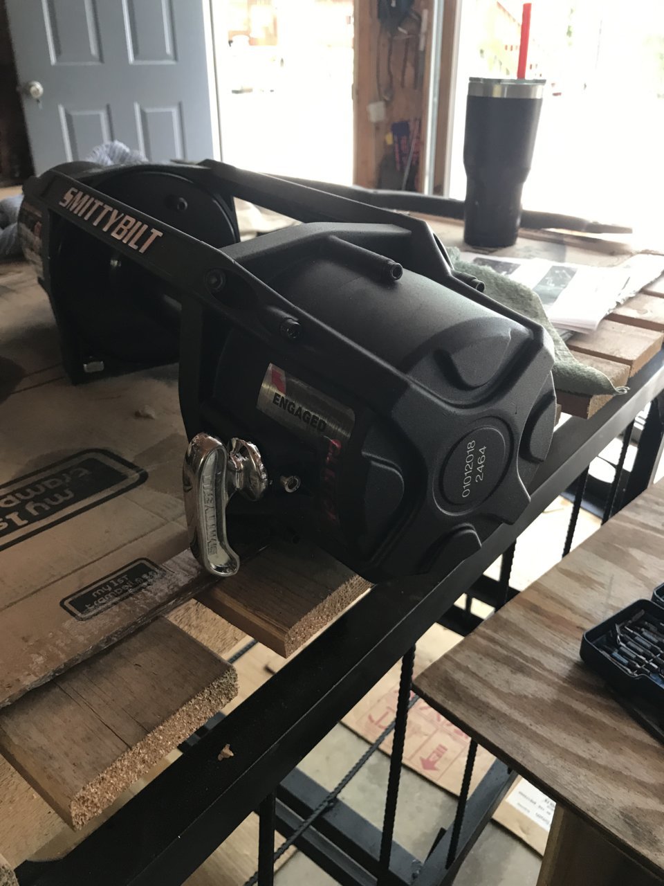

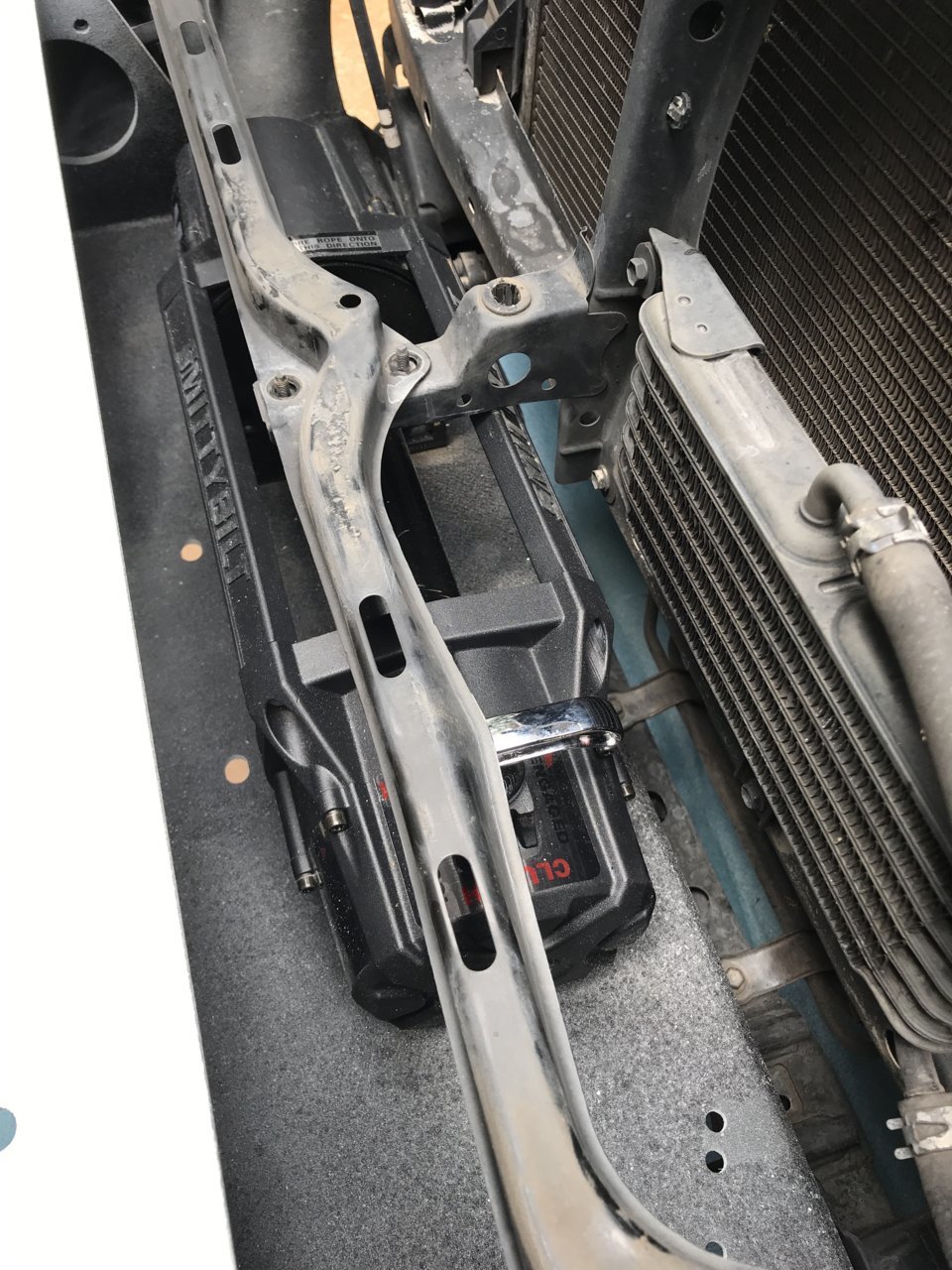

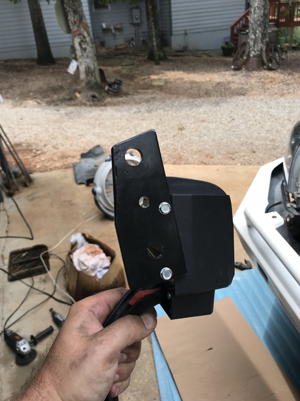

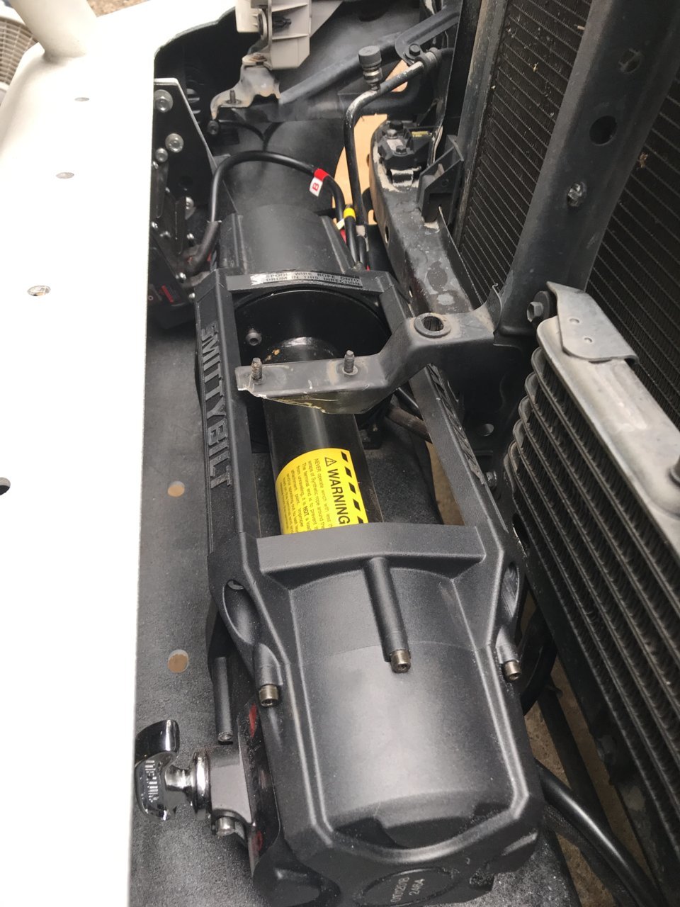

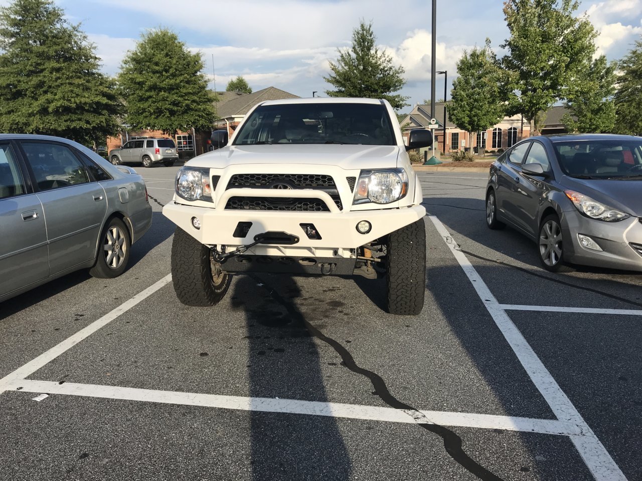

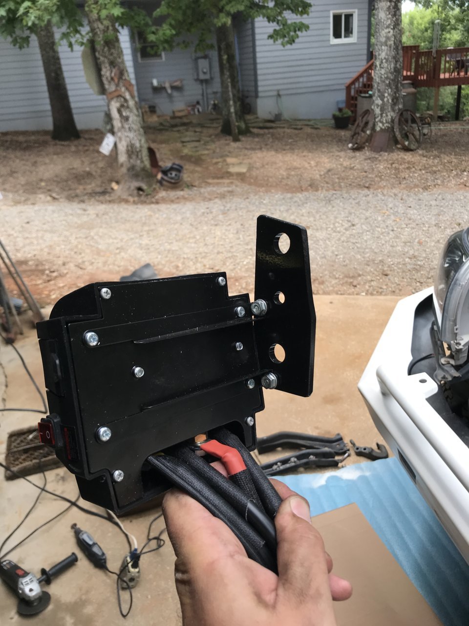

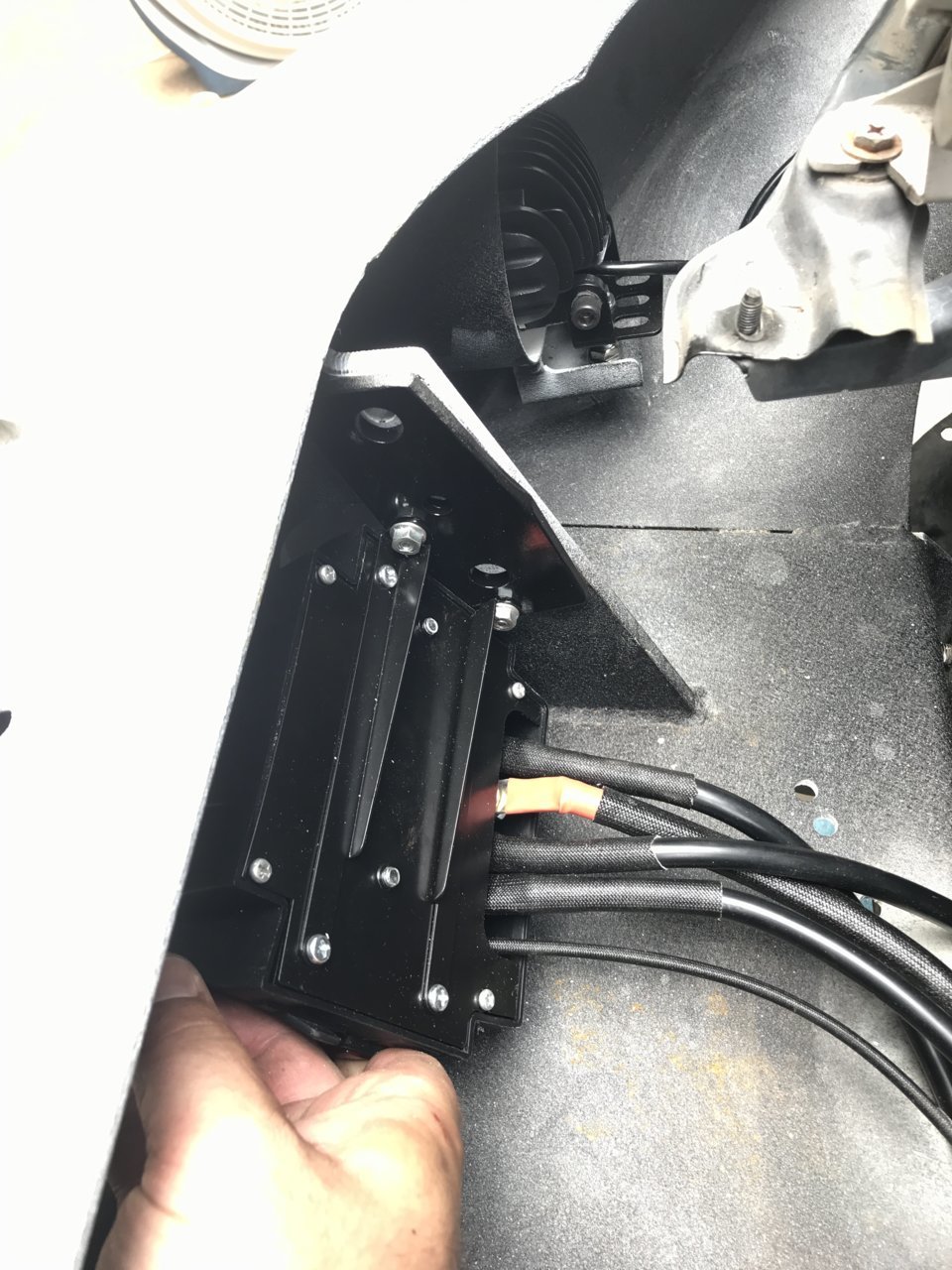

    I actually clearances the grill support bracket more than this. Once I started soooling the rope on the winch I wasn’t comfortable with how close it was to this bracket. I removed it from the truck and cut the side off straight below the two studs. You can also see where I’ve already notched the back of the bracket where it slightly interferes with the winch support brace. There were 3 existing holes in the bracket, I just played connect the dots with my wiz wheel.
    This is a good indication of where the back 2 holes were off on each side. I simple drill bit enlarged the holes enough.
    Finished product!
    This is how I rotated the free spool lever to the front of the winch instead of the top, this allowed me enough clearance to reinstall the horizontal brace that connects the headlight support brackets.
    The pics ended up before what I typed below...
    I’ve had my front and rear bumpers sitting around for almost 6 months. The primary reason I waited so long to install was a pure lack of time. I also wanted to color match the bumpers.
    Over the last week or so I got the front bumper painted, notch done for AC line, lights and mounts and winch sorted out.
    There’s a lot of random info in this thread without details on winch used, etc. I used the smittybilt 10,000 H2O winch, which in hindsight, wasn’t the ideal winch for this bumper due to interference with the grill mounting brackets and the headlight cross brace.
    I made a bracket out of some scrap aluminum to mount my winch control box to the bumper itself (similar to what you see in the AllPro instructions).
    I’m happy with the end result. I had to enlarge the two most rearward holes of the 6 mounting holes on each side of the bumper. Everything else lined up with the use of a floor jack supporting various spots.

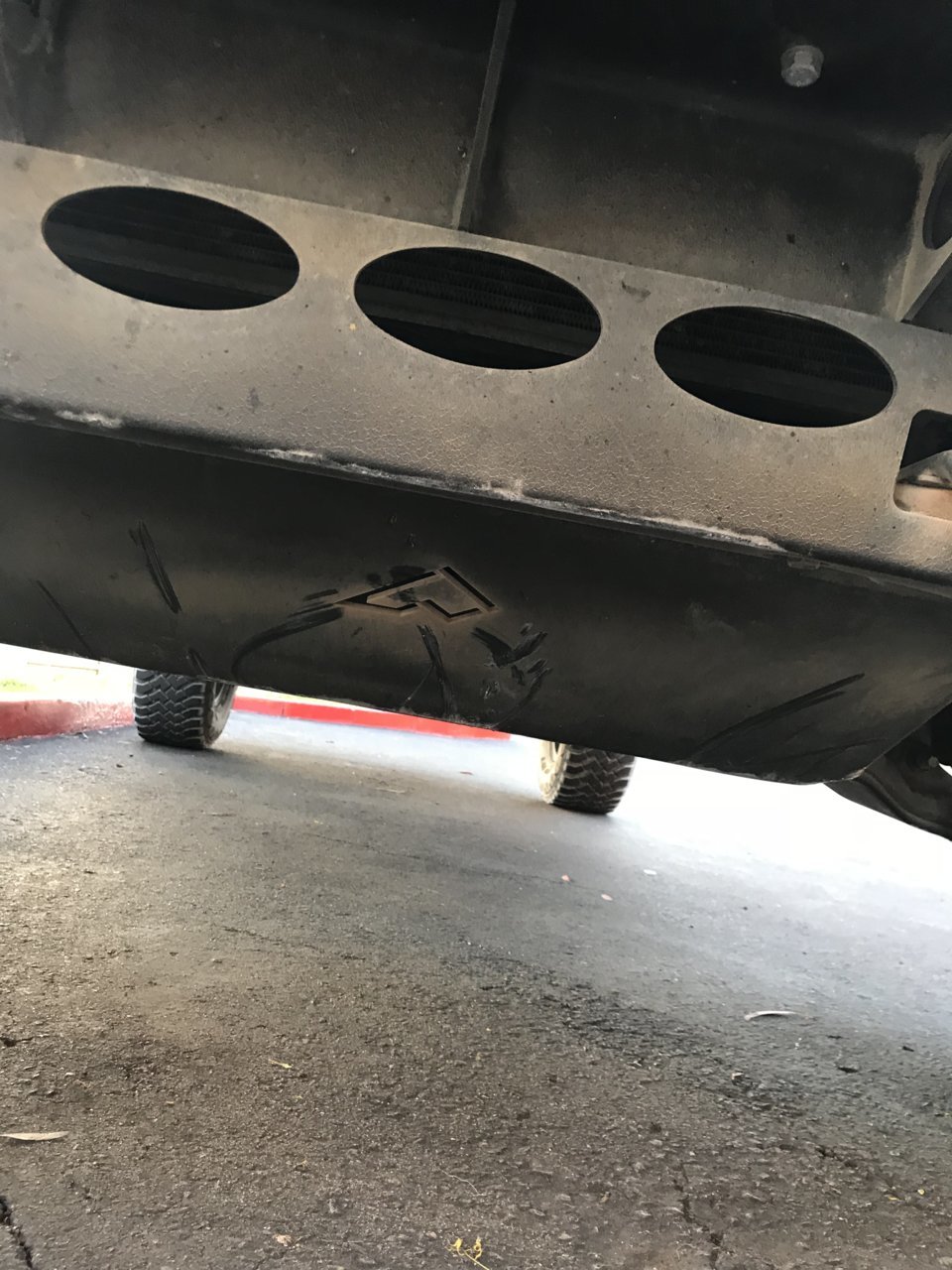

    I was planning on the same winch but ended up getting this x Bull 13k for free. My rope came close to that same support too.
    Have slammed this bumper super hard into some rocks too.
    0CA7E8B6-2AC9-42FB-B61F-A026A4794FE7.jpg 5B54AB7D-2515-493D-9810-5C2776334CC9.jpg

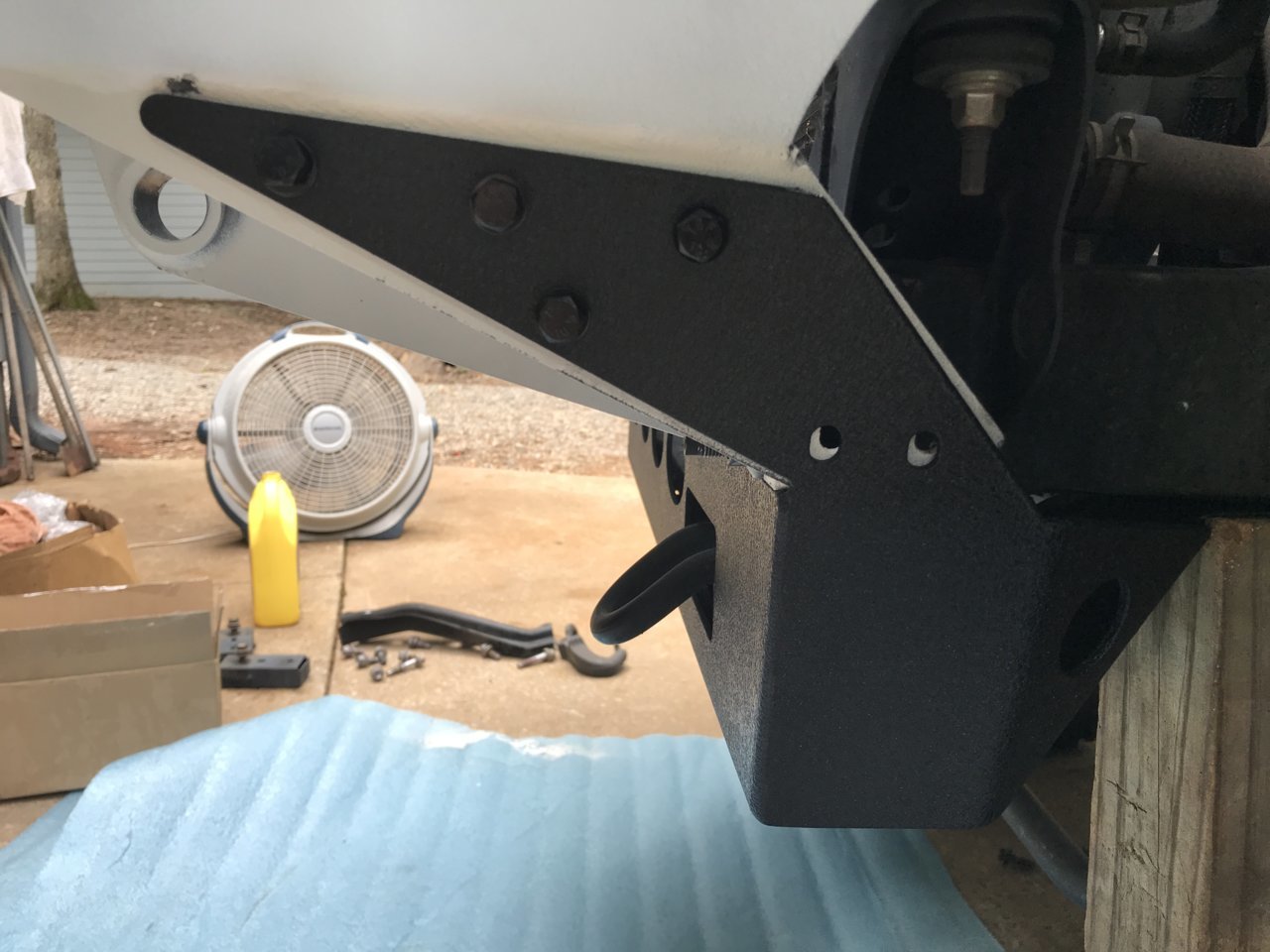

    Finally got this to align nicely! Had to notch lower part for front skid bolts. Going to have to heat and persuade the cross member to put those ghey end caps back on for 2 more mount points. Need to drill holes for the bolts that join the 2 pieces on the sides because there is little alignment between them, got only 2 bolts per side.
    Work in progress. The above will get done when the winch goes in.
