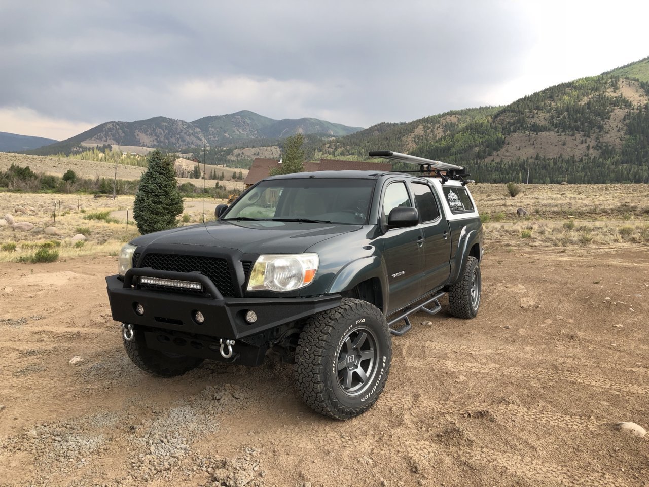

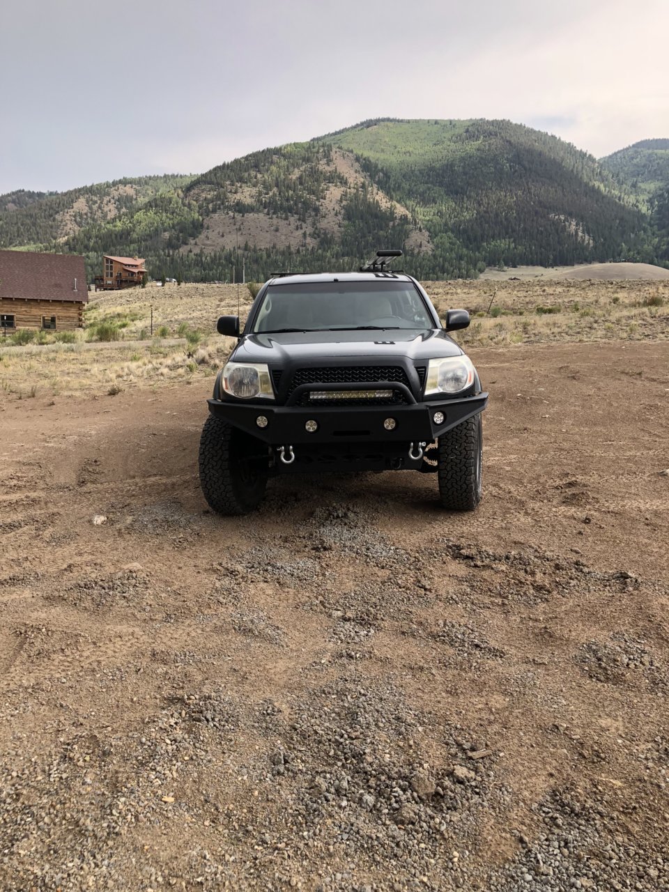

    I actually liked the extra light holes. I have the inner lights aimed as fog lights and the outer two wired with the light bar and aimed out toward the side a little bit to get some extra overage. I'll see how I like that setup, but may change things around.

    How well did the light bar drop in? Is it 20 or 22 inches?
    I'm thinking of getting a curved bar, also from ebay. Think it'll protrude forward? Or will it even mount?

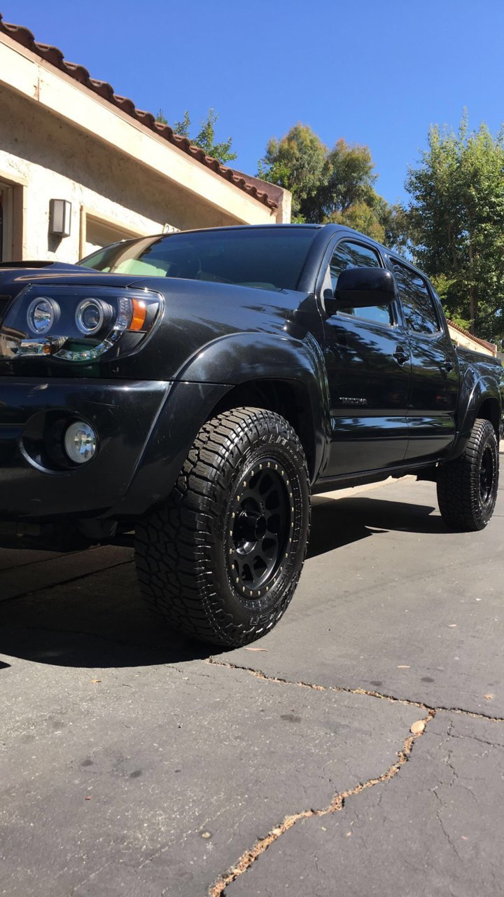

    Hello I’m sorry for not being able to sift through this massive thread but I was wondering how this bumper looks on stock trd sport suspension? Could I run it for a few weeks before I get 5100s and ome 888s?D45991B9-0A62-4136-A032-9089D1F30B46.jpg F6A5C86A-B6A1-41B1-A6D7-5EE307EC79ED.jpg

    Better than stock an yes you'll be able to run it till you get your springs. The original eBay ad states the white truck in the photos is stock.
    I see your truck already has nice sneakers an headlights, IMHO I think the bumper will set it off..pro tip install bumper while it's stock, lifted its a pain them couple inches is right at most people's pivot point for lifting it.

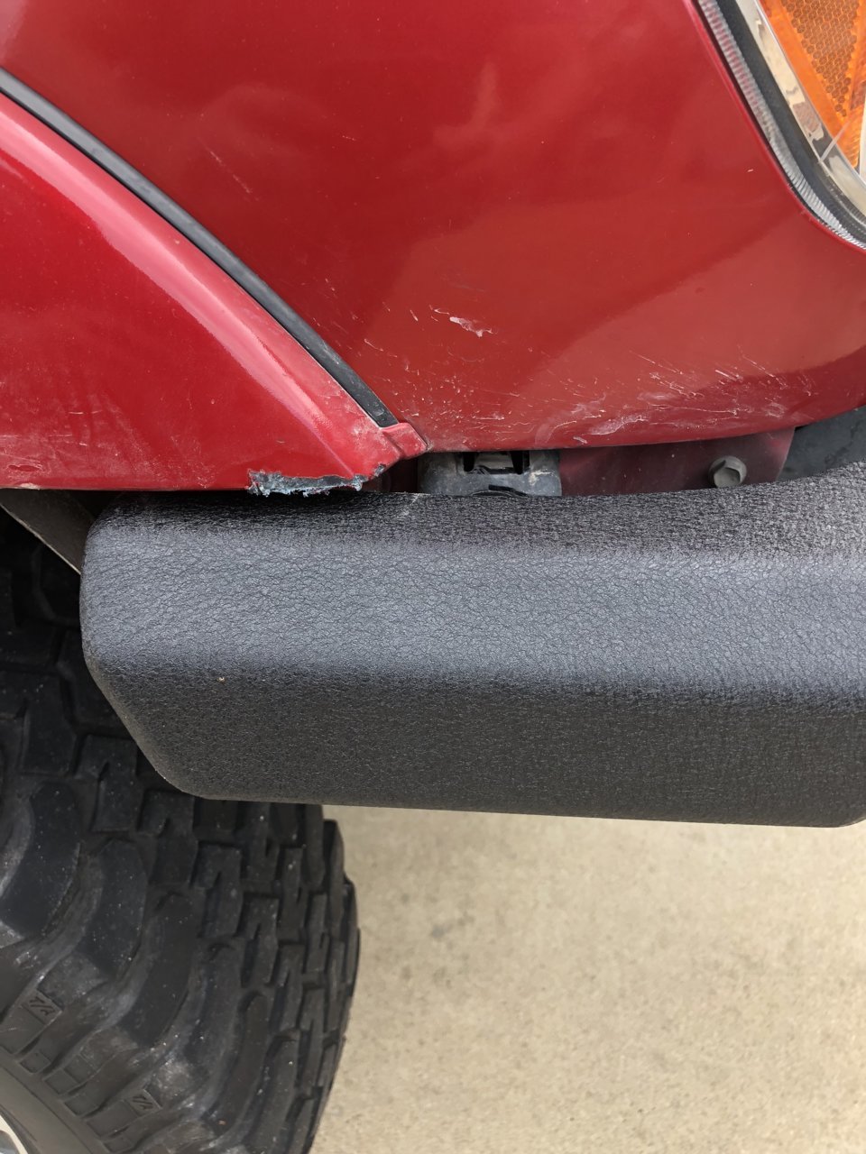

    Forgot to add: I didn't try too hard at aligning it, the 3rd time adjusting it. So it is touching my front flares and pushed them a bit.
    And I don't really feel like fighting it and beating on it again, I'll take the flares off

    It shouldn’t be touching the flares. As soon as you flex it’s gonna do some damage to them. Should be like a 1/2” gap between the bumper and the flares.
    I’m not sure of my exact gap but I can fit a finger in between.

    It needs another adjustment, I just haven't done it, again. Passenger flare is now stuck out about 1/4" after wheeling, and not sure I can get it back in flush. That's why I'm willing to lose the flares.

    @Cam2010taco this can happen if you get he-man with the bumper trying to lift it..don’t fight it this is why some help if necessary I did this to my fender flares on both sides.
