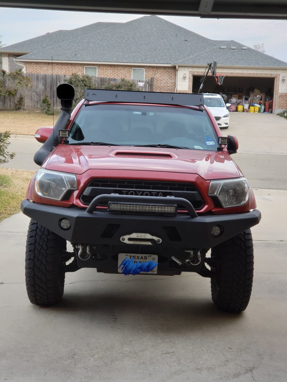

    i say cut the hoop off

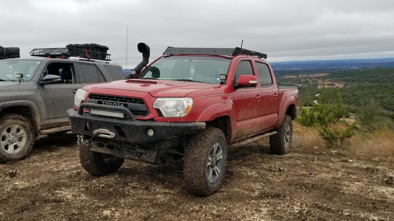

    Question for you since you’ve done some winching. Since there weren’t any instructions for install of the bumper, when you mounted the bumper how many nuts/bolts did you use? There were the obvious 6 nuts on the front (3 per side), and the 4 sway bar bolts, were there any others?

    The 6 front bolts. All the bolts on the sides that connect the two parts together. The 4 sway bar bolts, and then I added two extra bolts that hold the bottom part to the crossmember (by the tow hook)

    Led bar might look out of place though. Might ditch the led bar lol

    Excellent, thank you! I saw those 2 as well on the crossmember and was thinking I might need those as well.

    Just cut those end pieces and slide them back in in order to use those bolts

    ditch the light bar or relocate behind grill if you have room in front of the coolers

    Gotcha, I didn’t look close enough then. I take it the nuts are welded to those end pieces?

    :evil:love it when your at right angle..but the hoop covers the toyota head on.
