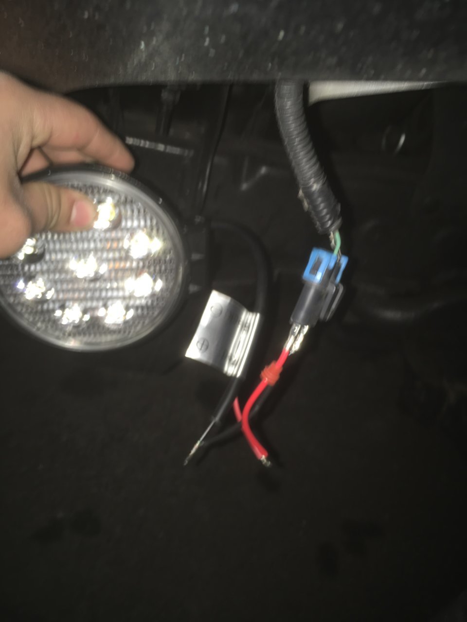

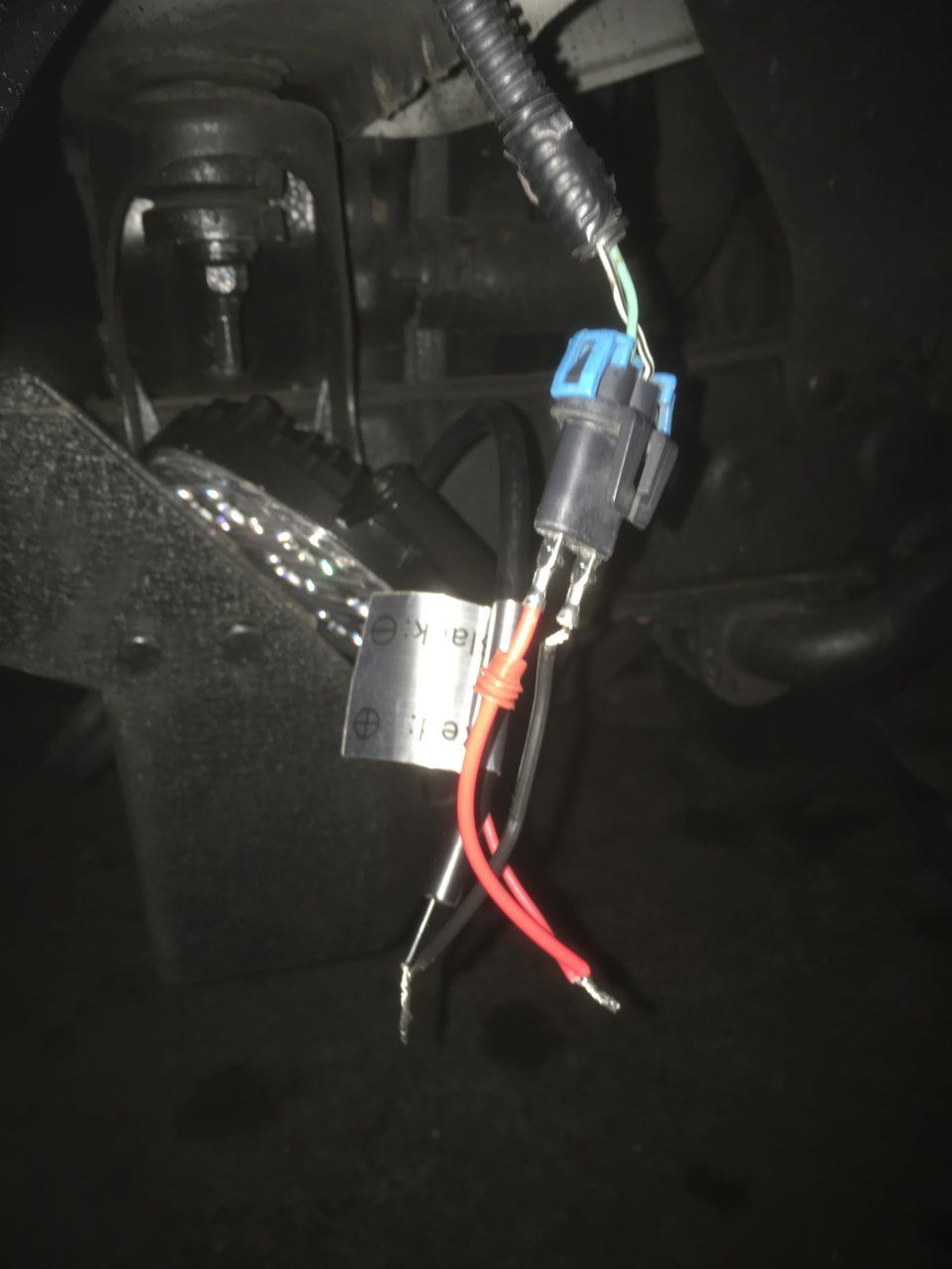

    Yea I tried that. Didn’t work unfortunately. I tried reversing the way it was plugged into the factory harness and I tried at my wire connections. And I tried it with the switch depressed and not depressed and the headlights on and off

    Going to try touching the wires to the battery tomorrow morning to see if they work or would that ruin them ?

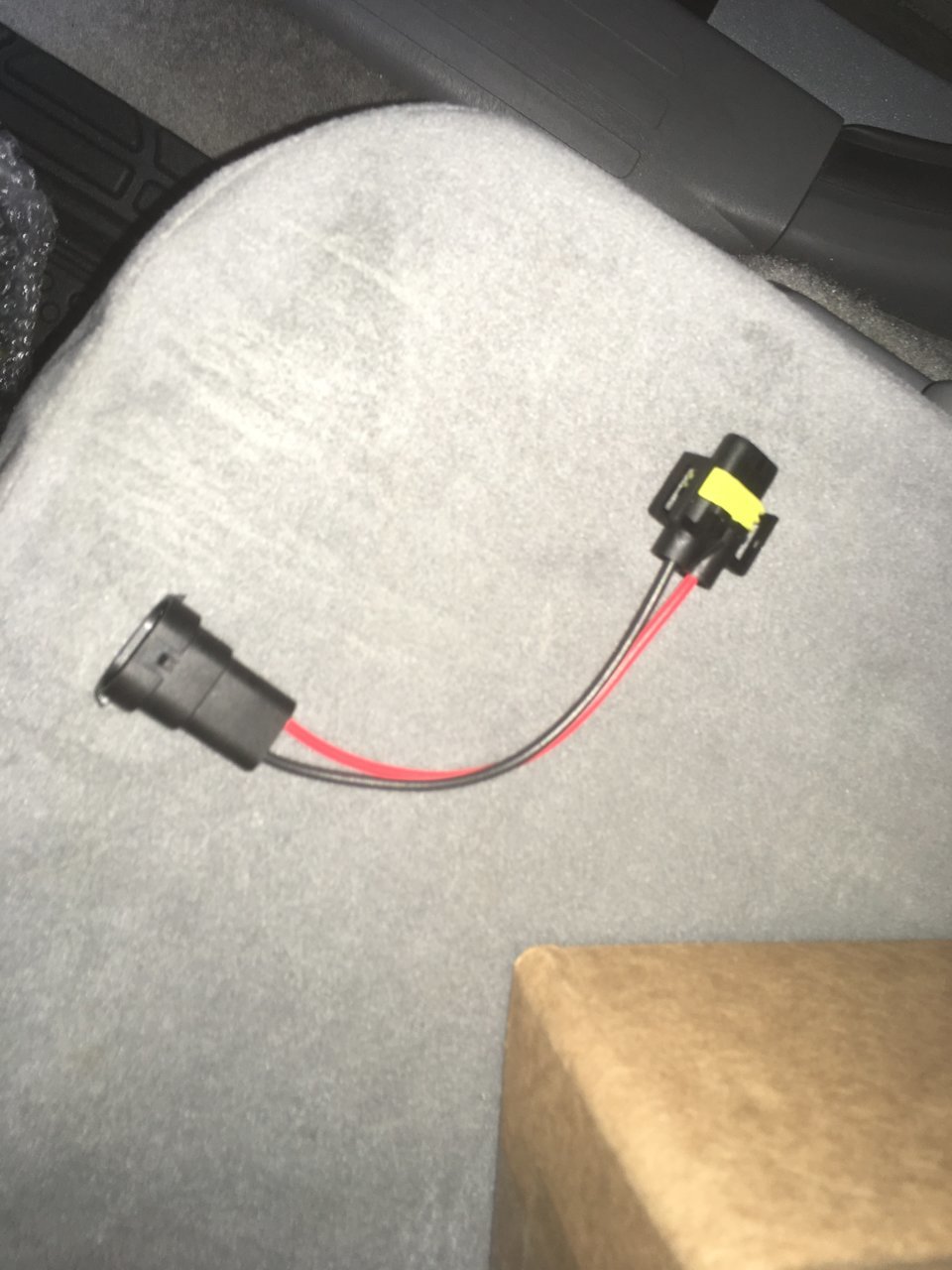

    I literally planned on doing the same exact thing. Here is your problem: you need a Relay.
    You can wire one into factory “fog light” wiring or do what I did.
    I went to Walmart and bought the wiring harness kit for $15. Instructions were pretty self explanatory. (What I did) I cut the plugs off of the harness and just “hard-wired” them with butt connectors and heat shrink. Hooked up harness to battery. Fished the harness through the firewall and instead of using the supplied toggle switch I used the factory Foglight button.
    Let me know how it goes. Good luck

    damn that sucks wish it was easy lol. Guess I’ll try that out then. Do you remember the name of the kit or brand or anything

    To be honest I don’t know the name. It was just in the auto/electrical by the lights at Walmart. I think it was called “DT wiring harness”. This was on my older truck (which I no longer own). Or I could show you pictures.
    Was going to do this on my truck now, but going to try and add the relay to OME fog harness. If you want to wait a couple days I can let you know how that goes and do a little write up.

    I just got my lights and light bar in so I’ll be trying this on the weekend. As of right now my OME fog lights turn on. (I did the “anytime fog” mod a couple months ago). I will try to directly wire them up and see what happens.
    *disclaimer* - anything electrical is not my forte, so feel free to point me in the right direction. My only knowledge is from online research and trial and error.

    Ok, so I couldn’t wait any longer... I cut OME factory light plug right by the fog light bulb. Directly wired my lights in. Work perfect,(anytime, because of the “anytime fog mod”). No relay, no nothing.

    Gonna recheck my fog light fuse, do the anytime fog mod and then try again
