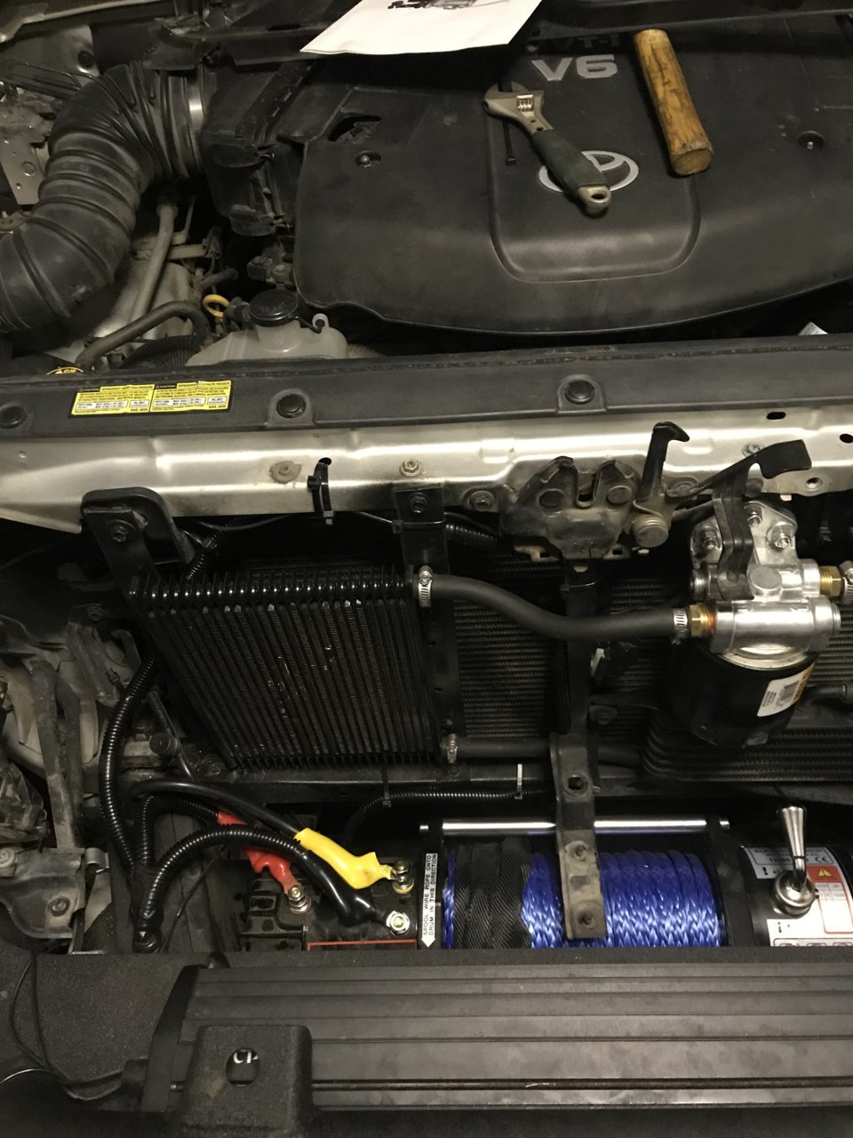

    anyone running a winch in these things? everything alright with clearance / rigidity?

    Running an Engo winch with my bumper. The grill does not fit flush with the winch installed. The bumper doesn’t allow the winch to sit low enough to clear the grill.

    I had to ditch the front support bar and also notch the grill for mine

    any photos of this?

    Best I have

    Yes, and yes. Mine, being a 2014 and 4 banger w/o tow package/trans cooler, I didn't notch anything. Like others, I did have to remove the front bent sheet metal grille support only to get the winch in. I don't really like it aesthetically because it kinda gaps the bumper at the grille and headlights.
    NOTE: After some winching and recovery jerking after my recent outing, and general tomfuckery in the woods, the bumper or maybe body panels :rofl: have moved. I really drove the shit outta my truck that weekend.
