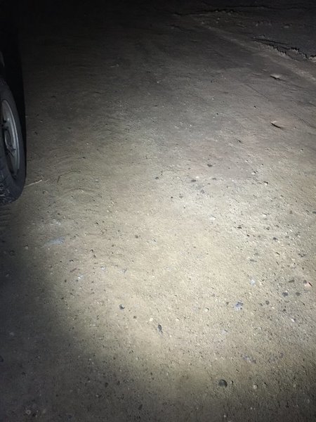

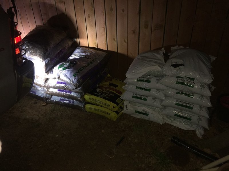

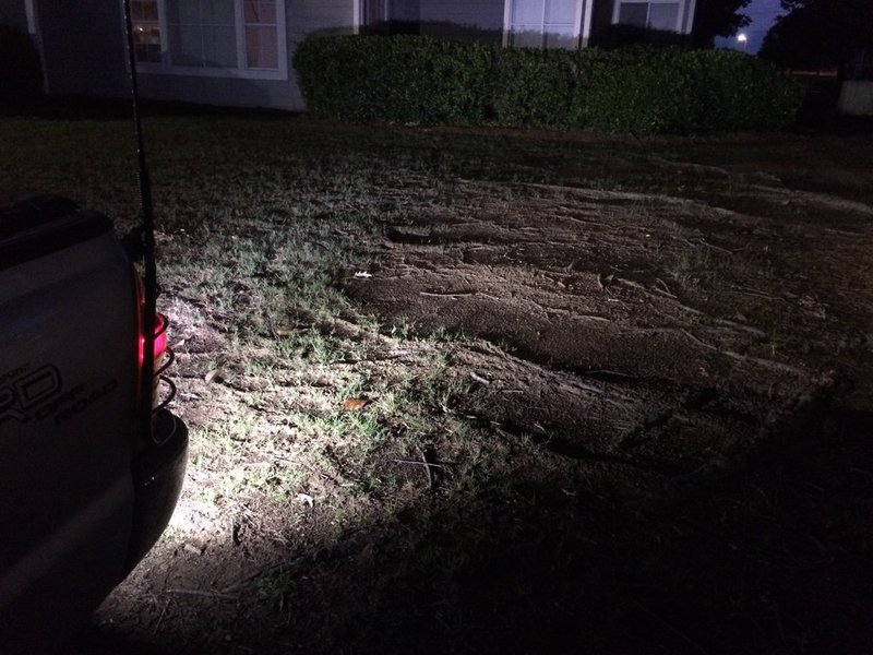

    ‘05 TRDOR DC
    Sorry if the streetlights are kinda skewing the pics. The lights are a little more noticeable than the camera makes them look. image.jpgimage.jpgimage.jpg

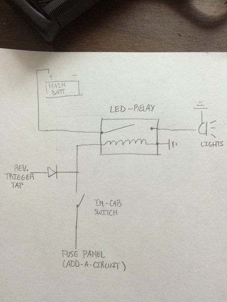

    What pattern did you gets get? Flood or spot? I think I'm gonna pick up a pair of these. How did you wire them up?
  10. May 27, 2015 at 8:46 PM
    #30
    MDB Taco
    MDB Taco Well-Known Member
    Dec 6, 2014
    #143767
    1,484
    GA
    ‘05 TRDOR DC
    If my memory serves right, mine are spot pattern.
    As for wiring, I have the pair on a dedicated harness, with both a manual in-cab switch as well as a jumper wire (with diode) connecting the reverse light trigger wire and the LED relay trigger wire. That way they come on automatically when I shift into reverse, and I also have the option of turning them on anytime.
    Sorry about the diagram being so poorly drawn and/or any mistakes in it.
