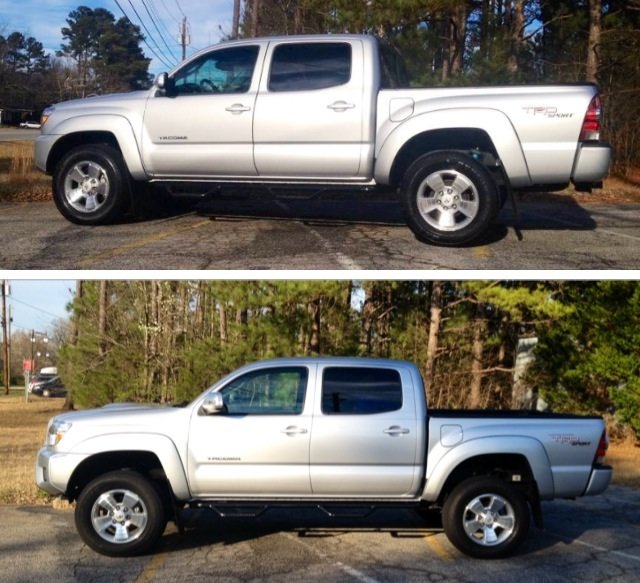

    Headstrong Off-Road Bilstein kit:
    Billies set to .85, OME 884 coils, Deaver 1.5-2" AAL
    Stock 265/65r17 Alloys, no wheel spacers.
    Stock: Fronts: 20” Rears: 21.5”
    With Lift: Fronts: 23” Rears: 23.5”
    I imagine this will settle down over time. How does it ride? FANTASTIC! No shudder in the drive line, no sailing at highway speeds. Before on top, After on bottom:
