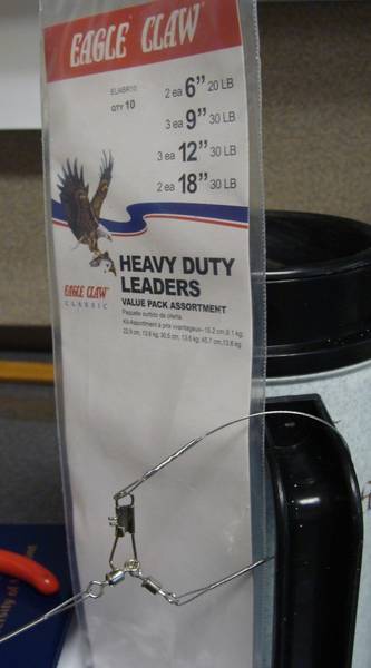

    I wanted a tether for my GoPro HD camera since its used a lot with my outdoor powersports, skiing, & mountain biking.
    Last year I almost lost the $299 cam on the trail when the 3M tape mount came off. :eek:
    I did some research on the web & gopro only sells its tether leash with a grab bag for $24.
    Maybe they pack one in their models now, but I never got one in mine so...
    I adopted to buy a variety pak of wire fishing leaders. ($2.99)

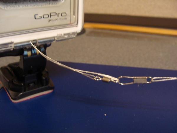

    From reading off the web, the best place GoPro recommends attaching theirs to is the case hinge pin.

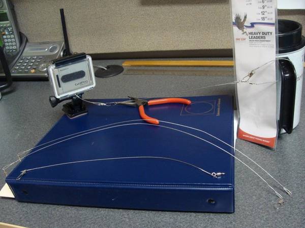

    I fed a 6" leader (took the clip off) & threaded around the hinge pin.
    Reattached the clip making a hoop & attach another longer leader depending on where the fix point on the object is.
    ie. Chin strap, handlebar etc.
    Leaders in the pak were 6,9,12,18"
    I will use another length leader to attach to that fix point.
    I am not sure how many who own the camera already have a tether for theirs
    Post up your ideas, pics if you have one.
    The wire leader does not impede at all with the closing of the case fwiw.
    Its a little extra insurance for hopefully not losing my camera that was a gift.
    Here are my pics~
