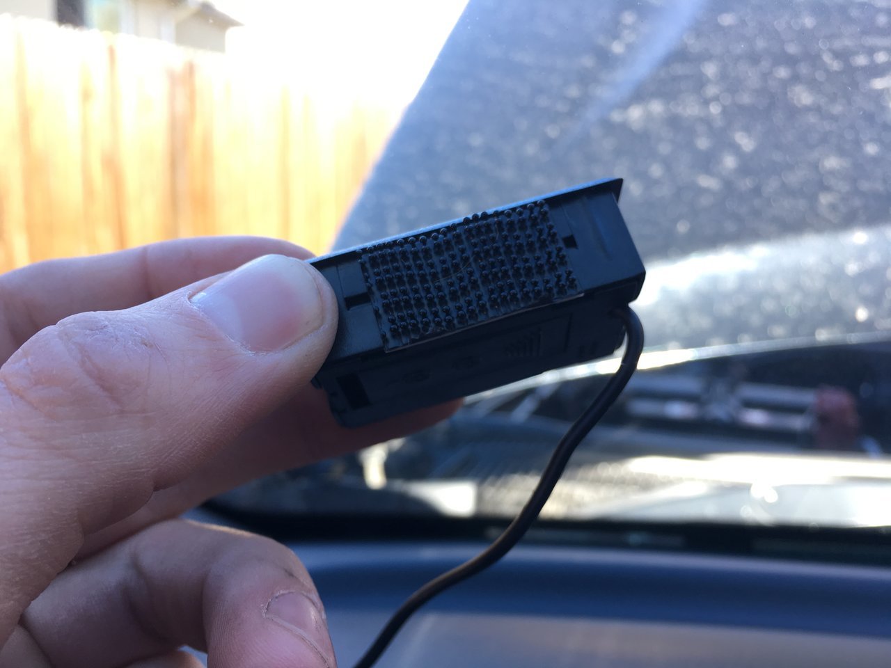

    Having lost an outside temperature reading when I switched from my Jeep to the Tacoma, I decided to figure out how to get this option back. My stock radio can give me weather and temp but only with a HD signal. I also ride with the radio running off with a screen saver mostly. When I’m in the mountains is always nice to know when it hits freezing for driving and camping. When looking for remote temp gauges I came across the one below for about $8. Decided to try and make is as clean as possible on or in the dash. If i couldn’t easily do this I was just going to put it facing through the softopper window in the back. Happy with the results below. Think I’ll keep it.

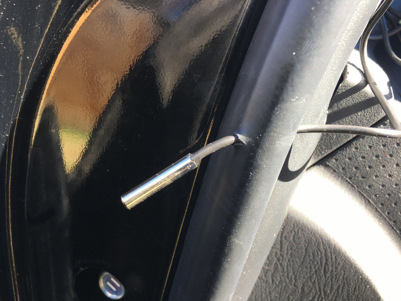

    Fed the cord through an already there hole in the door seal and made a slit on the other side with a blade. Seals it up nicely on the other side.
    Then fed it under the hood and around that bolt to keep it out of the way of the hood hinge. Slid it into the vents. I believe this will be a good spot. The sun doesn’t hit it directly and shouldn’t be affected be engine heat. If it’s not reading accurately, it can be easily moved.

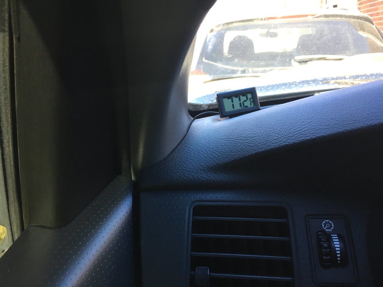

    I added some 3M Dual Lock Velcro and found a nice spot for it. It’s pretty easy hiding the cord just by pushing the oh shit handle panel back. That should do it. Enjoy your new mini display.
