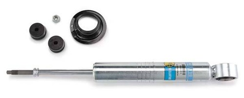

    Just to clear everything up.. I bought this truck because quality is unmatched in a Toyota and I like the way it looks. I am unaware of its superiority in any other aspects nor do I plan to ever test them. I'm gathering from other members here that these are pretty capable offroad but 99% of my driving is interstate. All I want is to improve on the appearance of the truck. I think it looks too low. 4 door is long and makes it seem low I guess. I would also like to put some 285/75/16 Dueler A/T Revos on it. I took the bran new 265 Revos off my previous truck which was totalled and I love the tire but again this larger truck needs larger tire to look appropriate IMO.
    To answer a previous question I am leaning on block and shock for the rear and a strut top spacer for the front. (Assuming I can find or make a bump stop spacer) The AAL kits add load capacity and inherently add stiffness which I don't want. I like the factory ride. Since I have now learned that 3" puts alignment out of correctable range I am leaning on a 2/1 spacer lift. I am hoping that will free up some room for bigger tires and allow me to not replace control arms.. One day if I move to Moab or find a place here to go offroad I may change it up but in the scheme of things what is 150 dollars and a couple hours work. It can be undone just as quickly and replaced with a "Real" lift.

    front spacers if installed with longer bump stops to prevent the shock from bottoming out should work just fine on the street, add an aal to rear, again, longer bump stops, street driving, should be okay...on the rears though, the shocks are stretched, so bottoming out is not really the problem, might pop the shock because it is stretched beyond its limit...thus a longer travel 5125 bilstein would be the prudent move on the rears with the aal....
    best to avoid blocks on the rear, aal is better...
