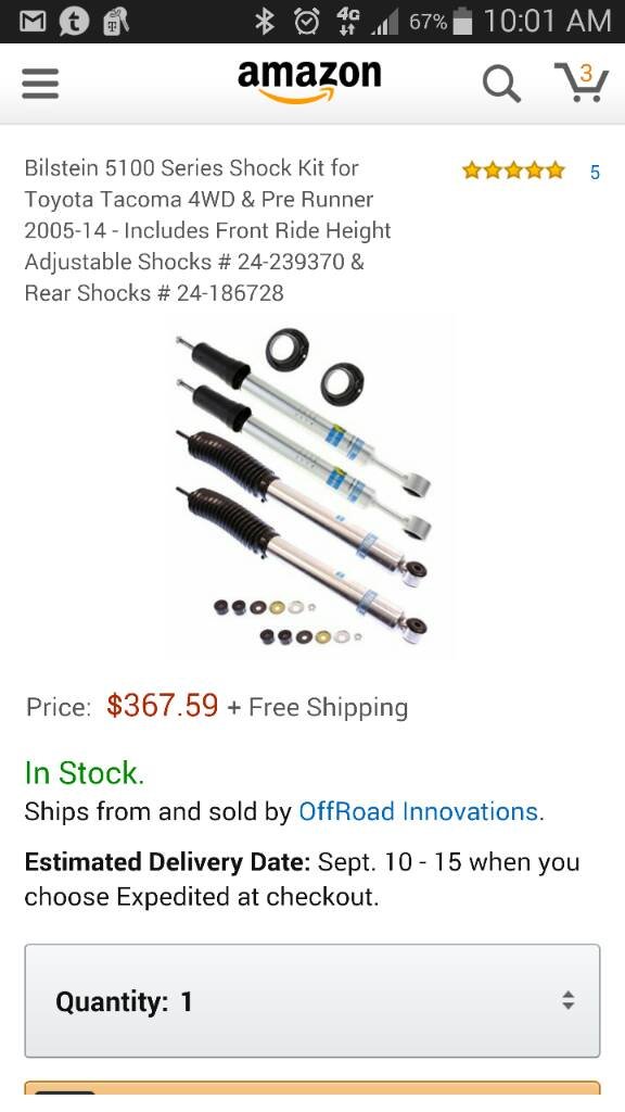

    Link to said kit?

    That is just the shocks which if you use your front stock coils are adustable from 0-.85-1.75-2.5 I believe. The rears will ad nothing unless you lift the rear with an AAL or new leaf pack. Or what some use Blocks

    Are they intended to be used with oe coils? That's pretty cheap but I would still have to figure out bump stops on front and rear shocks regardless of what i chose for lift in the rear right?

    We have the Bilstein 5100 shock kit which includes the 5100 adjustable front struts and the 5100 standard length rears for 315.99 w/ free shipping to the lower 48 States. Here is a link to our shock page.
    Bilstein Shock set: http://www.headstrongoffroad.com/struts-and-coils-tacoma-05-6-lug.html
    We also have a kit which is centered around the 5100's which includes a lean spacer and an aal. I also included the link to that. It is the first one listed for $577.99. If you were looking at the 6112's that is the second kit listed on that page or I included a link to just the 6112s below. Those are only $645.99 w/ free shipping as well.
    Complete 5100 lift kit: http://www.headstrongoffroad.com/headstrong-kits-tacoma-05-6-lug.html
    6112's: http://www.headstrongoffroad.com/coilovers-tacoma-05-6-lug.html
    If you want you can call me and we can go over your options and try to find you something that will fit all of your needs and still be budget friendly!

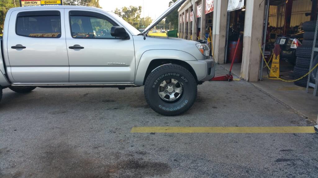

    Thankyou.. as long as it doesn't "ruin" the ride I think it'll be ok. If not I guess I can sell em cheap on the forum. I rolled a 285 out to my truck and it doesn't seem to be a radical change. I guess they'll fit with a small lift. 14b9a0576ccac884f7b3d885ca804d52_c1c5ba5d4367b30192714731d9b1be16adfd6358.jpg
