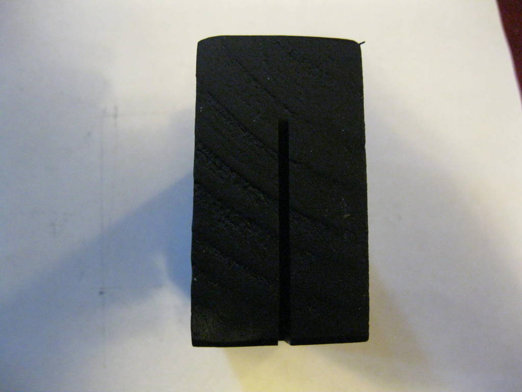

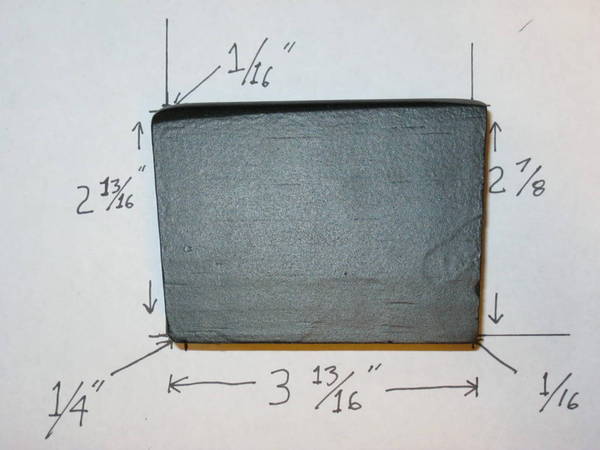

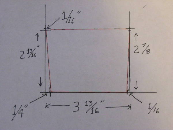

    1.Cut 2x to 3 13/16"w x 2 7/8h
    The tray tapers down
    2.Left side(shift) cut 1/4" miter to the top
    3.Right side(dash)cut 1/16" miter to the top
    4.Top cut 1/16 miter left side(shift)low
    5.Cut blade width slots 1/2" deep to 1 1/4" from bottom

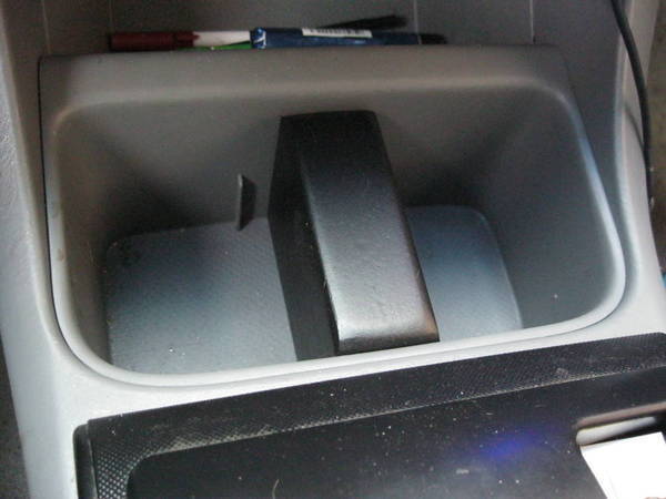

    6.I suggest at this point(if you haven't already)check to see if it fits your tray
    If it's to big-trim some off,If it's too small-send me nasty p.m.s,let everyone know i'm a complete hack,and start over.
    7.Soften top edges with sander/paper to get the profile you desire
    8.Sand all surfaces free of wood grain(it will show through dip after 3 coats)
    9.Dip till your hearts content
    I wasn't able to take pics of the process cause it was trial and error,so i tried to show the finished product against right angles .
    If i was to do it again i would have sanded more on the sides(you dont notice when installed)to get rid of ALL the grain
    I also wouldn't have stuck my finger in the wet dip
    The insert actually works pretty good, my drinks of choice are med. and lg. dunkin donuts coffees and they fit perfect. also 20oz sodas stay up too
