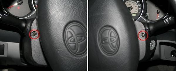

    There are 2 screws to be removed on the front of the steering column. Turn the steering wheel right to remove the left screw. Then left to remove the right screw. I needed the ignition key to turn the wheel far enough.

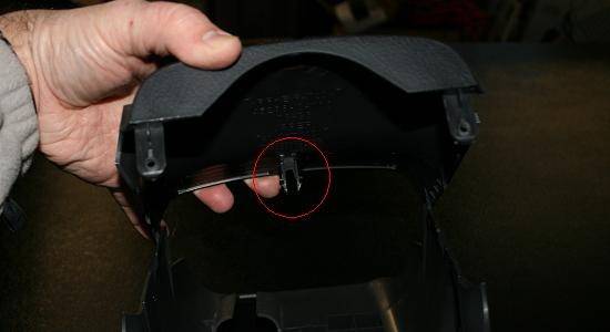

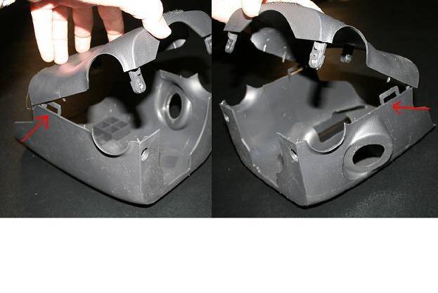

    The steering column cover is now held together by a tab on each side. Press on the bottom half under the tab (see picture for location) and push/pry down. Repeat on the other side. With the tabs free wiggling and prying will now get the bottom piece off.
    Adjust the wheel to it’s lowest position. Near the back of the top half is a double sided tab. With the wheel lowered I was able to reach my hand under there and squeeze both sides of the tab to release it.

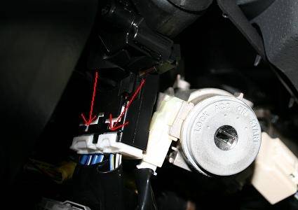

    Unplug the two harnesses from the old wiper switch.

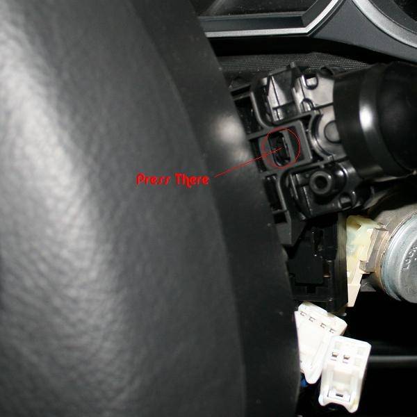

    There is a STRONG tab holding the wiper switch in place. Use the standard head screwdriver to press it. With the tab depressed the wiper switch will slide out to the right with a gentle pull.
    Push the new wiper switch in place (You will hear the tab click home.) and plug the wires in.

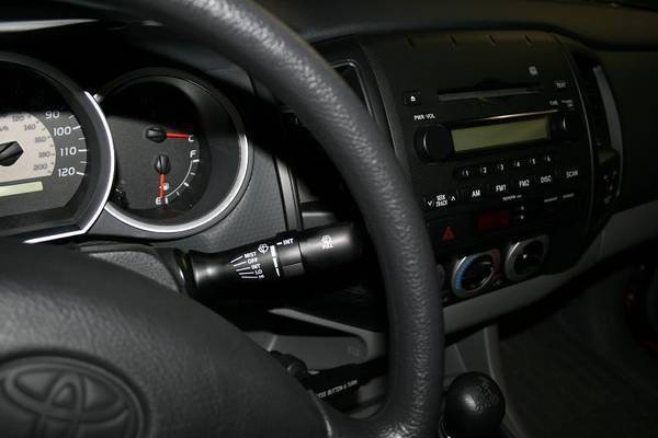

    Here's the finished Mod in all it's OEM glory.
