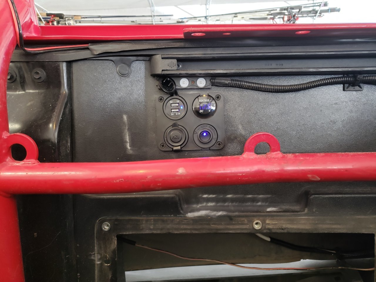

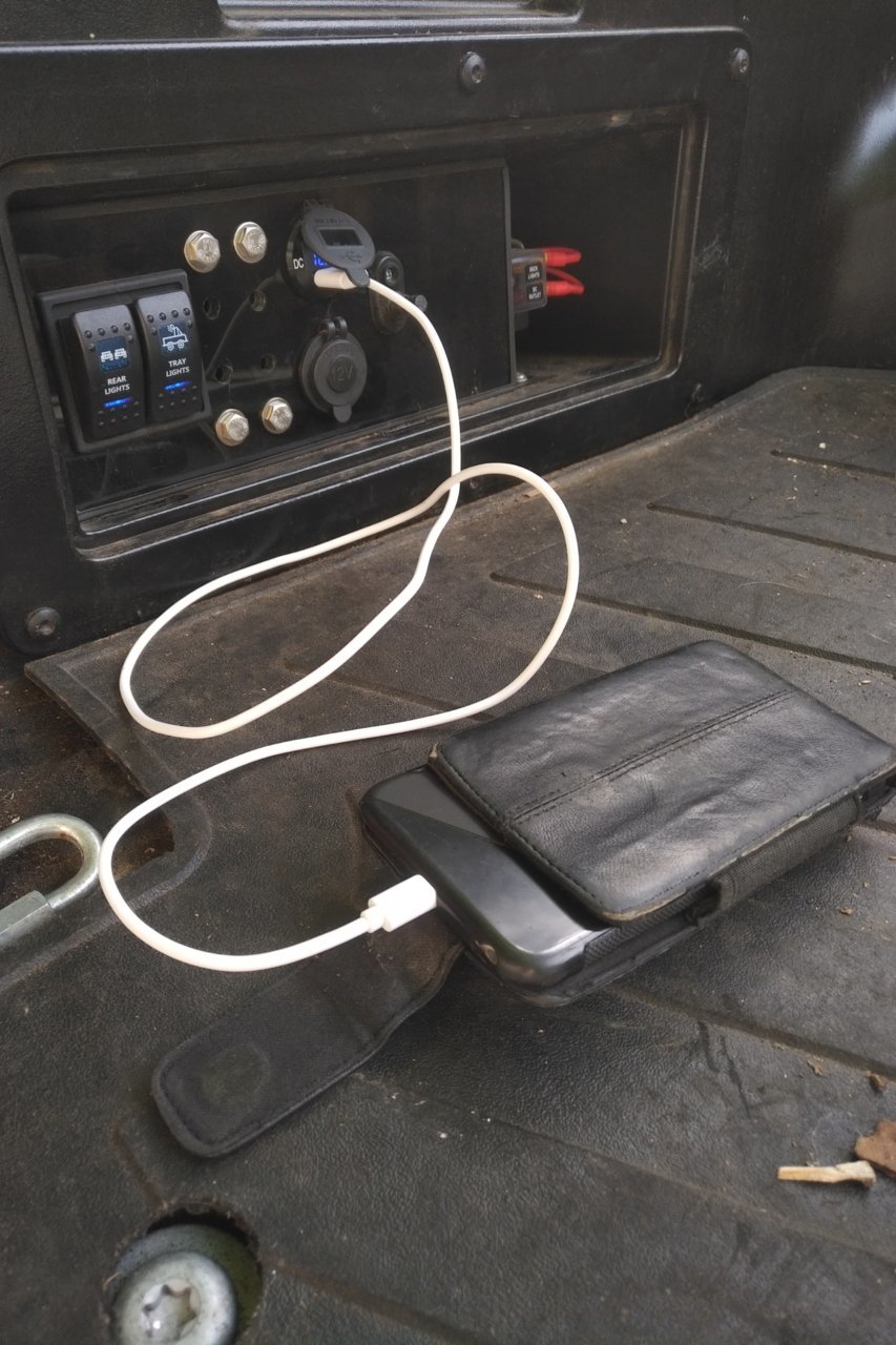

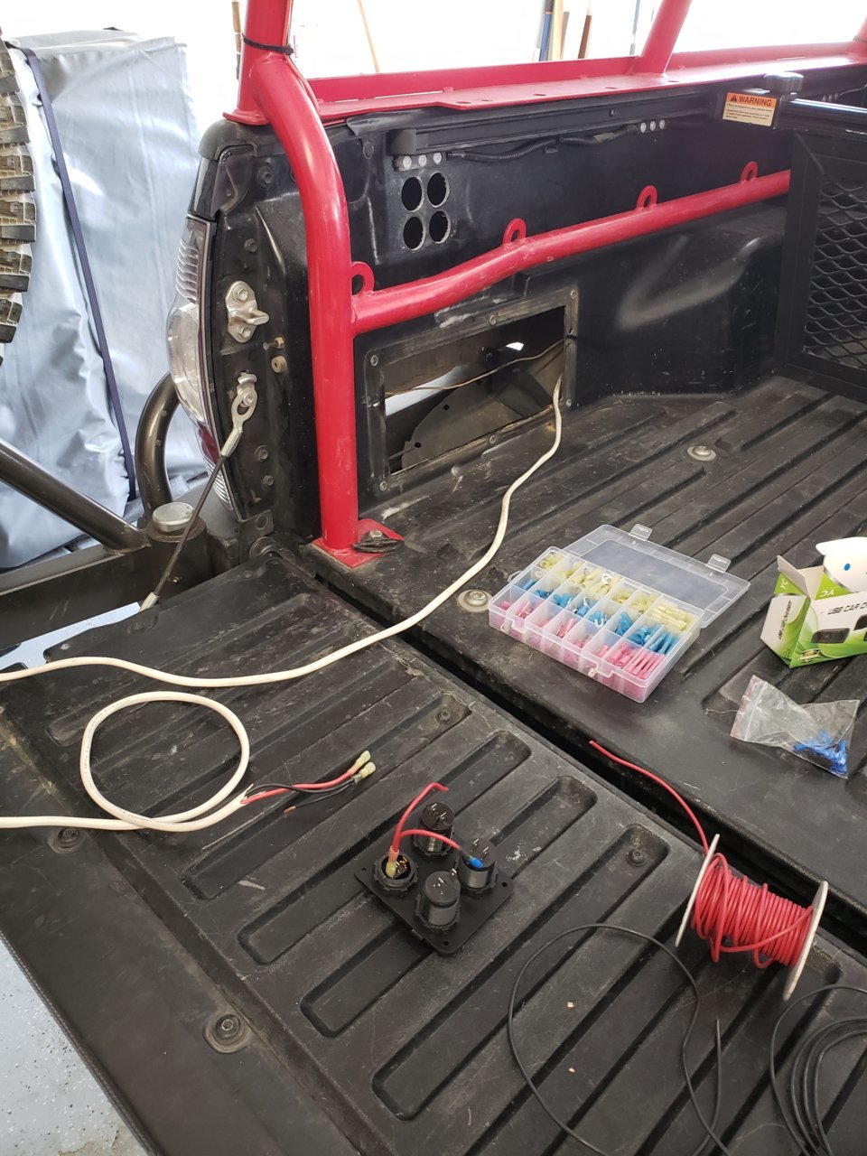

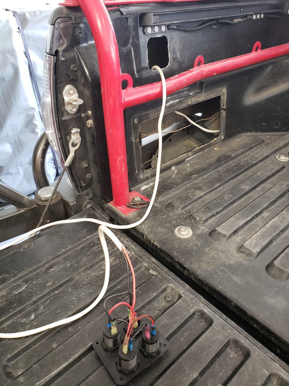

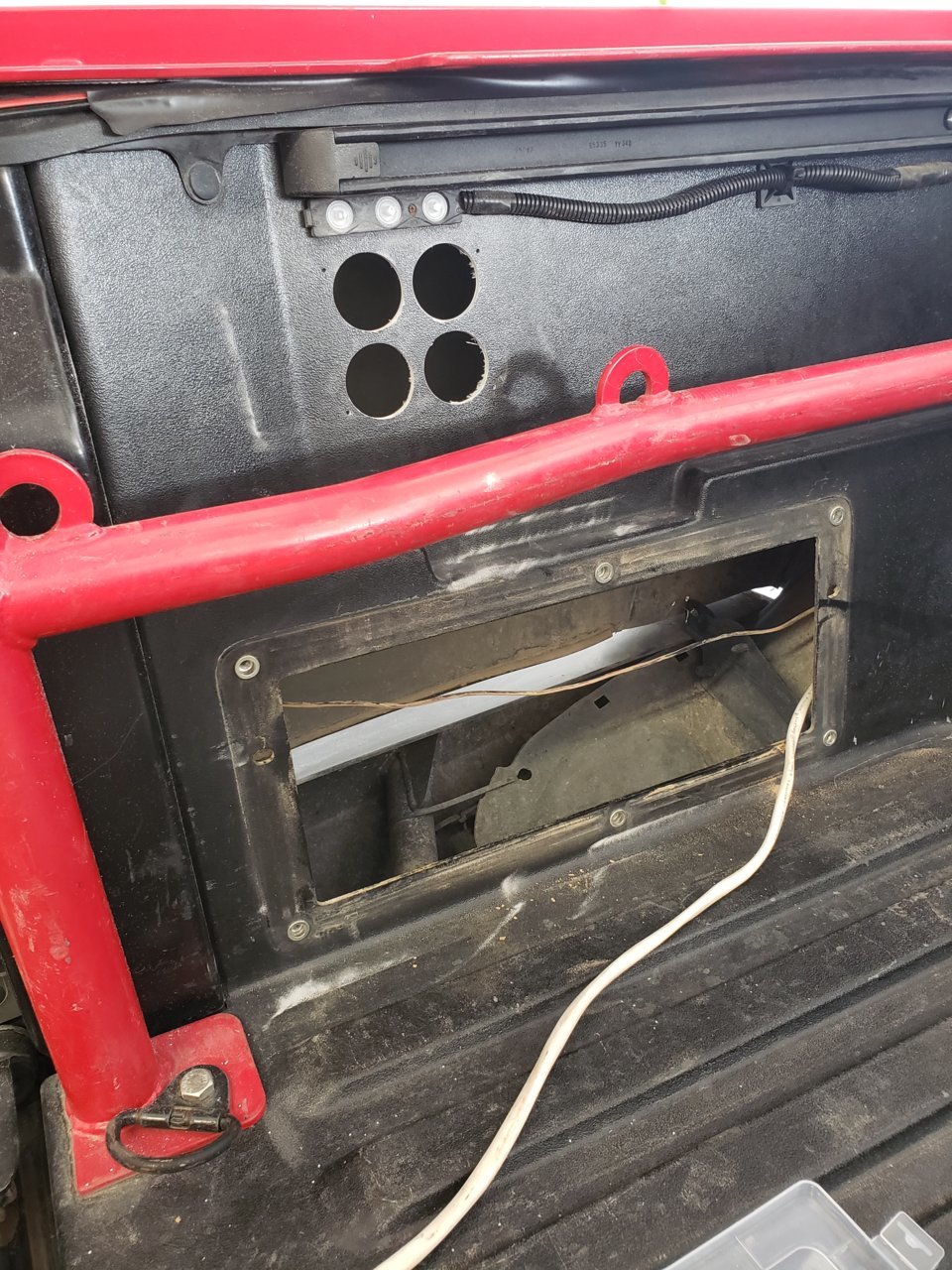

    In bed 12V plug. 12V in bed plug. I did it today . Might help somebody a little bit.

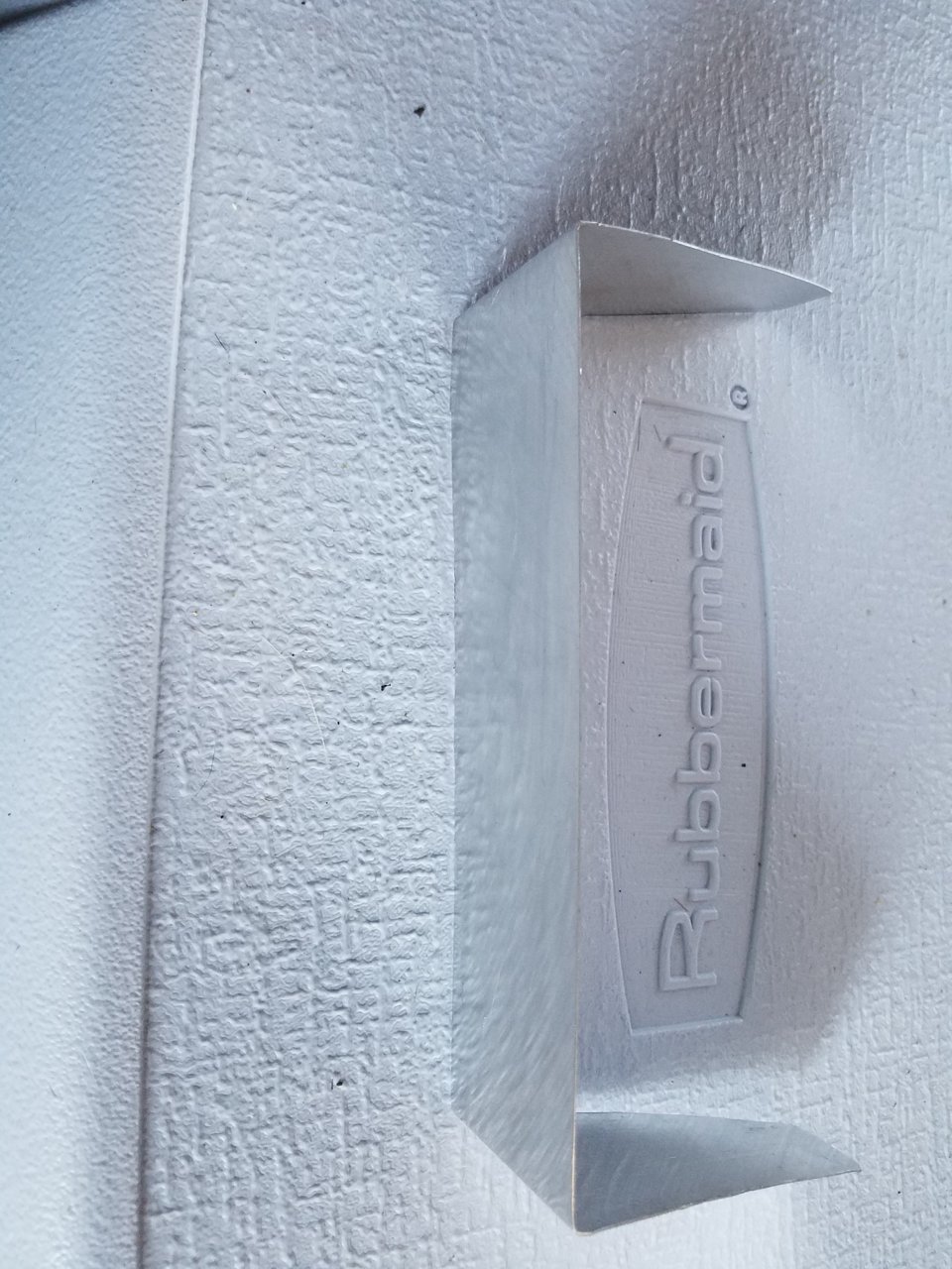

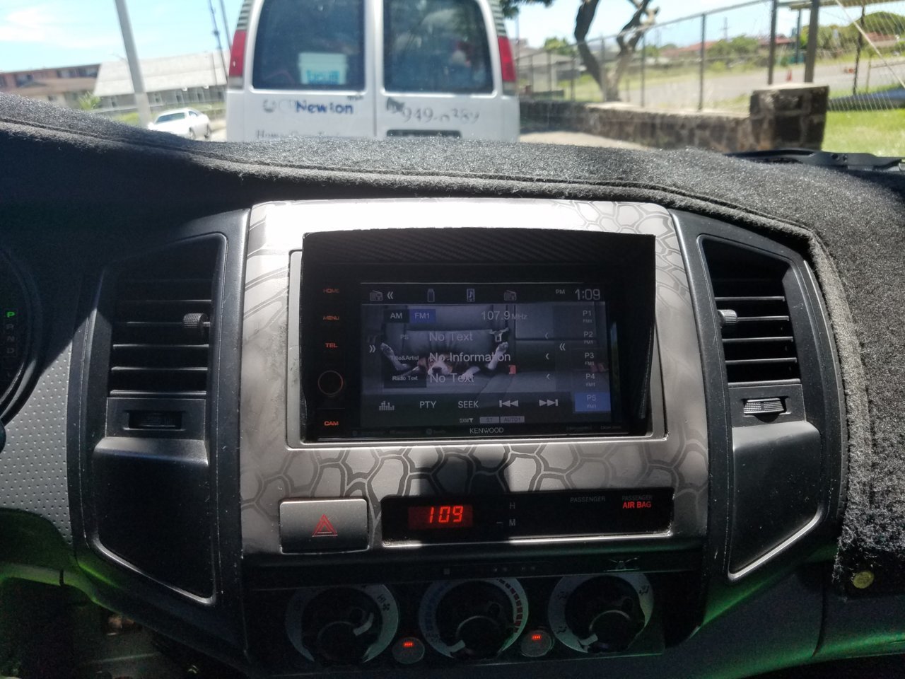

    Sun glare on my stereo was pretty bad with my new kenwood head unit. Seen people asking about solutions and seen 1 member who made a visor out of plastic. Picked up 22 ga. sheet aluminum 6" x 18" from hardware store and made a visor . Works very well and just slips in between head unit and mount . Easy on and off . Just make to size you want .
    Made slightly longer one

    I've been thinking about doing something similar. Excellent work my friend!!

    Is all that inclosed where you ran the wire? I'm gonna be putting in some leds in the bed and I was planning on running my wire where you did. How secure did you do the wire? Is there any openings where a lot of water can get in?

    Got any pics of the full bed cage?

    Where did you get that panel?
